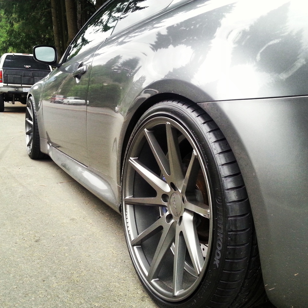

Vossen VFS1 20x10.5 +25, 275/30/20 Hankook V12's. 2010 G37x on eibachs, no rubbing (rear fender liner trimmed)

Old Apr 2, 2015 | 12:17 AM
  #114
Wow Simpson that's a hot looking setup right there, thanks for posting! looks like you're fitting them without running excess camber too, NICE!
too much poke for me
love the 20s on a lowered coupe tho
