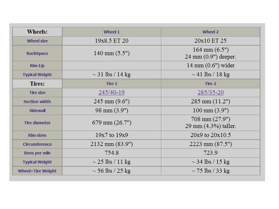

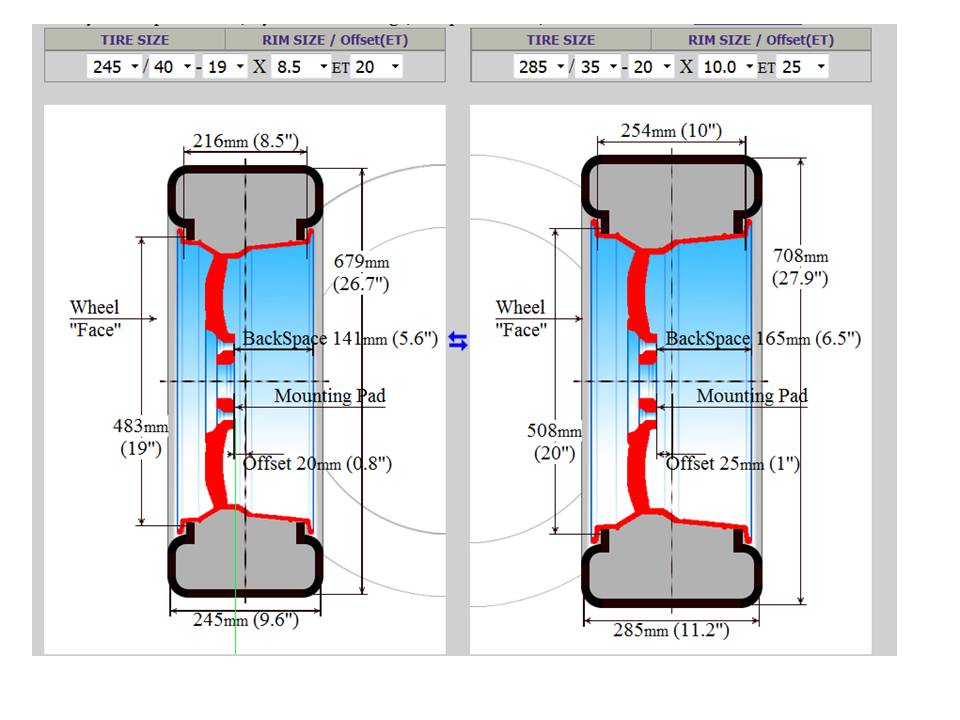

ROHANA RF2 Build SO FAR
I’m looking for my tire wheel package. Driving a 2008 Coupe, Journey. Currently on stock suspension and replacing with the Koni strut and Eibach spring. I’m considering something a little different, a double staggered set-up and am doubling checking the idea.
FRONT: 19X8.5 +20 on a 245/40/19. Only other offset available is +35.
REAR: 20X10 +25 on a 275/30/20 or 285/35 /20
Ideally, I want the flush look. Maybe more importantly, I need the tire sidewalls to match or for the rear sidewall to be slightly thicker/higher. Here are two screen shots comparing the two wheels. I’m working with Jason at GetYourWheels. Any and all advice is appreciated.
Dan
Dan
Here's one square setup but mainly want you to see the back, it's a 10.5 +25 running 255s
https://www.myg37.com/forums/brakes-...ml#post3877365
And here's 10.5 +25 on 275s
https://www.myg37.com/forums/brakes-...ml#post3891573
You could split the difference and run 265/35
If you want the similar fit in front a 235/40 would be what I'd run
