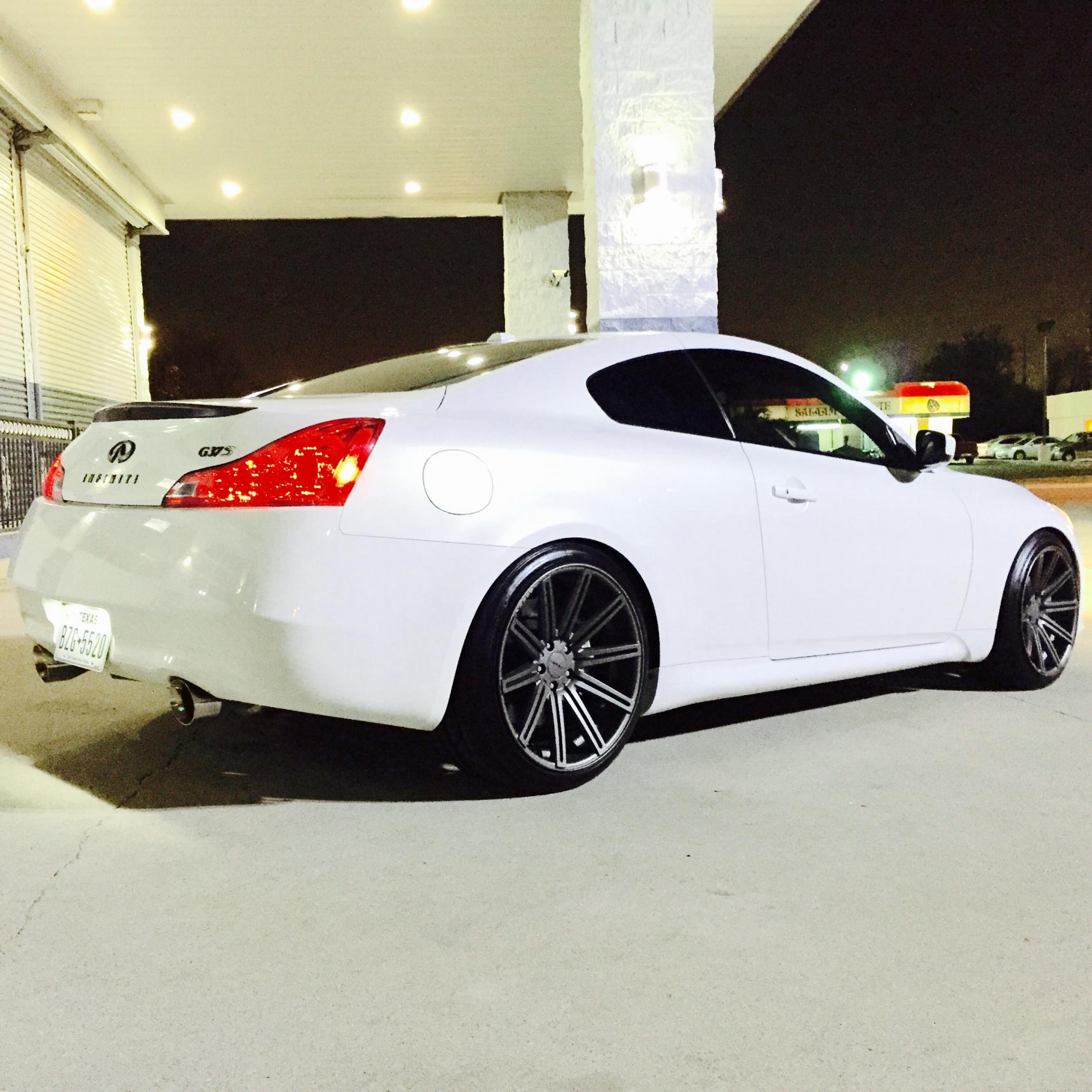

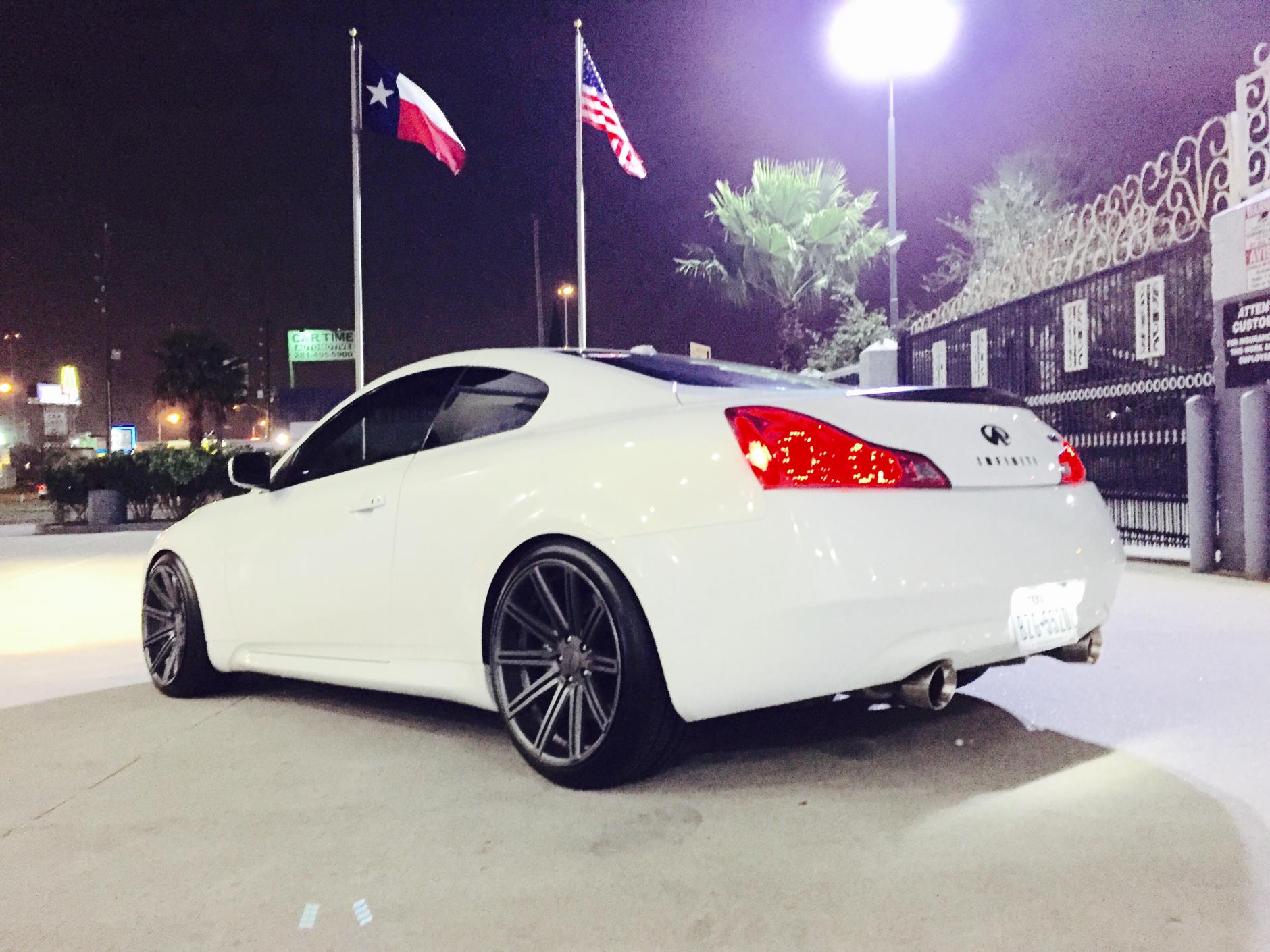

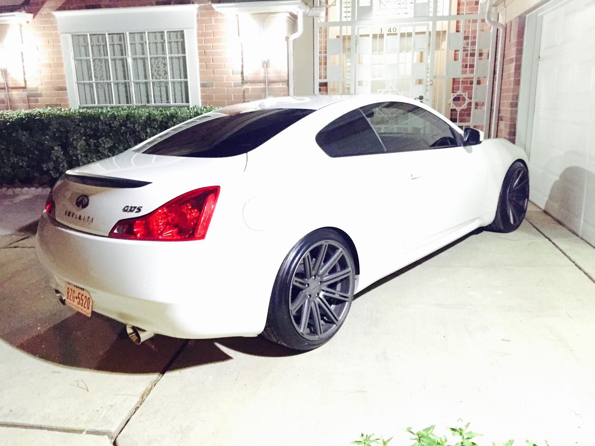

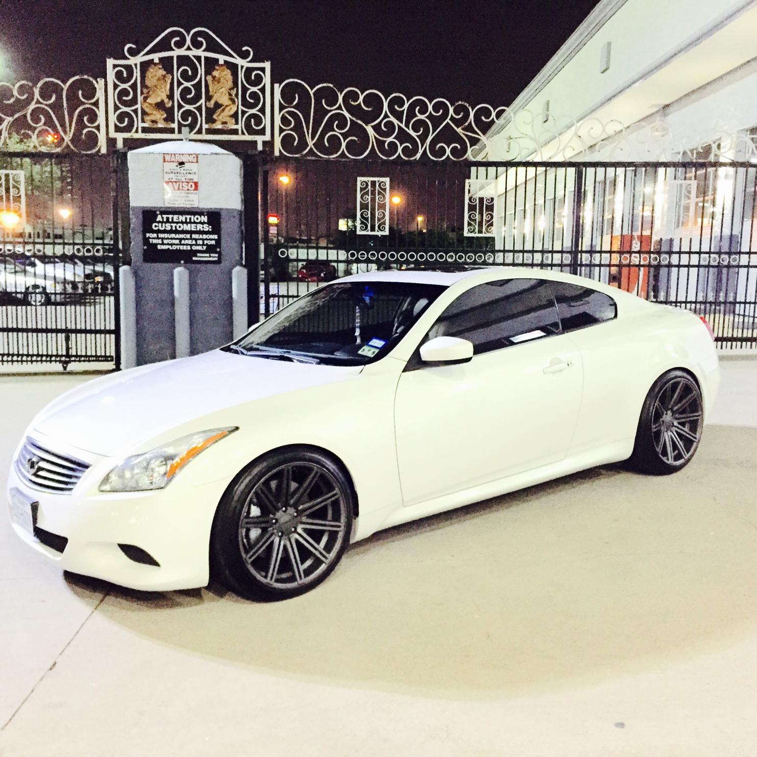

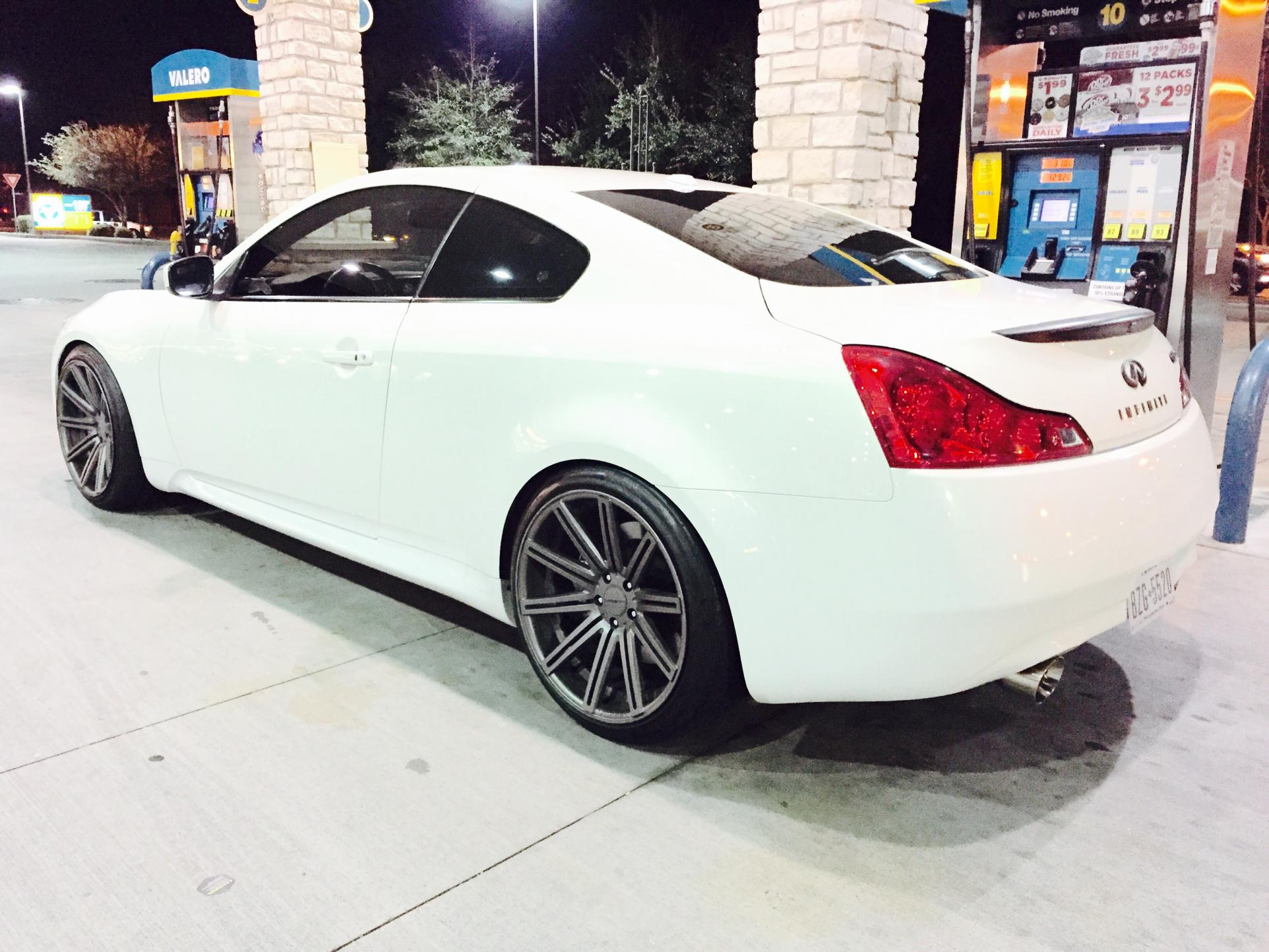

Old Feb 20, 2015 | 02:01 AM
  #79
misaw's Avatar
misaw
Joined: Dec 2014
Posts: 24
From: Houston, TX
2009 G37s Coupe RWD
-Vossen CV4 20x10.5 +25 all around
-Nitto Invos 255/35/20
-Lowered on Swift Sport Springs
Attached Thumbnails HELP~All squared setups please post here!-fullsizerender_1.jpg   HELP~All squared setups please post here!-fullsizerender_2.jpg   HELP~All squared setups please post here!-fullsizerender_3.jpg   HELP~All squared setups please post here!-fullsizerender_4.jpg   HELP~All squared setups please post here!-fullsizerender.jpg
Old Feb 20, 2015 | 02:01 PM
  #80
Nice setup, Misaw! Thanks for posting.
