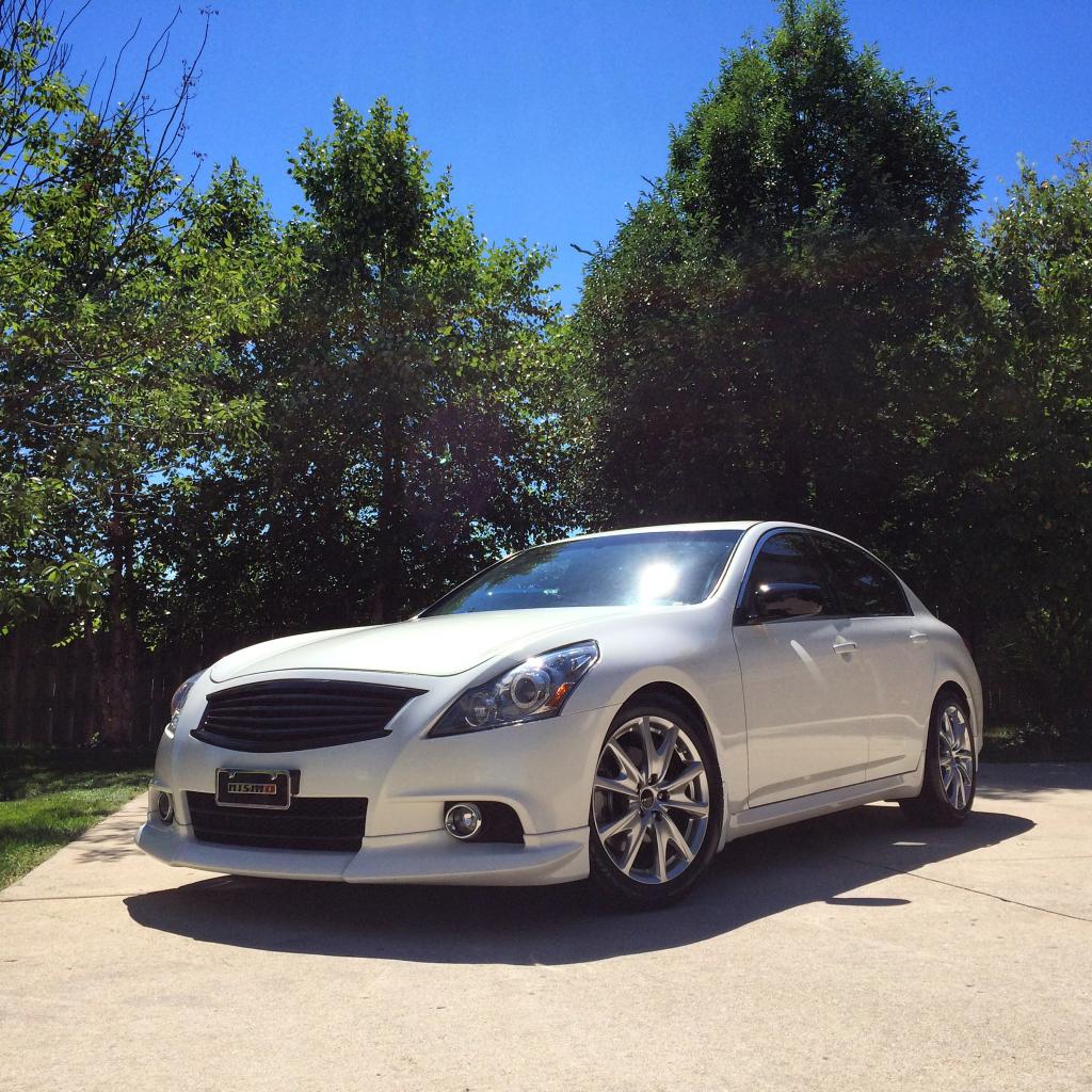

Really like'n the idea of going with the 370Z wheels on my "370GT"....the
19x9 +47/ 19x10 +30 ....just wondering for my G37xS what would be an ideal set-up/tire size to run on? and not mess up the AWD system?
I currently have the 18' sports with H&R 20mm/25mm spacers and just went with the Swift springs....Thanks guys for the info!!!

G looks nice w/ your new drop. As far as the Z wheels, they'll fit but will poke in back a bit w/ your mild drop, also having to run stretched in the back will make the actual running diameter harder to predict. You really need almost zero variance from OEM diamters front to back w/ an AWD so I wouldn't recommend going w/ that setup.
So If I did want to run this set-up what tires/sizes would I be able to run on my G37xS or it's completely out of the question to run these on an AWD
and if so... I'm better off looking at a 19x8.5 set with like 245/40/19's

The main obstacle is the stretched rear tire, having the tire stretched will change the diameter compared to a standard mount and determining the adjusted diameter is hard to do without actually buying the tires and
running them. A variance over 1% from your front tires will most likely cause issues w/ your AWD system. Running a square setup is easier, and you can see a few setups over in this thread that are still quite aggressive
