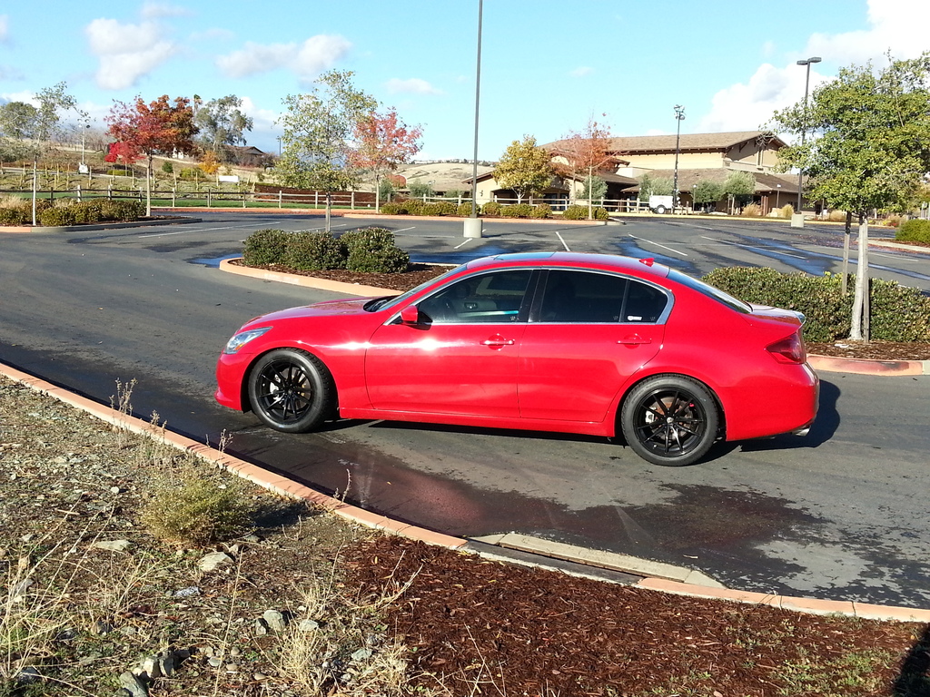

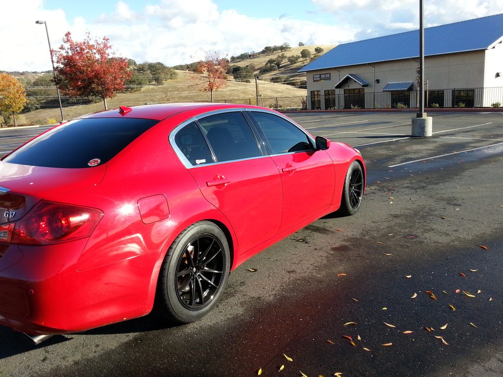

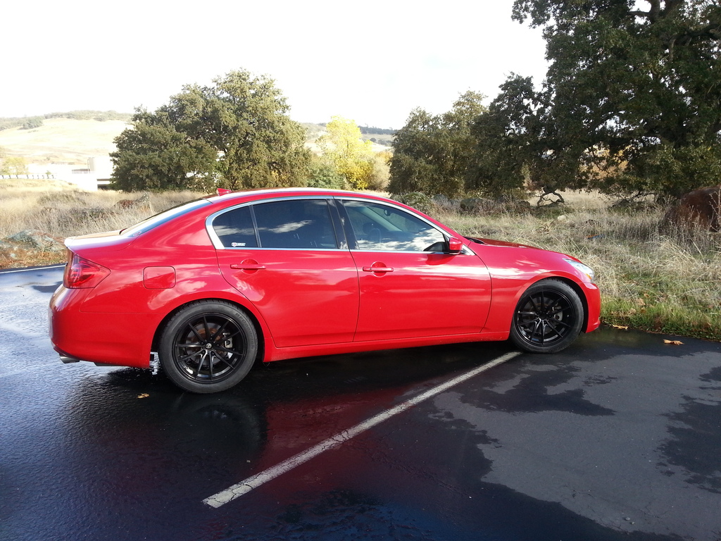

Have the new wheels and tires installed today
Hi All,
I received the wheels and tires at the first of the month, but haven't had time to install them till Monday.
These are the first pictures with the new wheels and tires.
Just to refresh the thread I chose:
Konig Oversteer 18x9 +35 wheels -- square
255/45ZR-18 BFGOODRICH G-FORCE SPORT COMP-2
They have all but 50 miles on them and it was raining pretty good today with 45F temperatures.
Here are some pics for the gang. I had some time to kill when the storm cleared.
FYI my setup is swift springs, Koni Yellows, and Hotchkiss sways.
They fit perfect! Thanks Newt

Those Konigs really look good, nice choice and the fit is
Those tires should get even better after they get scrubbed in a bit, couple hundred miles and they should be glue. What happened to the center caps??
Yeah I am waiting for the black vinyl to arrive so that I can black out the Konig emblem in the center caps. I will use your DIY for blacking out the stainless window trim and trunk stainless.
