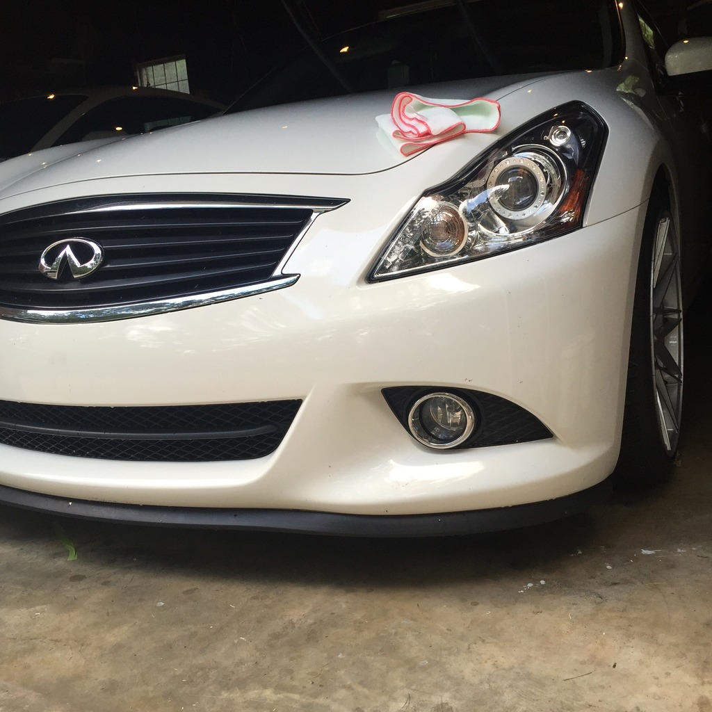

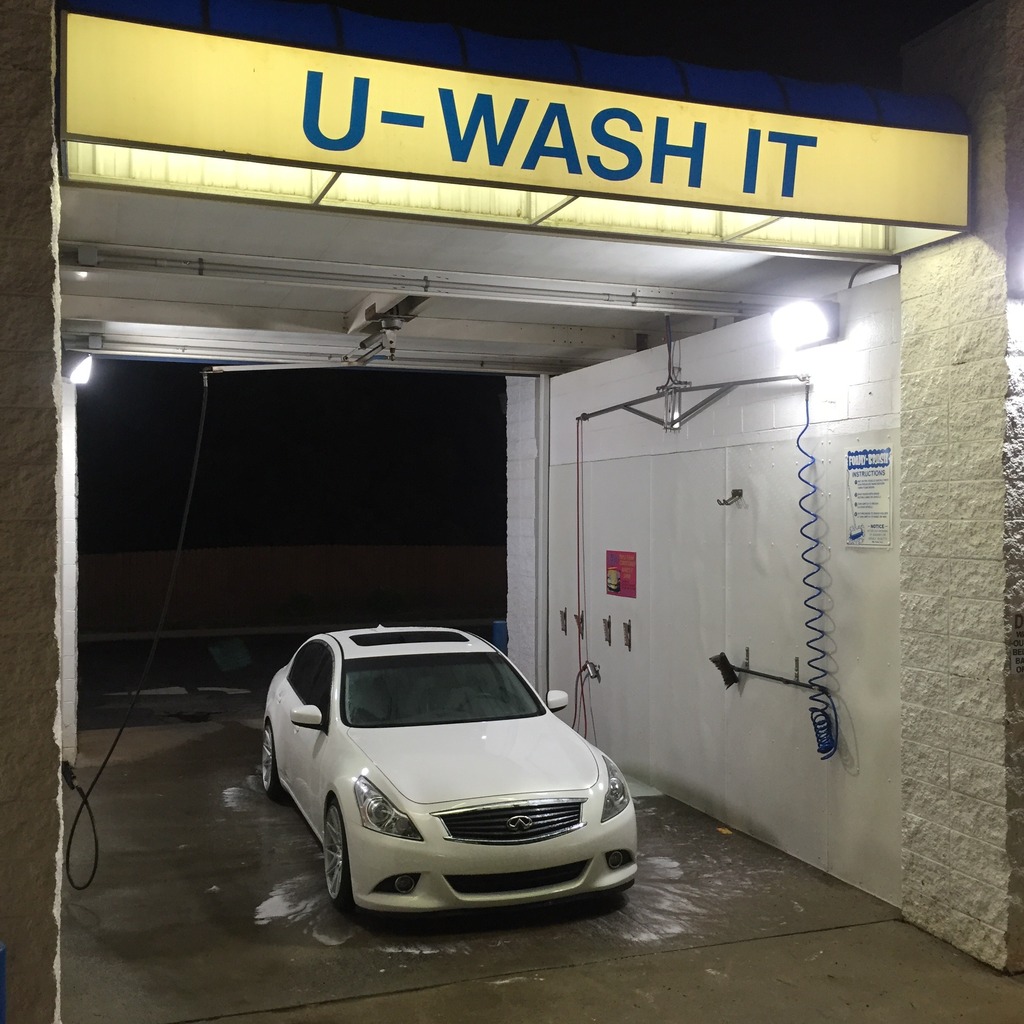

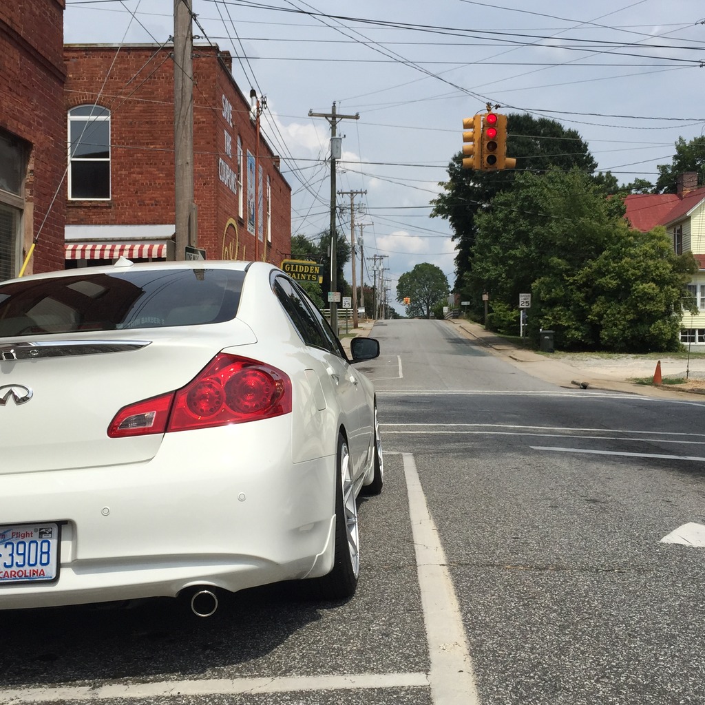

I would go with a plus 32. This is a 19x10 +40 rear and 19x10 +45 front. I need to get some spacers for the front. I'm on eibachs all around 255/35 and j don't have any issues. I know you're going for 20s but still a good reference for the offset and width.
