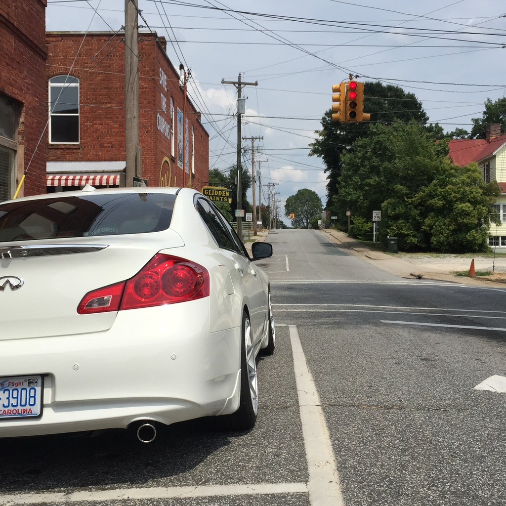

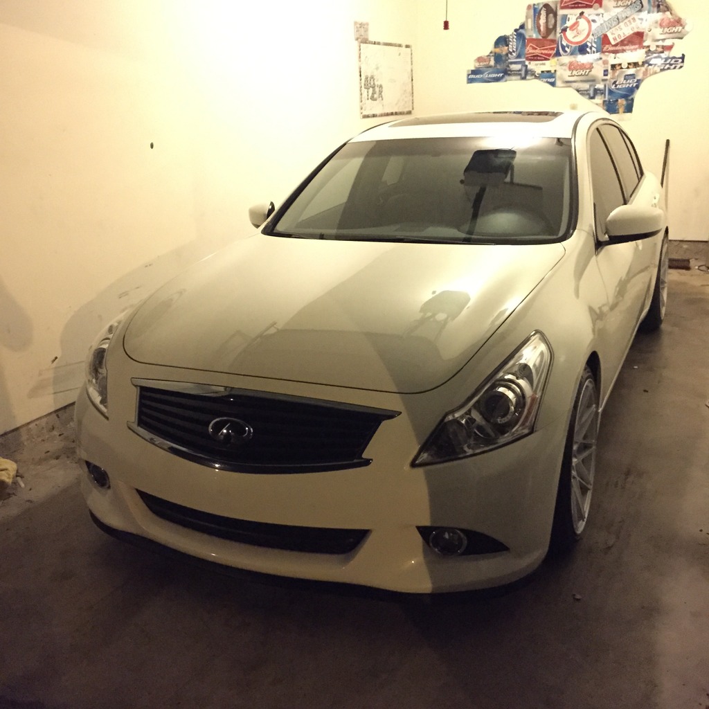

Originally Posted by r0cketm0nkey
Anyone tried running the 370z Nismo wheels? I believe they were 19x9.5 +40 and 19x10.5 +23. Would like to run 255/40/19 and 285/35/19 for keeping the speedo correct. Will not run negative camber even if it kills me.
You're not going to fit a 10.5 in wide with a 23 offset without running some rear camber. I'm running a 10 inch wide with with a +40 offset and this is where it sits. So you're going to stick out about 3/4 of an inch more. But it's definitely possible, just not with factory camber specs and 285s!
Thanks for the pics...does it change anything if mine is the coupe? I'm not familiar with whether the specs of the coupe/sedan are different. If it's the same then I'll just consider my dreams mercilessly crushed.
Coupe has more room at the rear fender but 285s will be pushing it. As long as your coupe isn't AWD you can run as narrow as a 255/40/19 in back and those should be OK at the fender although the wheels will be poking outside the fender edge when looking straight down.
