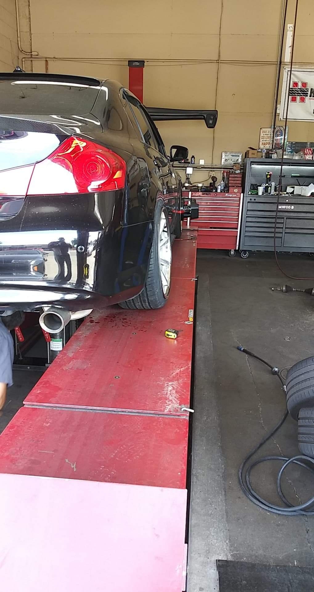

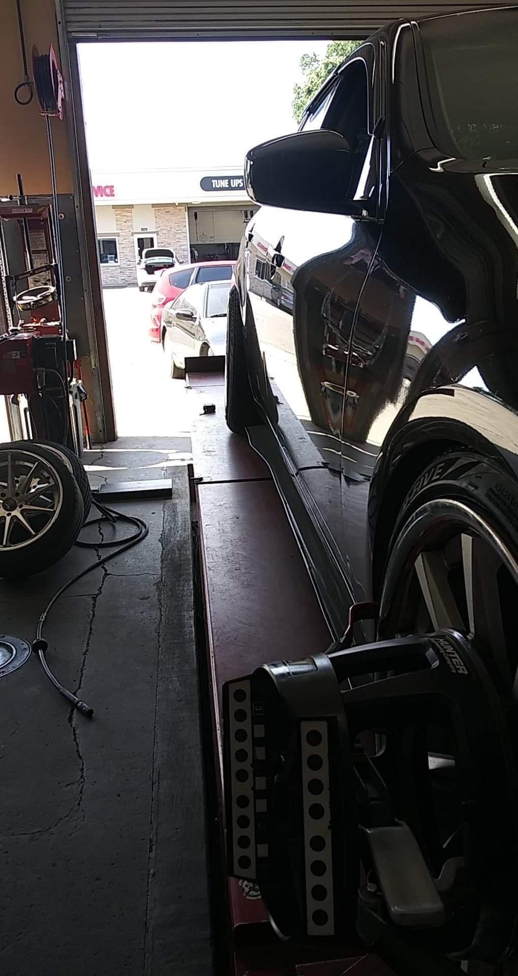

Tried to fit my wheels on last weekend and I just couldn't, idk if it's the 255/35 or maybe a 10.5 won't fit 😞

Looks like they're barely inside the fenders or are the pics not very accurate? I knew it was going to be a tough fit but what camber are you running?
Yeah man barely inside,wheel wouldn't even turn because it was sitting on the fender, went all the way negative,lifted up the coils but nada..I like how the 10.5 looks but I might have to get one with a higher offset or or just go 10 in the rear, bit these came off a coupe so I'm like what the hell lol
