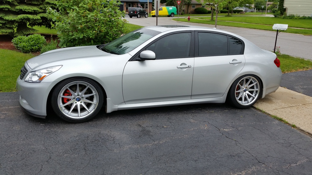

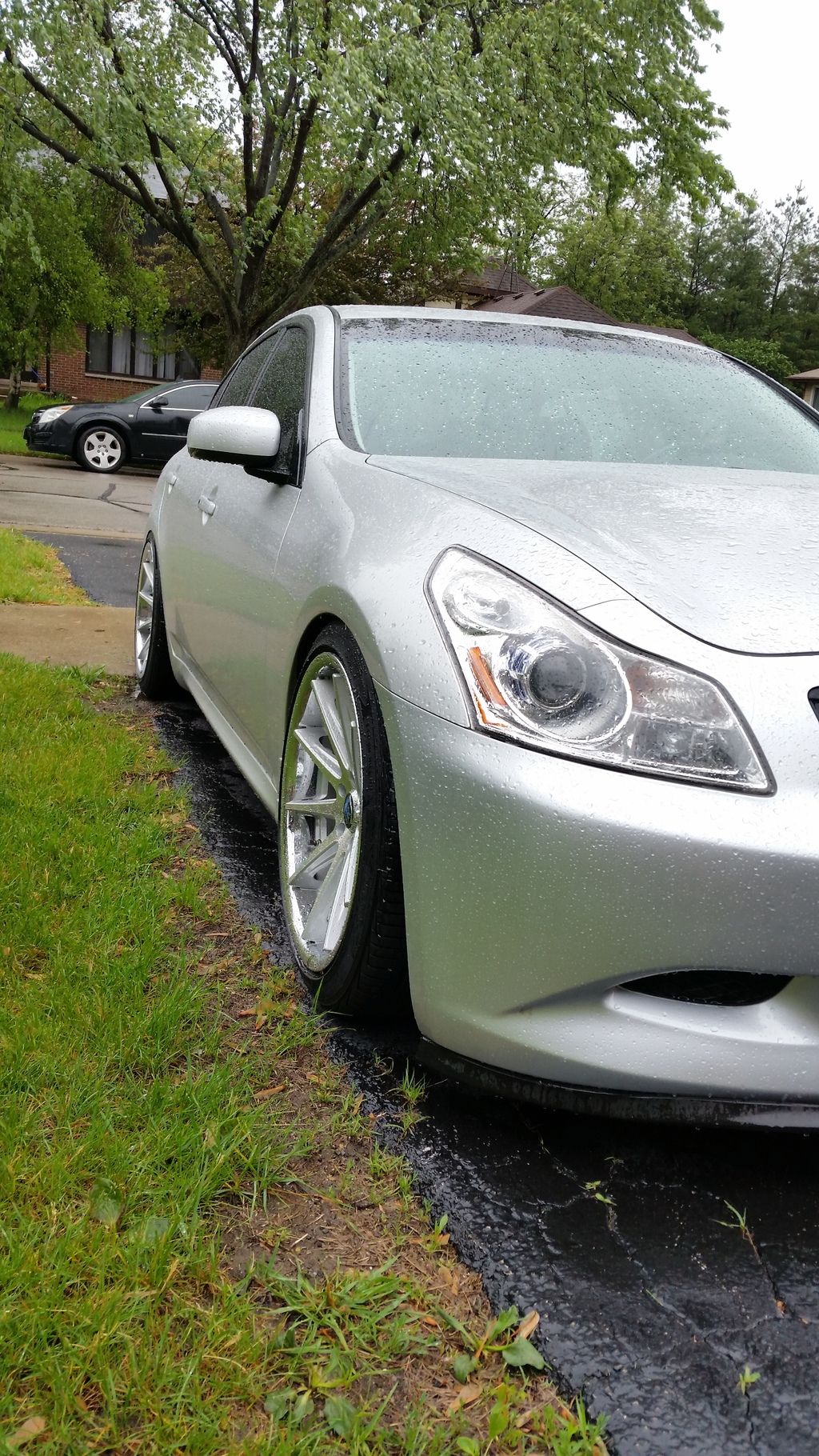

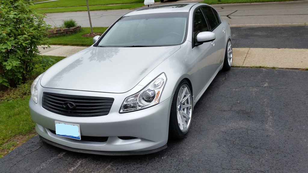

Here is my setup: 19x9.5 +20 all around
Old May 31, 2015 | 12:16 PM
  #133
Very nice choice on those Rohanas VQ, look really classy on your G. Nice aggressive fit too
Looks like the back needs to come up a bit (or the front dropped another 1/2"). What are you dropped on?
Old May 31, 2015 | 02:26 PM
  #134
VQCrew's Avatar
VQCrew
Joined: Nov 2014
Posts: 144
From: Chicago
Thanks, it was a long and hard decision but I'm very happy with these RC10s. All the people at discount tire that day I had them fitted were all giving me compliments . The bad thing is I'm rubbing on the rear tires and have trimmed the fender liner. And yes I know the drop is a bit uneven, I raised the rear a bit and I am about to take a test drive. Hopefully no more rub Also, I am on BC coils.
Old May 31, 2015 | 03:34 PM
  #135
Yeah, you'll be fine raising the back just a bit, have you had it aligned?
BTW, what are your tire specs?
