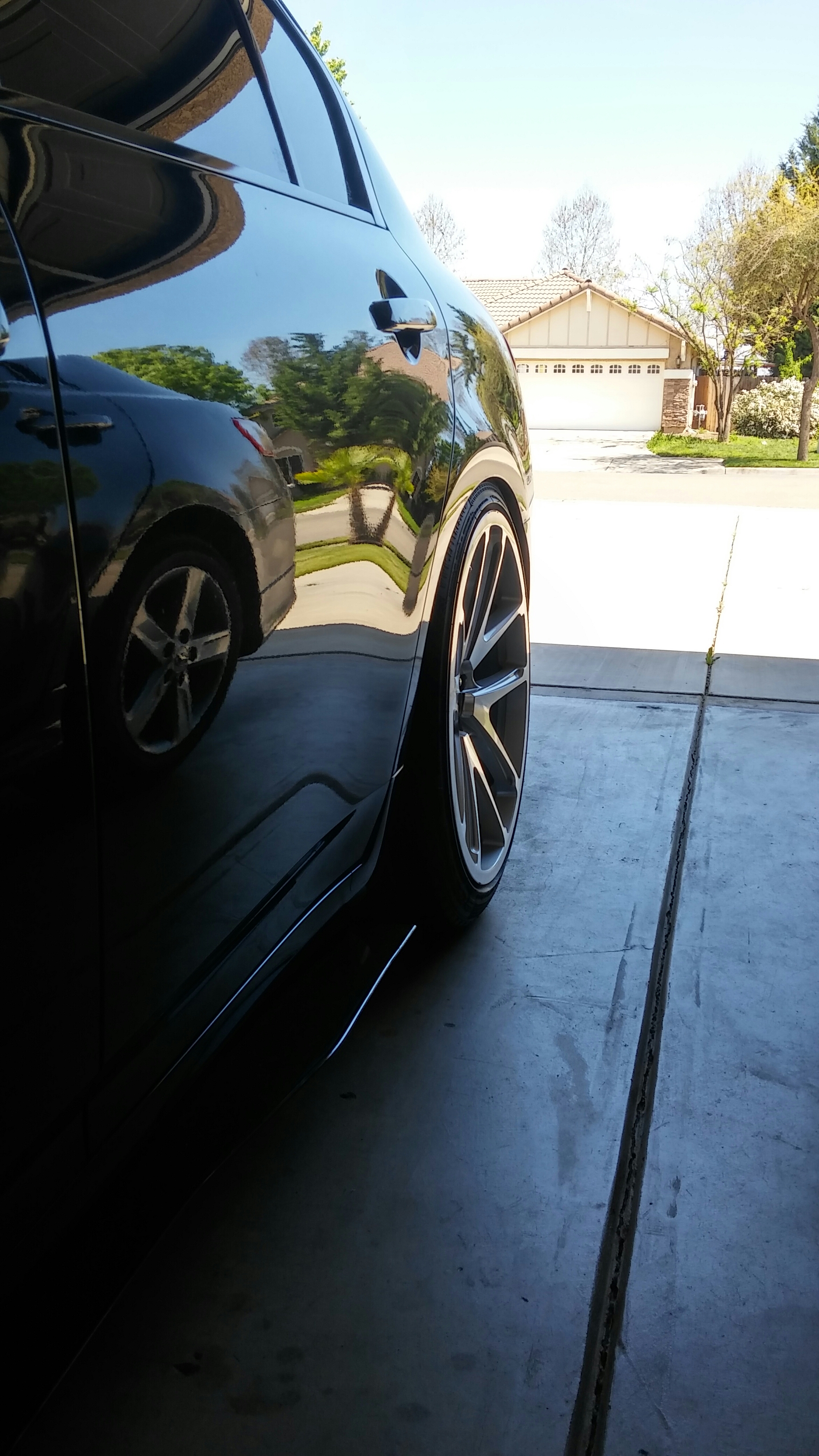

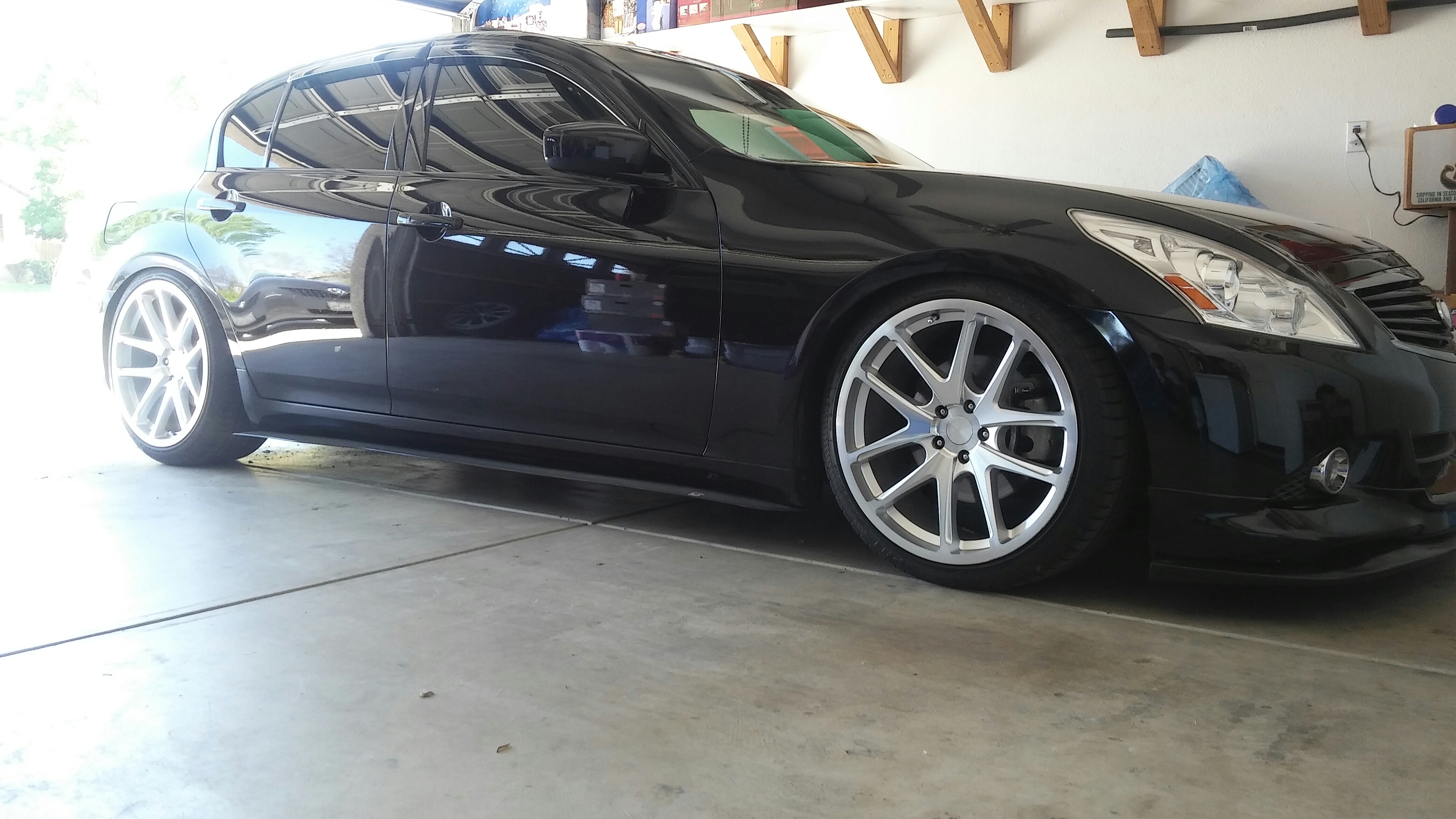

Ended up putting the wheels on 20x9 20x10 +35..275/35 in the rear was rubbing but trimmed the liner and im good..alignment soon to come

Looks like a nice flush fit at the fender, same as my 295s on 10+45. What are you dropped on, looks like you're about 25.75" to the fender arcs, be careful that low
Im on tein basis coils..from ground up im 26" all around..i was debating on raising the front to put spacers..if i run into issues then i will raise up
