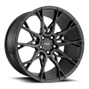

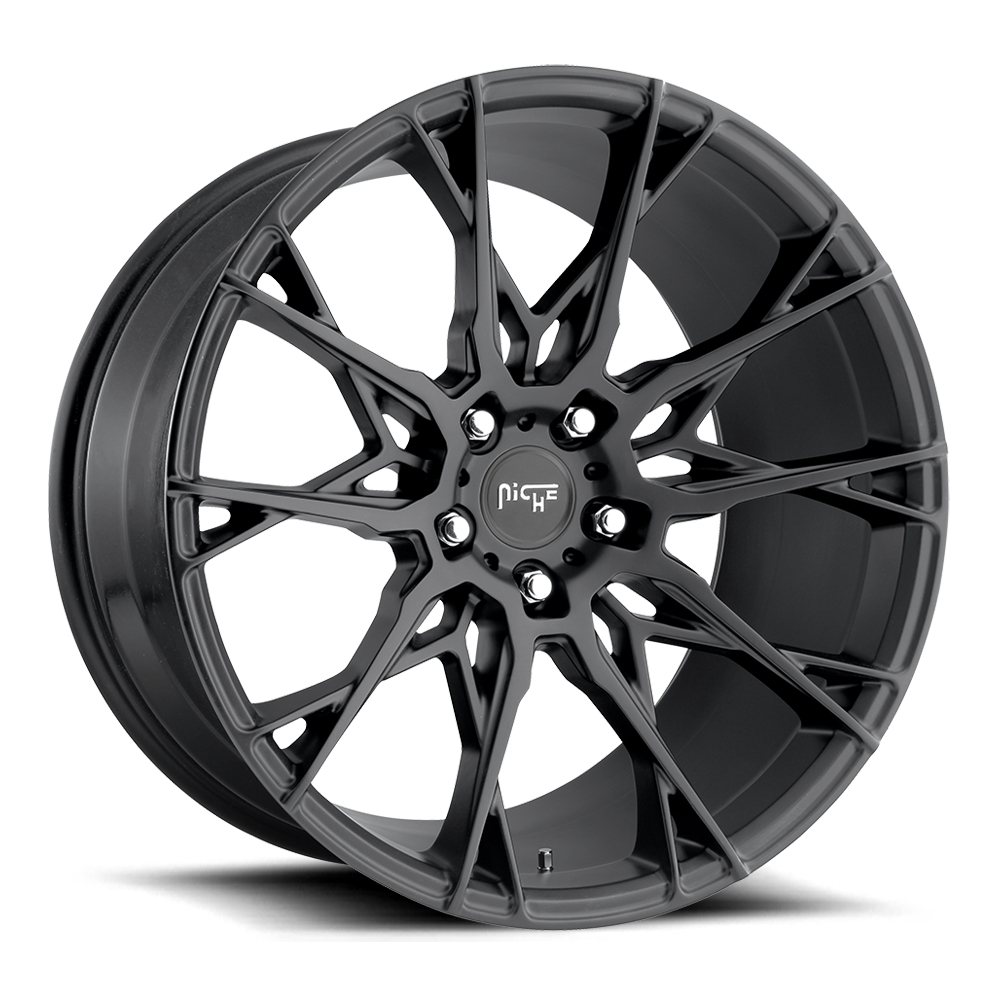

From: Stankonia
This looks like the best place to post my question. My girlfriend is looking to change the wheels on her car, but she doesn't want an overly aggressive setup. She's wants to have a flushed look with the new wheels & tire combo. She drives a 2011 G37S coupe & she is looking to purchase a set of Niche Staccato wheels in either 20x9 +35 or 20x10 +40. She's going with a square setup and wants more width without having any poke. As previously stated, she wants the wheels & tires to be flush. Any suggestions &/or recommendations for wheel and tire sizes?
This post got skipped over, my bad
Those offsets are conservative for a coupe, and having an S model you'll need to confirm brake clearance with the vendor. Since those are the only width/offsets available you could run the 20x10 +40 all around on 275/35/20 tires but will probably need a spacer to clear the brakes and possibly clear the steering knuckle on the inside.
Are those the only wheels she likes?
