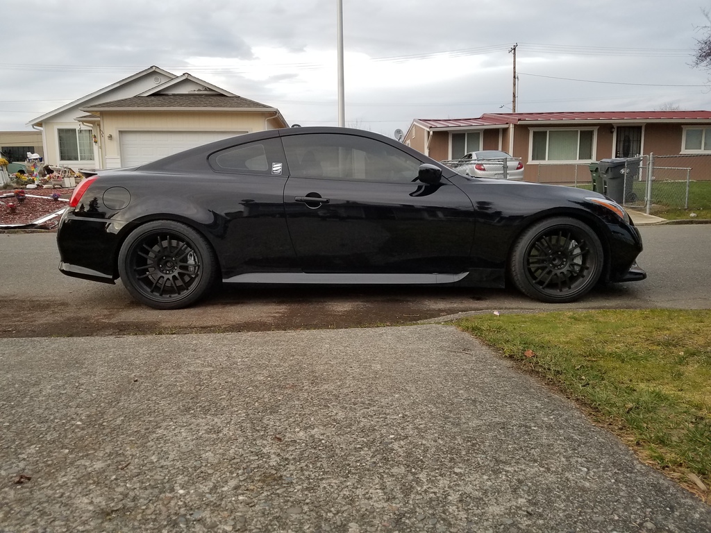

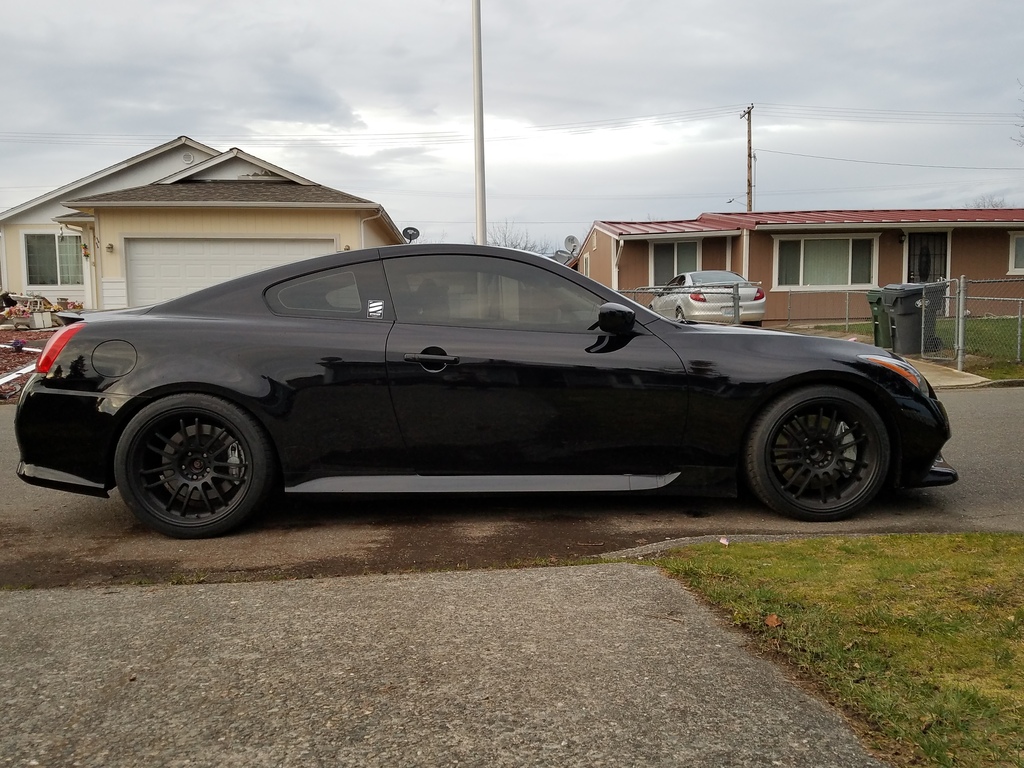

Nice set up NappyG, that front looks more like a 9 +35 to +40. A 9 +17 should be well past the fender edge. Maybe the pic is misleading???
Old Mar 10, 2017 | 02:10 PM
  #1187
Nappy_G's Avatar
Nappy_G
Joined: Apr 2015
Posts: 23
Nice set up NappyG, that front looks more like a 9 +35 to +40. A 9 +17 would be well past the fender edge.
ill have to take off a wheel and check again Myb I read the number wrong or the guy I bought them from lied..
none the the less I love this fitment and the ride quality much better
Old Mar 10, 2017 | 02:17 PM
  #1188
Likes: 4,952
Agree, that's a nice fit, just seems like that front spec might be off. Kudos for the wheel choice too, looks good on that dark G.
Old Mar 10, 2017 | 03:40 PM
  #1189
Nappy_G's Avatar
Nappy_G
Joined: Apr 2015
Posts: 23
thanks man . I'll take some better pictures later and post the right offset for the front wheel ...

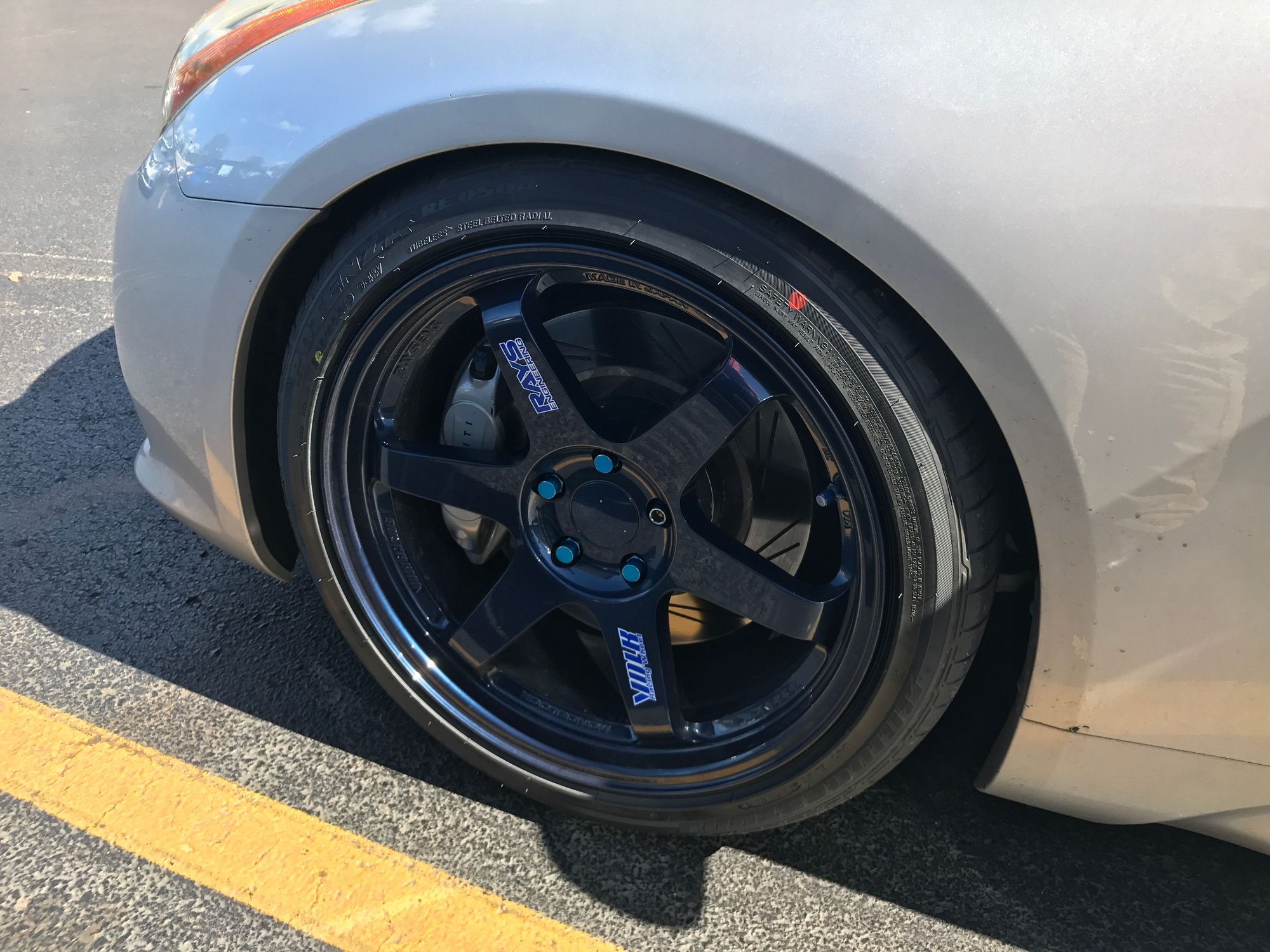

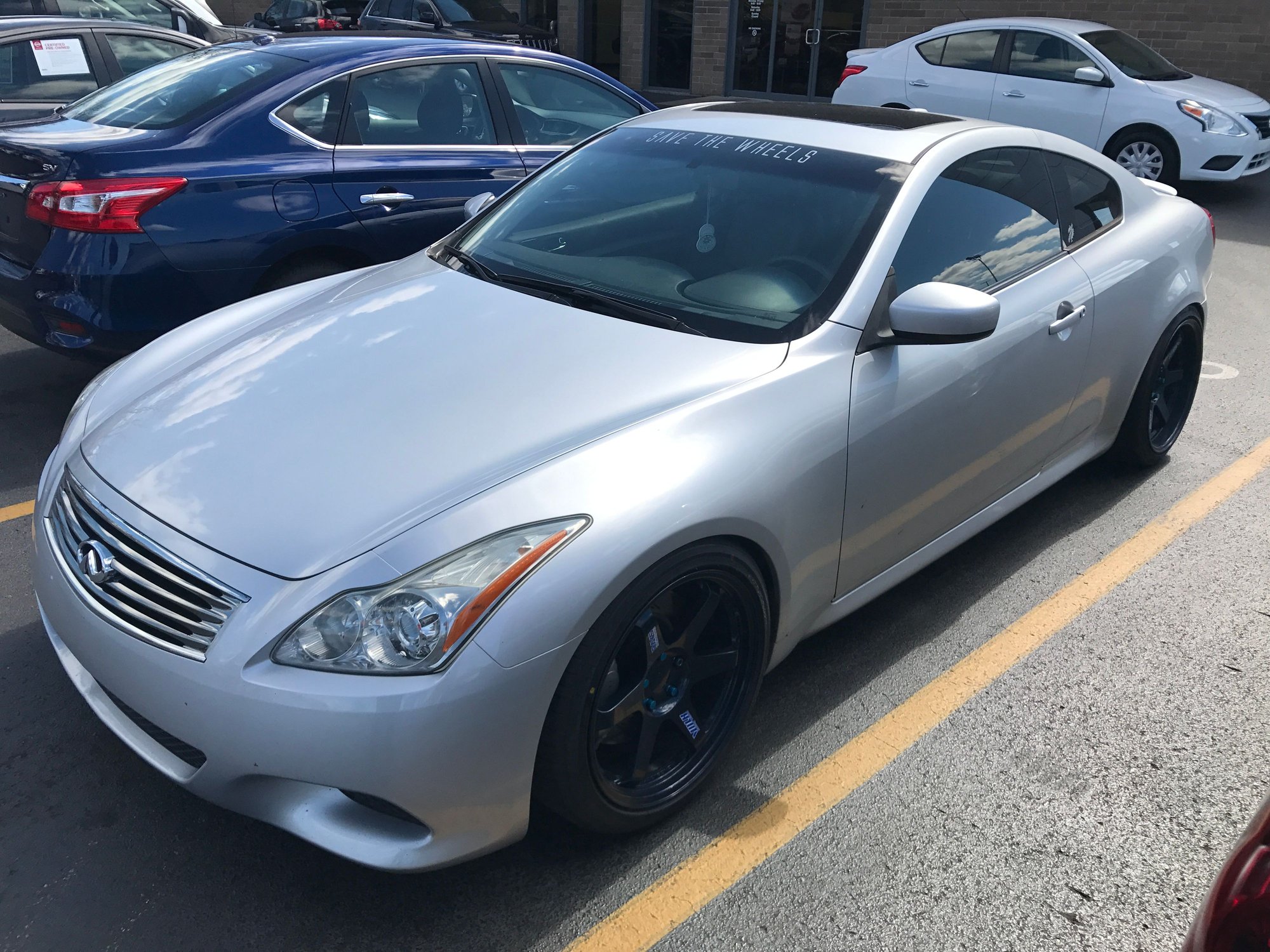

Old Mar 10, 2017 | 08:30 PM
  #1190
gen2_4door's Avatar
gen2_4door
Joined: Sep 2014
Posts: 23
From: Murfreesboro, TN
Well these are just some crappy cell phone pics after getting the TE37's and Stance coils thrown on. Still need to do a little adjustments, but that will be after all the rest of the "cosmetic" stuff gets put on and figure out how WIDE I can fill up the rears!
Volk TE37 OG
Magnesium Blue
19x9.5 +22 245/40/19 Bridgestone Potenza RE050A
19x10.5 +22 265/35/19 Bridgestone Potenza RE11
Stance XR1 coilovers

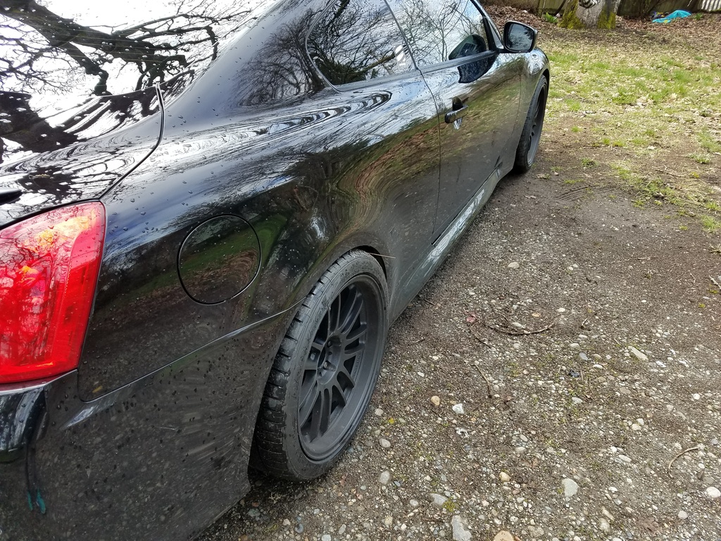

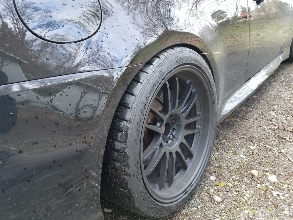

Old Mar 11, 2017 | 06:32 PM
  #1192
PNW_IPL's Avatar
PNW_IPL
Joined: Mar 2016
Posts: 3,050
Likes: 547
Help
So im trying stuff a 19x11 +20 295 30 out back. Camber is -2.2 should i throw in the towel and get a narrower tire? Or drop camber to -3.2 wouldthat work?

Old Mar 12, 2017 | 10:20 AM

Old Mar 12, 2017 | 11:49 AM
  #1194
Likes: 4,952
If you don't mind running heavy camber with good toe specs you could do that until you need new tires then bump down to 275s and get that camber closer to spec.

Old Mar 12, 2017 | 01:50 PM
  #1196
PNW_IPL's Avatar
PNW_IPL
Joined: Mar 2016
Posts: 3,050
Likes: 547
Much rather do that. The 295 are 6 mos old and i don't care about destroying them in a year. Camber is at -2.2 now. Should i go to -3.5?
Old Mar 12, 2017 | 04:23 PM
  #1197
Likes: 4,952
It would be a little trial and error, There was a thread I posted in a while back that had a basic relation between camber value and the amount the tire edge would move in or out but can't recall now where it is
If you have a couple hours to try a few adjustments and just get it to a point where it safely tucks under compression that would be ideal. I'm guessing the camber would be in the -3.2 to 3.5 range, but you aren't too far off right now. Just be sure to get that toe back in once you get it set, that would make your 6 month tires shot in 8 months
Old Mar 12, 2017 | 04:25 PM
  #1198
PNW_IPL's Avatar
PNW_IPL
Joined: Mar 2016
Posts: 3,050
Likes: 547
Thanks B. Gonna mess with it in a few. Tire is really out there lol.
