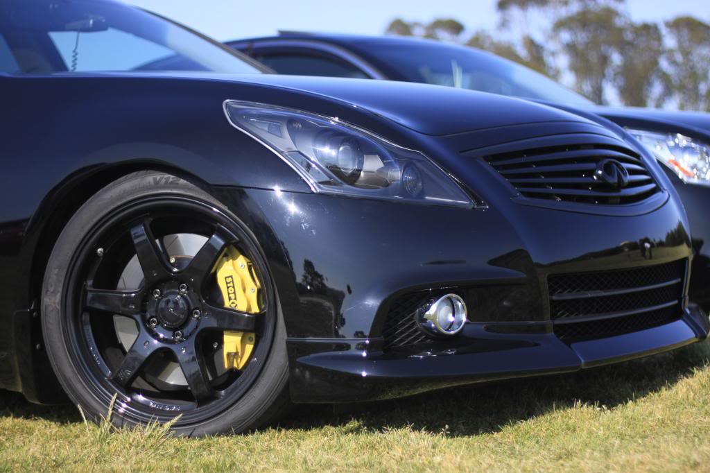

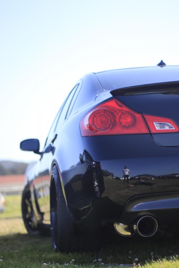

here is my fat tires
And obese brakes
Killer setup!
UGHHHH FACKKKK you have my favorite sedan. hands down
damn looks real good what are the wheel/tire specs
