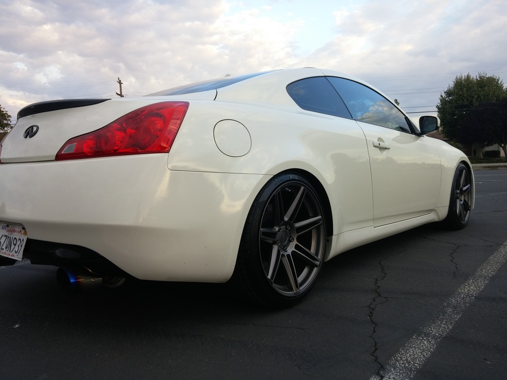

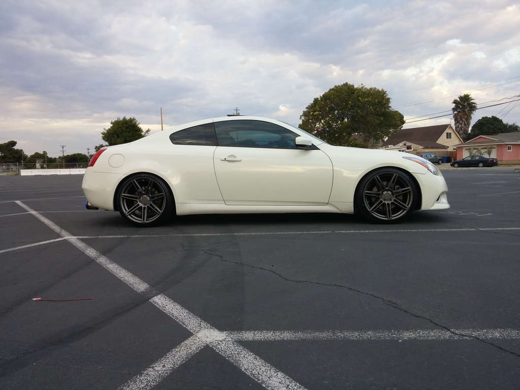

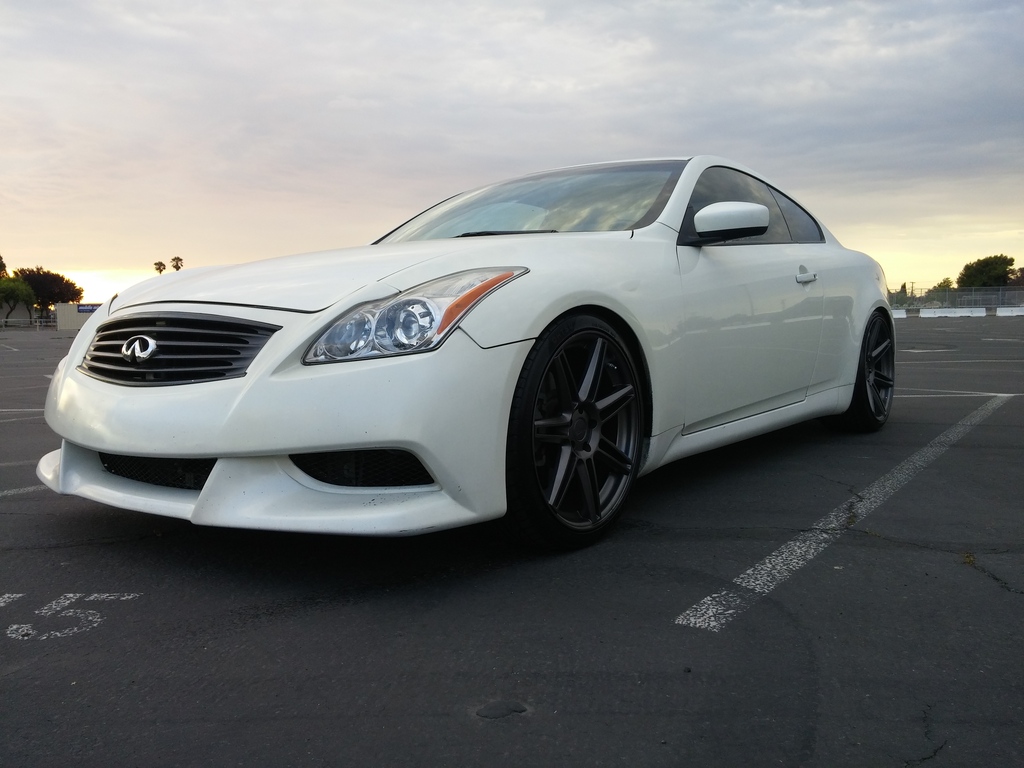

Here I go!
Niche Lucerne
20x9 +35 245/35/20
20x10 +40 275/30/20

Nice choice in wheels Johnny, really go well w/ your coupe and the coilovers look to be well balanced front to rear. Have you had it aligned yet?
Looks like you have about 10mm to go out so 295s probably would have squeezed right inside But the fit looks good, and you can always add some small spacers for a final flush up if you want.

Thank Newt. I really love how my wheels turned out. I've gotten an alignment done when I first installed the coilovers. I do want to lower the fronts and rears maybe a quarter or 1/2inch. I'd like my tires to be just a little tucked.
The wheels could definitely poke out some more. You make me regret not going 295s now

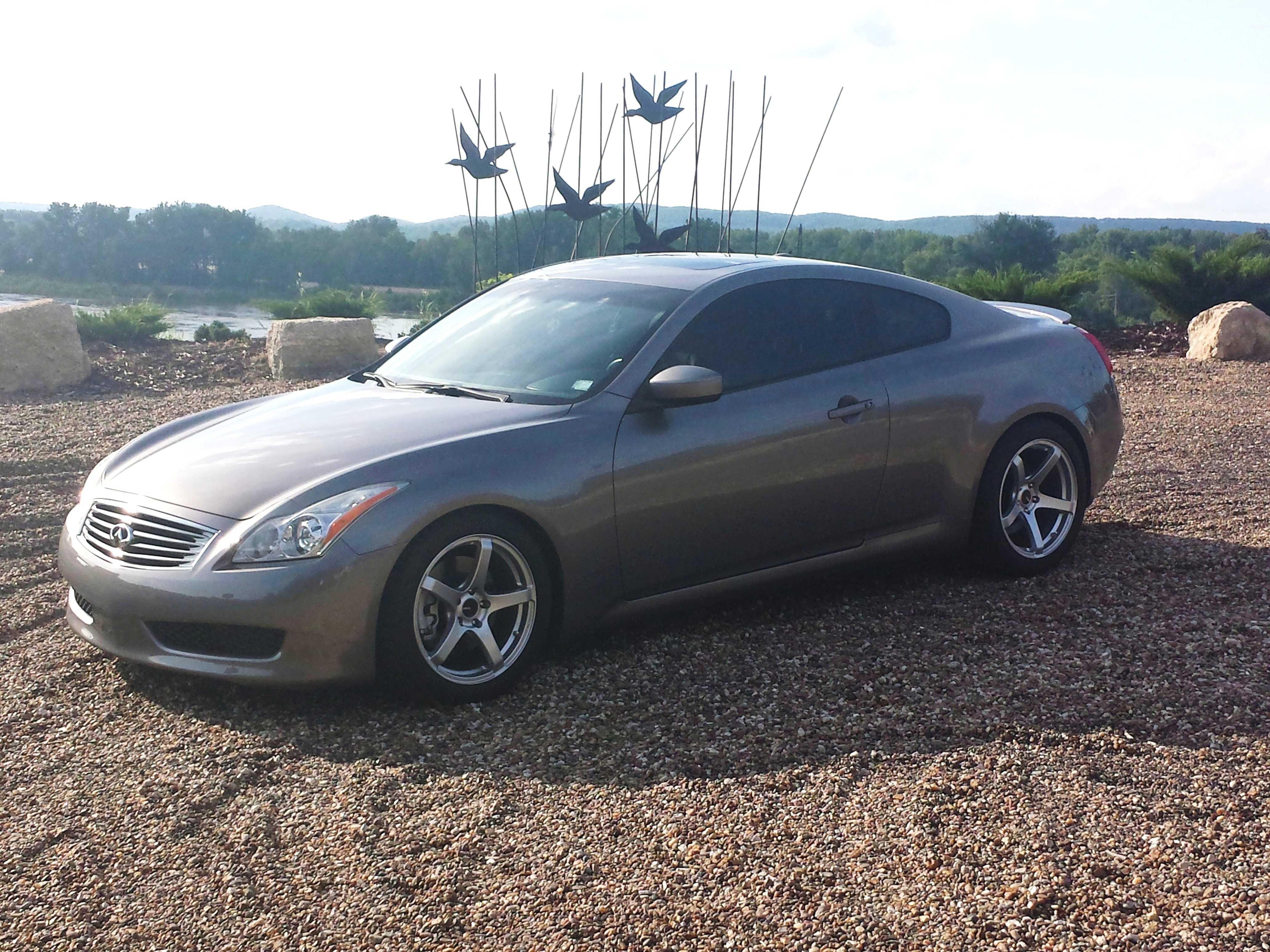

Enkei Kojin
18x8.5 +35 fr 245/45/18
18x9.5 +30 rr 275/40/18
On Eibachs
