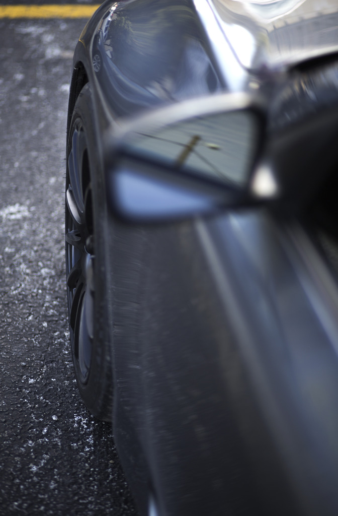

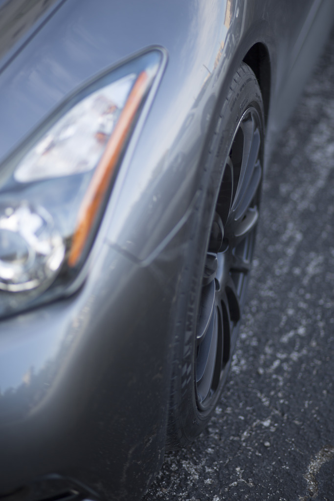

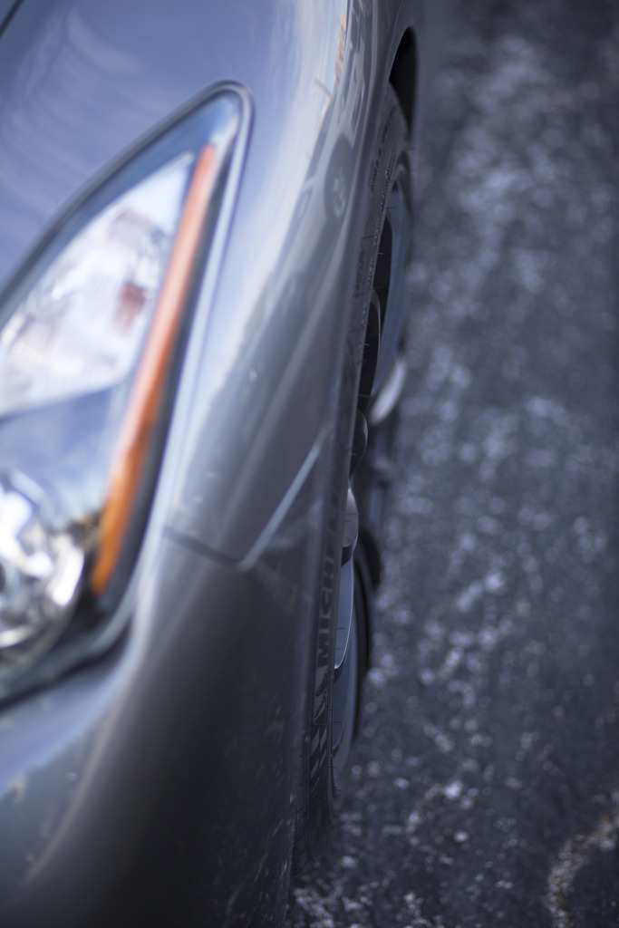

Originally Posted by Nico-derm
Did you ever pull the trigger on those wheels? You are running more camber then me and that's one of those "variables" I mentioned for fitment
Post up the PICS!
Agreed. These are 9.5" rims with a 45mm offset. I just added a 5mm spacer and they're dead flush at the rim. The spokes actually stick out a bit further. For my taste, I would not want them any further out. Pretty much perfect to me.
My camber is -0.4 in front and if I was running -2.0 degrees camber, and independently wealthy, I'd run a higher offset.
