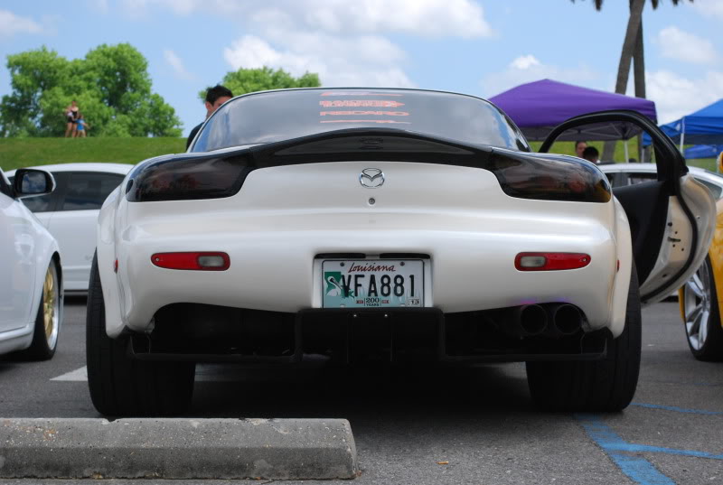

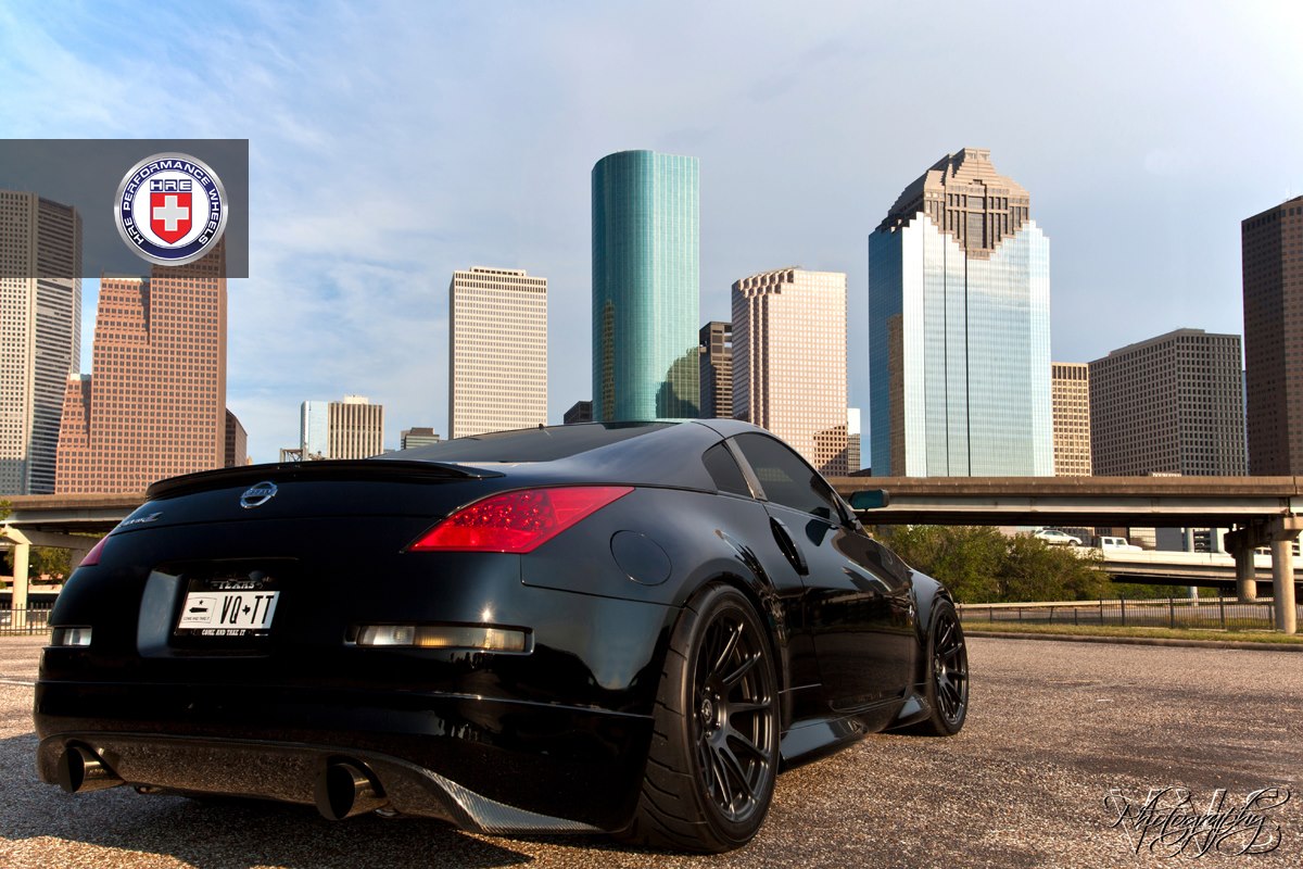

Awesome set-up OMG_ROTFLOL! I do miss my 305 set-up.
Attached Thumbnails Official~Best offsets for running FAT tires!-191891_10151094130716698_450354779_o.jpg   Official~Best offsets for running FAT tires!-avatar_hre_p43sc_toyo_r888-2-1.jpg

Nice fat tires OMG.. What size are the wheels? 9 and 10?

Welcome to the club OMG, rocking the 305s puts you at the podium
thanks
Originally Posted by Staggered357
Damn that **** sits fire... I need a g.. Maxima not enough space in rear to do that...
thanks
thanks
9 and 10.5
Originally Posted by kdawg8526
dats a nice setup looks really good
thanks
FYI: these Michelins are wider than the Hankooks by about 10cm, and not only did I have to completely trim away the fender bracket in the rear, but I also had to cut/file down the trailing arm, and replace the trailing arm bolt with a bolt that has a shorter head on it, and still had to shave down the head of the bolt. You can barely make it out in this pic
this pic shows how much the Michelin 305's stick out past the 10.5 rims
but it sure does fill that wheel well.
