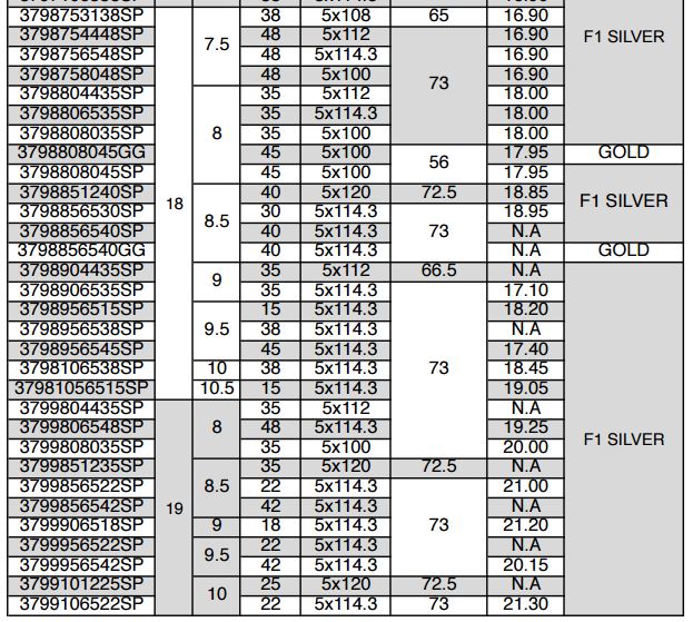

. I may go lightweight wheels at some point, but if I do it'll be something like the Enkei RPF1 in 18x9.5. Here's an example of a member on here who has those wheels. I think he's running 265/40/18. And that setup is about 12-13 pounds lighter than stock. And about 8-9 pounds lighter than what I have now. You could pull those off for less than $1,500. Plus tires, of course.
i've been fantasying over a meaty set of tires on a set of RPF1's, just gotta decide if 18" or 19"
Based on the wheel width and offsets listed in the chart the 18" wheel options will be a better fit for your car. If you have Akebono or big front brakes just makes sure the 18" wheels will clear them... some will and some won't. If you have the Akebono (sport) brakes then 19's might be the safer option.
yea i've been thinking about 18x9.5 +38 not sure what tire size..
the thing is this is my 1st RWD car i refuse to run square lol
