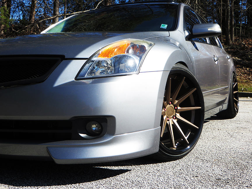

20x10.5 +28 is way aggressive for a sedan, a +40 is about what you'd need to run 275s and a +45 to run 285s unless you want to really go heavy camber. To get those to work without fender work or extra camber a 255/35 is your best option.
Yup, as Brad already mentioned, 20x10.5" +28 is pretty aggressive and is going to make it very tough to fit wide rubber on the rear. You are most likely going to have to run a pretty stretched tire set up and some heavy negative camber to clear in the rear without any fender modifications. Don't think you'll be able to make 285's or 275's to work... even 265's will probably require around -2.5° to -3° camber in the rear. I started with 265's on the rear of mine with 20x10.5" +37 wheels and that set up still required around -1.9° or -2° negative camber in the rear. That became around -2.2° camber when I went to 275's. Then I needed around -2.5 or so when I switched to 285's. Subtract another 9mm (almost 3/8") of offset and your set-up will be even tighter.
I was running 245/35 when I had these on my Altima sedan (see pic). After having the rear fenders rolled, that wheel & tire combo fit with no problem. I know the more narrow tires helped with the fitment issue, but I was hoping to abandon the stretched tire look on the G. I guess I'll start with 265's and see where I can go from there. Thanks of the info guys.
