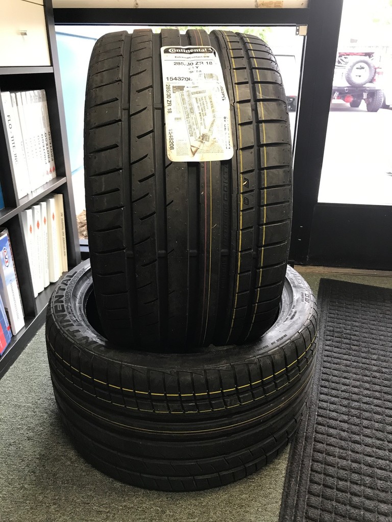

FYI... Here's a pic of some new rubber that I just received... $140 each! Closeout deal from TireRack! These aren't for the G though.

Yeah Adrian, I got the same basic deal $136 per for the 285/40s, made it a no-brainer
What are those for, that German beast??
Your post was what made me look for them. Thanks! I can get sponsorship pricing from Toyo now, but that Tire Rack deal was just too good to pass up.
Yup, good call, they are for the Porsche.... It's up on jack-stands right now getting a whole new suspension (I mean everything!), big front Brembo brakes with 2-pc rotors & braided lines, new rear brakes, new tires, etc... I was also able to find a pair of 245/35R18's in the same tire locally for the front. They were also a good deal, but not as cheap as Tire Rack has them for.
