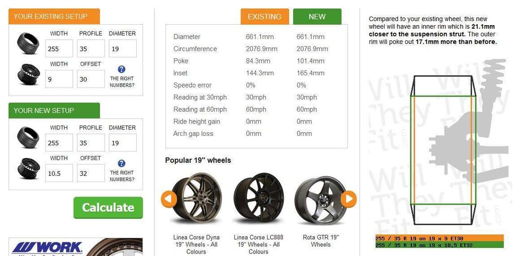

any sedans running 19x10.5 +32 not sure if that will to too aggressive for the sedan rear.
any pics would be awesome!

I run 19X10 +35 in the rear with a 275 tire dropped on KWs. There isn't any constant rubbing but I'm tucked with maybe an inch at the most between the tire and fender. The tires do show some mild rubbing.
not sure if the .5 difference in width and the difference in the offset will wash
here's what i'm looking at.
currently i'm 255/35/19 19x9 +30 and pretty flush but have some gap to the fender. looking at 275/35/19 19x10.5 +32 or even crazier +22
want flush but not really looking to poke out so the +22
