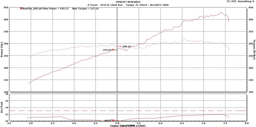

Originally Posted by lownslow
Yes standard 8psi no intention to upgrade anything other than cooling components
That is good choice and it will be very reliable. You can still make great power with the 8psi kit. Here is a Dyno of one we remote tuned in florida. We actually had one better run after but I didn't get a copy of the sheet. We just smoothed out the AFR on the tune after this one and it smoothed out the power band a little more.

430 WHP on 8psi pulley Not bad at all Sounds like a good time
It's not bad at all. The high boost pulley definitely makes a bit more power at peak, but it makes a much fatter power curve so the car is a lot faster with it. I wish I could find the dyno sheets from one we did here, but the boost onset almost 800 rpm sooner.

Thats an impressive remote tune down there at zfever. Thats where I got everything done and the best I pulled on that dyno (full bolt ons) is consistently between 295-300.
430 is pretty solid.
