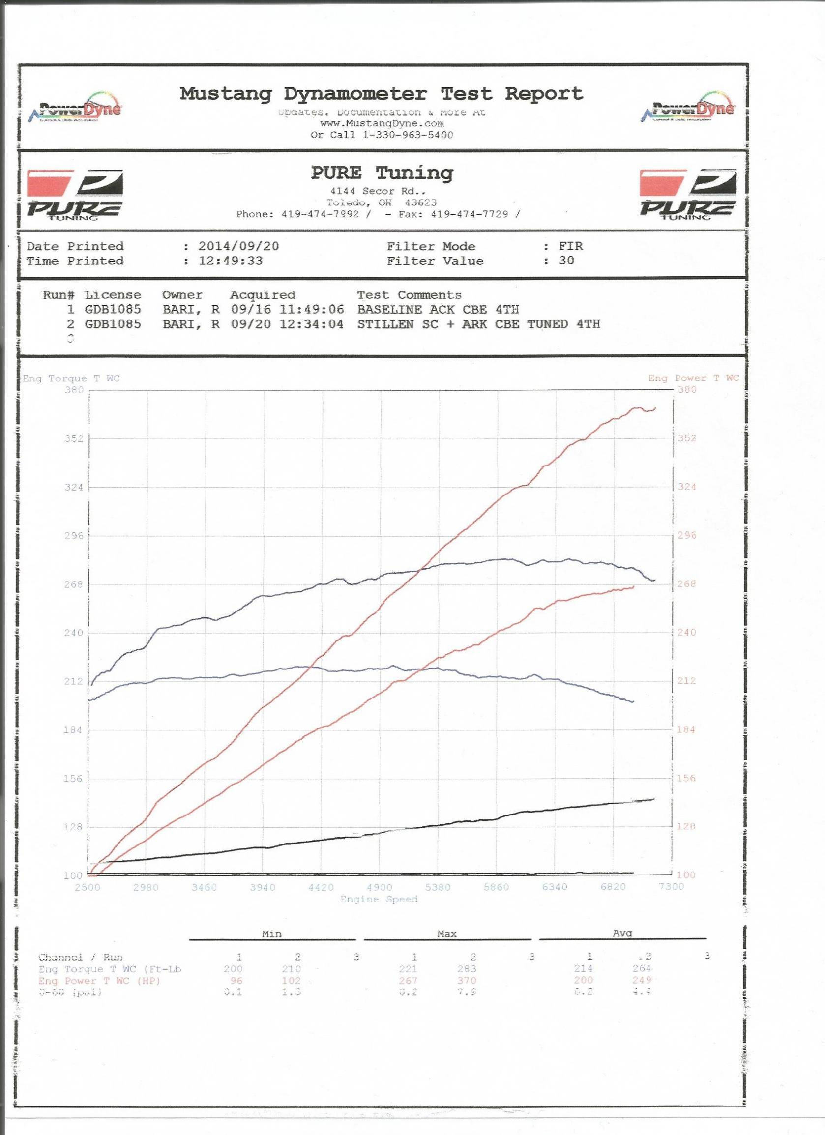

Finally got the supercharger installed, but I'm really disappointed with the power it made. Any suggestions on how I can increase power?
Attached Thumbnails Who has a Stillen G37 Supercharger? Numbers, pics, vids!-dyno-sheet.jpg
Hmmm this does seem kinda low but then again you were using a Mustang dyno which read much lower than a dynojet. My G37 made 422 on a mustang dyno but I had HFCs and the 9psi pulley. Put your car on a dynojet and I am sure you will see 400 +

From: Toledo, OH
I know but most people made 400+ on a mustang dyno. Btw I'm planning to get the 9 psi pulley will it be safe to use with the stock trans and engine? Also, Stillen says not to use HFC's the stock cats make more power.
