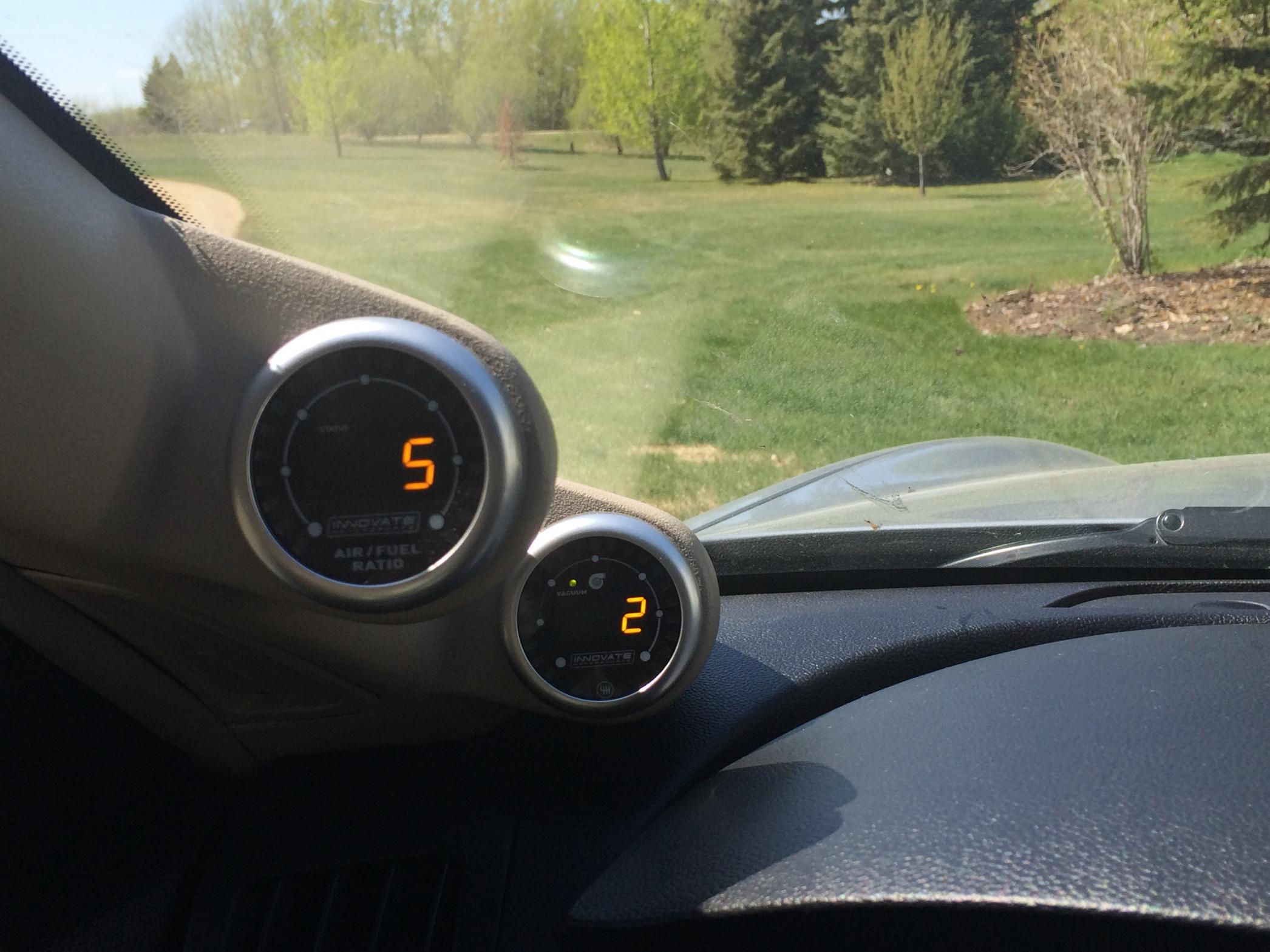

Originally Posted by willstophe
Still undecided on what to do about the gauges. I might just go old school and do a pod next to the drivers side window.
I actually had a bit of a challenge getting an "A" pillar gauge pod for the G37. I had to have one custom made, but am ultimately happy with the look. I went with Innovate gauges... AFR and Boost.
Attached Thumbnails Who has a Stillen G37 Supercharger? Numbers, pics, vids!-img_0095.jpg

Nice look man those are good gauges.

Thanks... I was really happy with how it all came together. I have seen some really ghetto installations of gauges. The setup of the gauges was a pain as they give you a serial computer connection. No one uses serial anymore as the standard is now USB... so I had to buy a special adapter cable. Still gave me error messages I had to contact Innovate on facebook and they told me that I also needed special drivers installed to make the stupid adapter cable work. Of course none of this is on the instruction manual.
