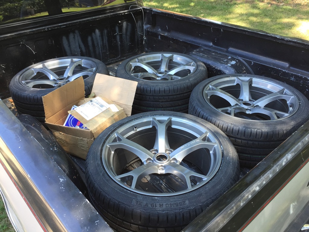

Also, Just finished these up. 19x9.5 +40 255/40/19
Will post better pictures tomorrow.

square nismo fronts
19x9.5 +40

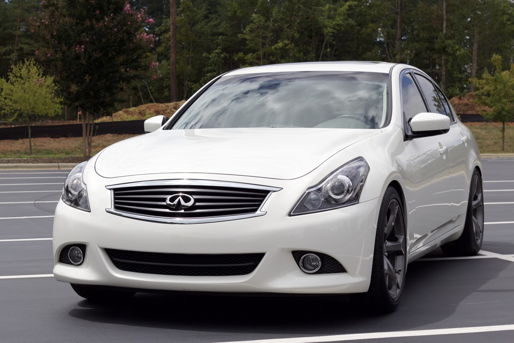

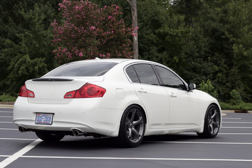

Hey guys. New to the forum. Just picked up a 2013xS sedan. Read through this forum and the previous one dealing with the coupe 19" wheels.
New the tire and wheel scene. Have a few questions.
Im looking at two sizes. 19xTSW Nurburgring Wheels for Infiniti/Nissan/Genesis 5x114.3mm 5x4.5in9 et32. The other is 19x9.5VMR V710 Wheels for Infiniti - 19" - Gunmetal - 5x114.3 et 22. Both fitted with 255/40/19
This is my first awd, i assume with the wider tire, the better ( will be fitted with all season)
I guess im concerned with the offset. I understand in other people setup, the 30's offset seem to be pretty flush, but i am favoring the look of the 19x9.5, so would the 22 ofset be sticking out a bit from the car?
Stock height, will consider lowering options after wheels installed
Thanks for the help everyone

Old Sep 1, 2016 | 03:17 PM
  #657
OB6spdSedan09's Avatar
OB6spdSedan09
Joined: Mar 2016
Posts: 22
I have 18x9 square +35 w/ 265 tires and lowered on Eibachs there is a few mm to spare but overall quite flush. I think the TSWs would fit beautifully, and you could always reduce the effective offset with a 10mm spacer if you want to go super flush.
I think the other wheels would fit if you lower sufficiently without ridiculous camber, especially with 255 tires. Ultimately if you fit the tires under the fender you can have a bit of wheel poking out if you like that look.

Old Sep 1, 2016 | 04:23 PM
  #658
Yeah, for a sedan go w/ the 9 +32, the others will poke a bit outside the fender. And FWIW all of chinky choys sets use 245 width tires.
As mentioned before, the TSW would be the more conservative fit, which would be in your best interest since you are not lowered. I'm at 19x9.5 +33 with 245/40 all around, with 2 degrees of camber and that's about as flush as I'm willing to get (zero gap). A 9.5 +22 will fit, there have been more aggressive fitments on a sedan, but usually require fender pulling, additional camber, much lower suspension, and stretched tires.
In short, go with the TSW. But if you really like the style of the VMR, chat with my buddy Tracy at VMR, he is their sales rep for the JDM market. I'm sure he can set you up with something that fits your ideal setup

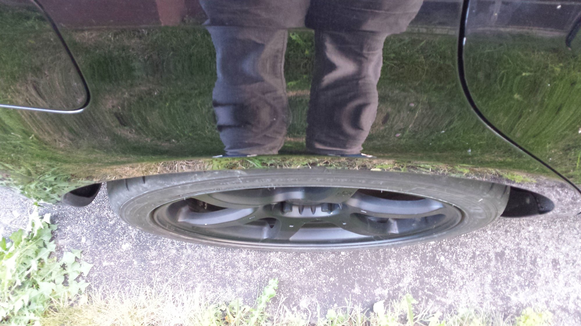

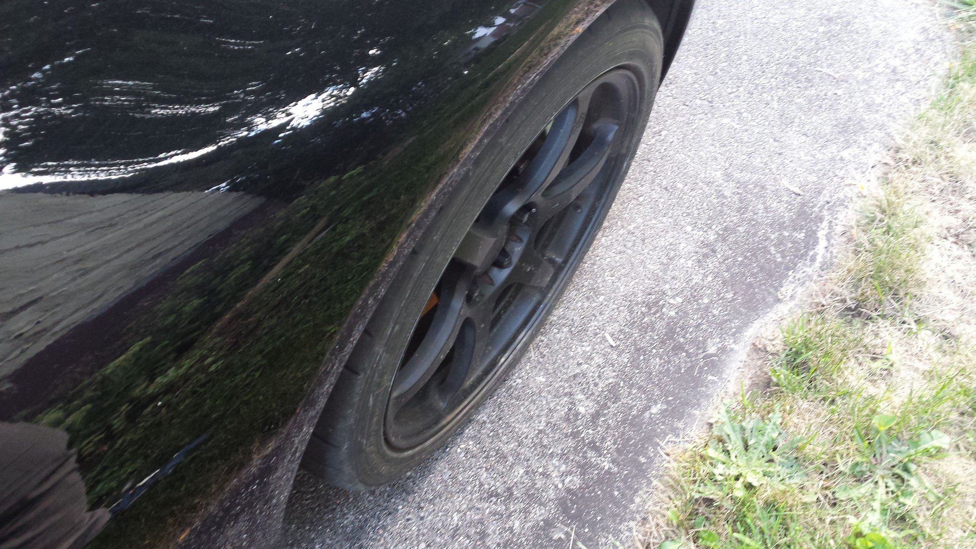

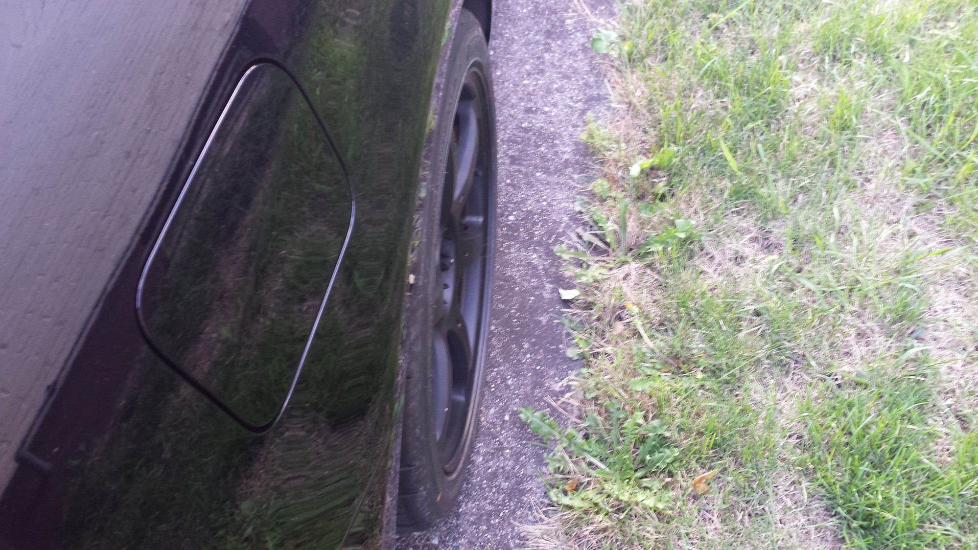

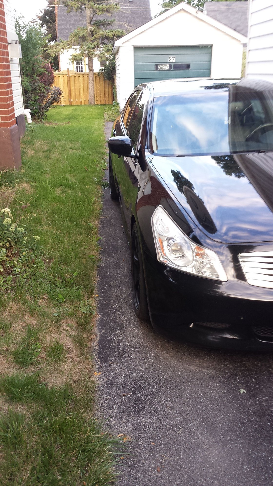

I took a few quick pics last night to give some reference for those considering setups.
Sorry for the condition of the car, it has been parked for a few weeks waiting for shocks.
Keep in mind:
a) I am lowered on Eibachs, and shocks/struts are shot so some times the car "sits" funny (leans to one side), especially in the rear.
b) The tires are 265/35R18 which make the car sit ~17mm lower than the OE tires. Not ideal but I didn't want to throw away perfectly good tires.
c) Rims are 18x9 +35.
Rear:
Front:
From the front:
