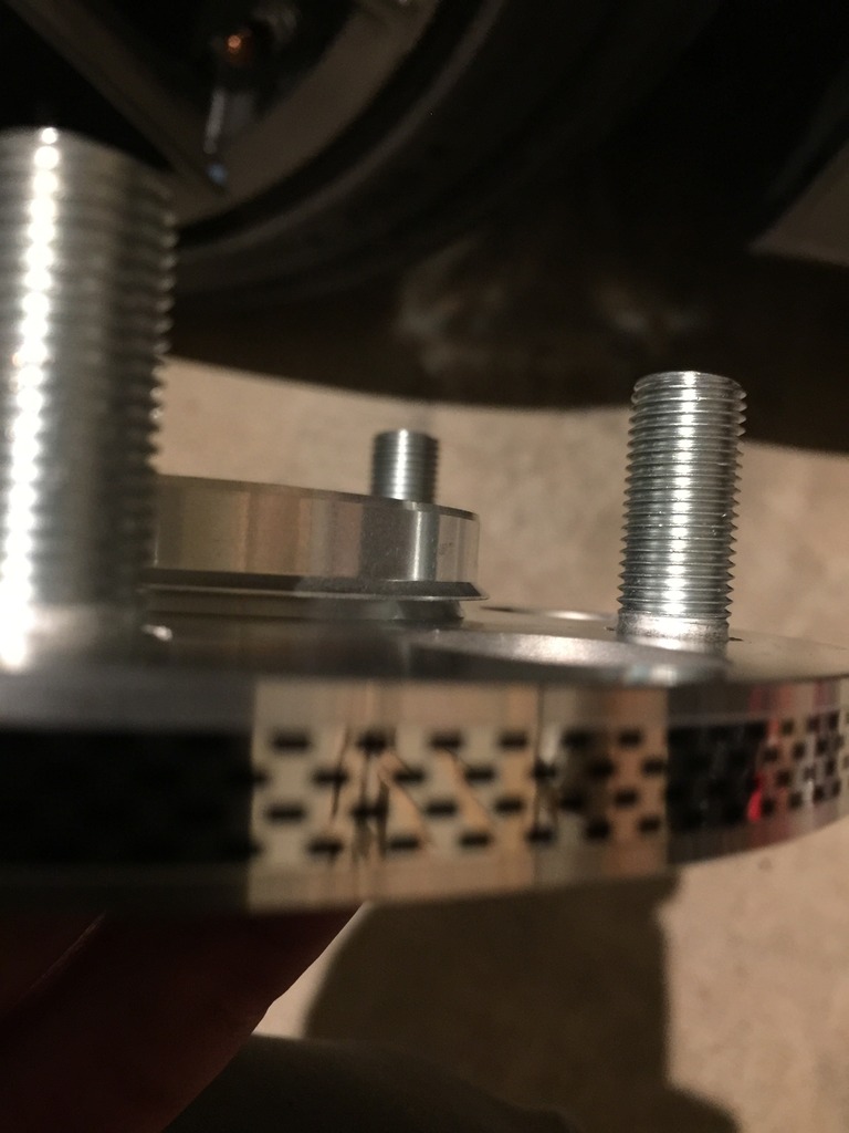

This is exactly what I had planned on doing. I'm currently waiting on them to install tires on a set of 19x9.5's with a 45mm offset and had planned on using a 10 and 20mm spacer but it doesn't look like I need to honestly. I'll know more when they're done. I didn't want to run spacers but at that width, either the fronts aren't where you want them to be or the rears aren't. I'm not running much camber currently and I'm not even lowered an inch.
One thing to be careful of, I ordered a set of 10mm spacers from ConceptZ, can't remember the brand off hand, but the spacers are hub centric and they flare out at the base. This is an issue as if you use hub centric adapter rings, they won't sit flush on the base of the spacer. So just make sure the spacer doesn't flare out at the hub base.
