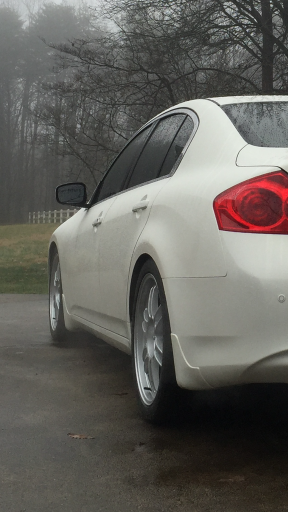

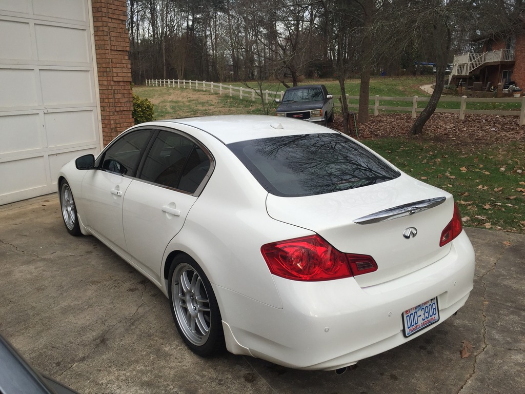

Hey guys, I recently picked up a set of 18x9.5 +38 set of Niche Verona wheels for my G37xS. Got them for really cheap. More than half the original price brand new.
Down sizing from 20x9 +35 running 245/35/20 on all 4 corners. What tires should I run for the 18s?
First Question is how will these sit in the wheel well? I have a set of 5mm spacers at home sitting in the garage as well as 20mm spacers on the rear for my 20s at the moment.
I really want to have a meaty (Fat) tire stance now. I really want the comfort in the ride back.
Below I attached a picture of the 20s. They have a 20mm spacer on the rear with -2 degrees camber all around with rear camber kit. I've had the same tires for 2 years with camber wear showing now.
Attached Thumbnails HELP~All squared setups please post here!-2015-09-14-11.04.30.jpg   HELP~All squared setups please post here!-g7.jpg
Old Jan 3, 2016 | 04:52 PM
  #348
Likes: 4,952
Nice score^^
On your sedan they'll fit just about perfect as far as being flush. I'd run a slightly stretched 245/45/18 on the front, or no wider than a 255/45. If you still want to run wide in back a 275/40 will work, just have a slightly different look at the sidewalls front to back. Ryne runs staggered tires on the same width rims with good results.

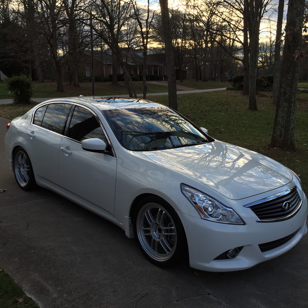

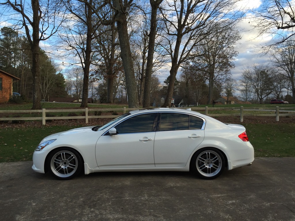

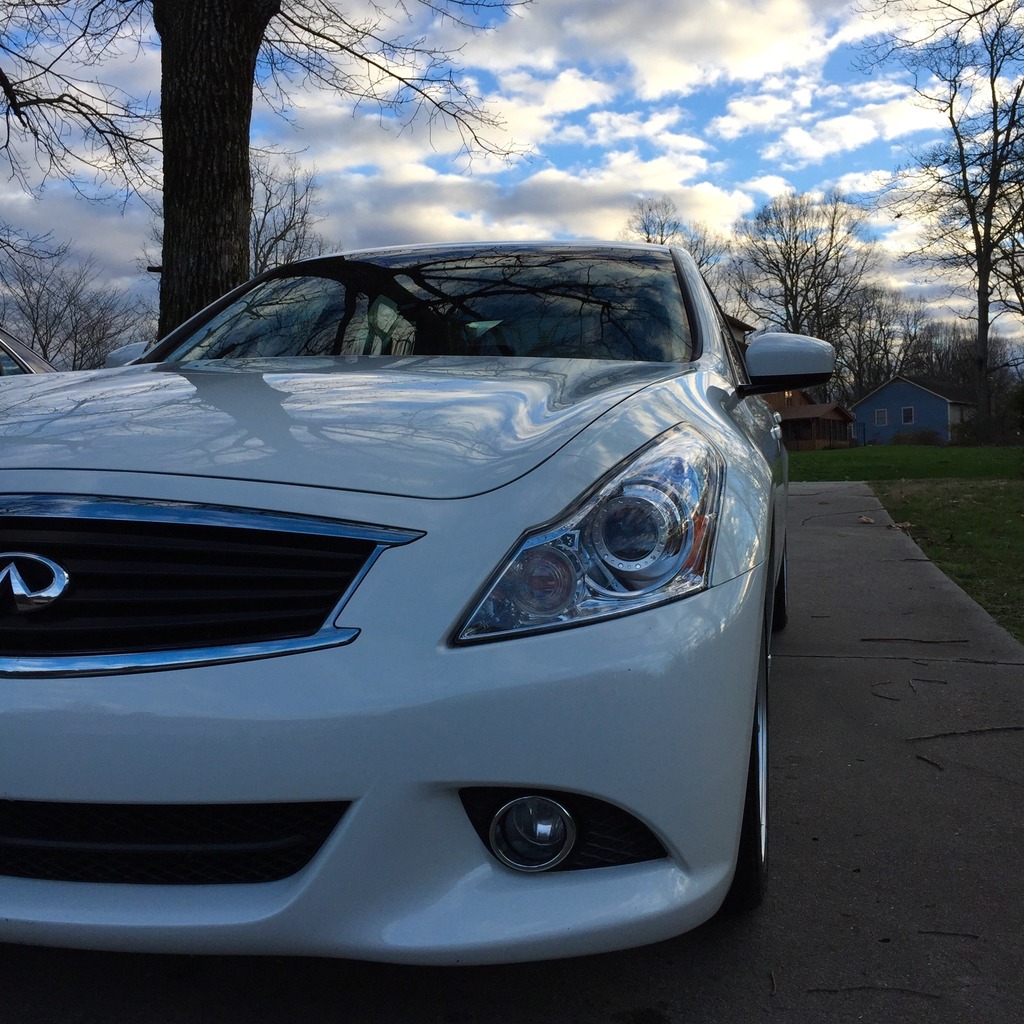

19x8.5 +42 square 245/40/19 eibach pro kit springs
