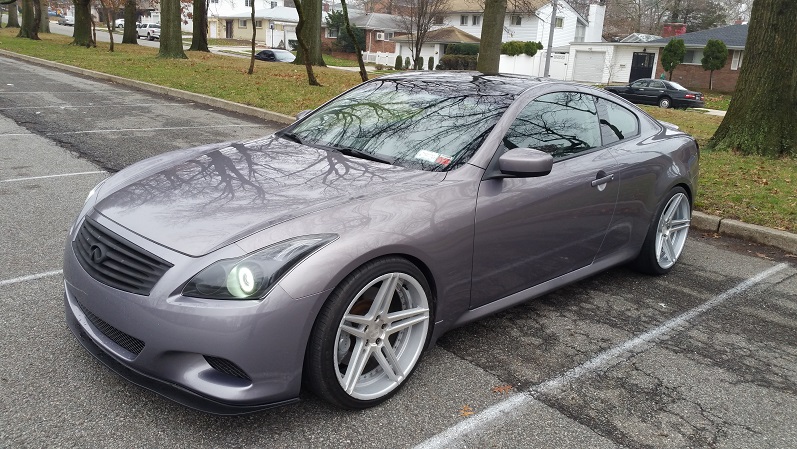

Depending on tire size they'll be pretty flush. I was running +20 offset on eibach springs and was pretty even with the fender but would tuck under compression.

Only pic I have unfortunately, 245/40/19 on a 9.5 +20. You won't need to do any fender work.

thanks baby jumpman. Your sedan looks amazing!!!
