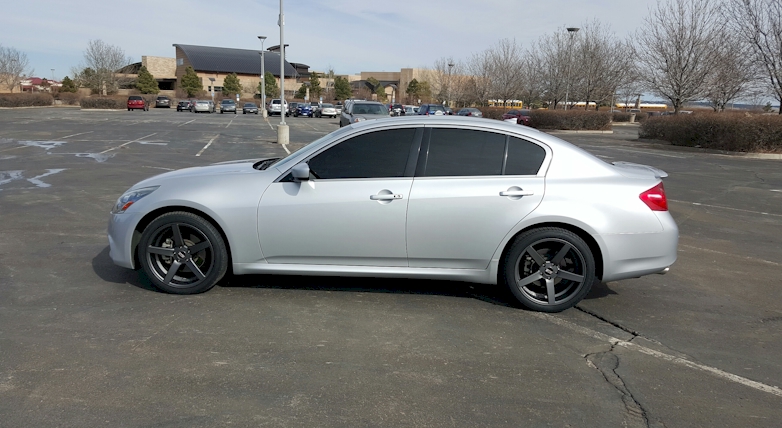

My new setup:
STR 607 19x8.5 +30
Continental Extreme Contact DWS 06 245/40/19
The only thing I notice going from 18" to 19" is that I hear the expansion joints in the street a lot more as I drive over them. Other than that I really like my setup.
Attached Thumbnails HELP~All squared setups please post here!-new-wheels-small.jpg
Old Feb 19, 2016 | 07:00 PM
  #379
Originally Posted by jee-sedan
Cool!
My new setup:
STR 607 19x8.5 +30
Looks pretty good for not being lowered, wheels look proper on that sedan too, decent choice there
Old Feb 19, 2016 | 07:35 PM
  #380
jee-sedan's Avatar
jee-sedan
Joined: Oct 2015
Posts: 12
Thanks! I didn't want anything extreme, just a tasteful update for a nice daily driver.
New wheel day is so much fun!!! lol
