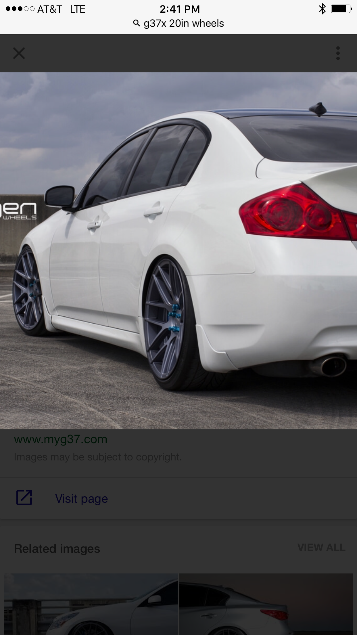

Posts: 30
So if I want a concave look what wheels should I be looking at and that will be flush with the fender what offset should I be looking at? The rear wheel is the look I want. The OFFICIAL "I have a wheel offset / tire fitment question!" thread-image.png

Old May 21, 2016 | 01:16 AM
  #1435
Likes: 4,952
Originally Posted by dsolis
So if I want a concave look what wheels should I be looking at and that will be flush with the fender what offset should I be looking at? The rear wheel is the look I want. Attachment 120887
Take a look at this thread if you haven't already seen it~
ChinkyChoy has some 9.5 setups w/45 tires that should be what you're after, just substitute your concave wheel of choice. The Forgestar Deep concave should get you there. IMO you would be pretty tight w/ a 9.5 +35 and you could run a 255 to really get to the fender, or a 10+40 on a 255.
https://www.myg37.com/forums/brakes-...post-here.html
GetYourWheels.com: Forgestar Wheels Forgestar F14 Custom Colors Available Wheels : Wheel and Tire Packages|Staggered Wheels|Custom Wheels|Luxury Rims
Also keep in mind that G that you posted is slammed on coilovers, you won't get that look on lowering springs, but those specs I listed will get you a nice fit IMO.
