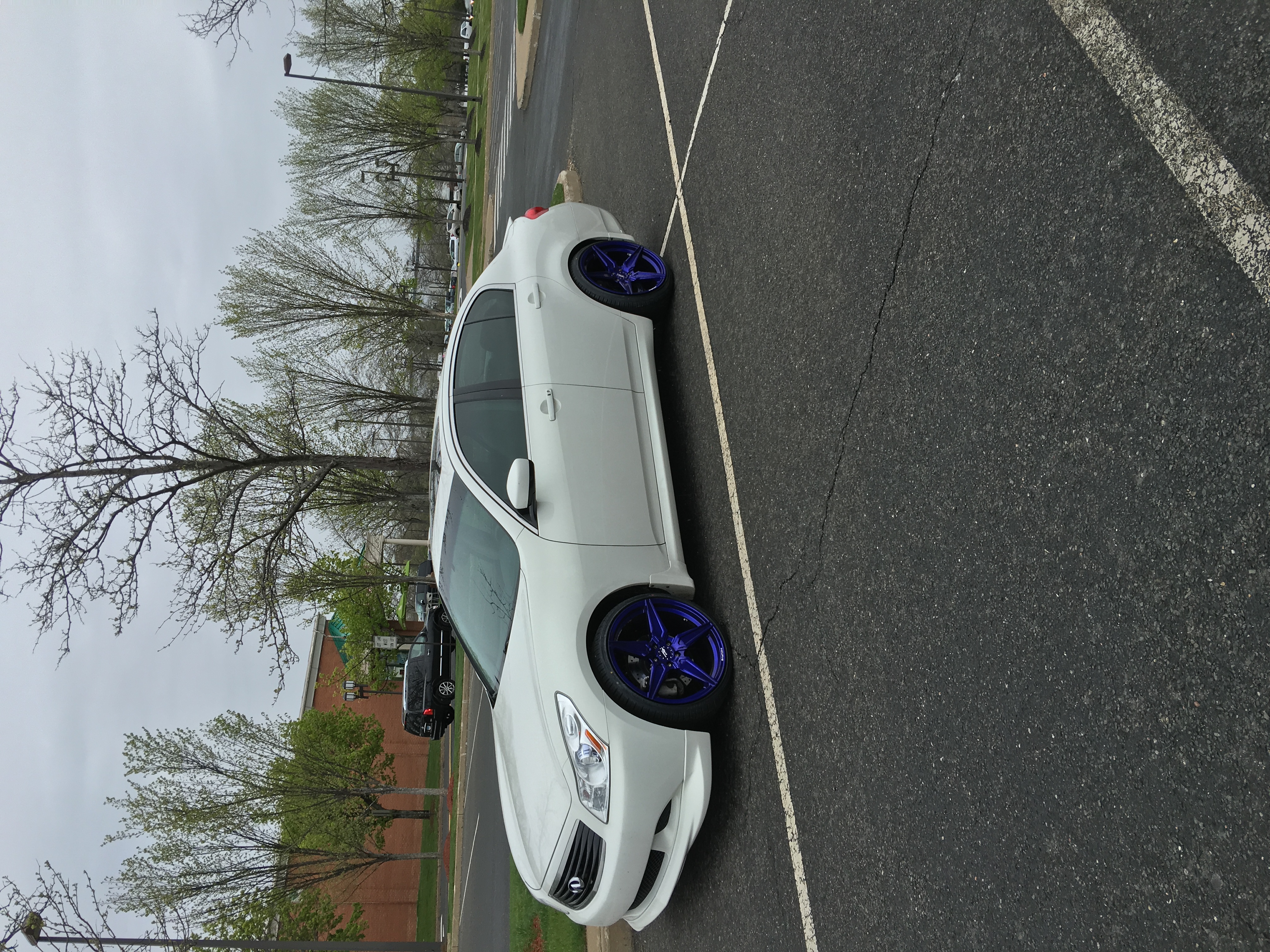

Hey all,
I'm having tire issues with my set up. Since my car is awd the light keeps flashing. I'm running a staggered set up 20x9 and 20x10.5. The tire sizes are 225/35 and 255/35. The best solution would be to get a 225/40 in the front but they don't make a tire that size.
What are my options other than taking the staggered wheels off?
Attached Thumbnails The OFFICIAL "I have a wheel offset / tire fitment question!" thread-image.jpeg
