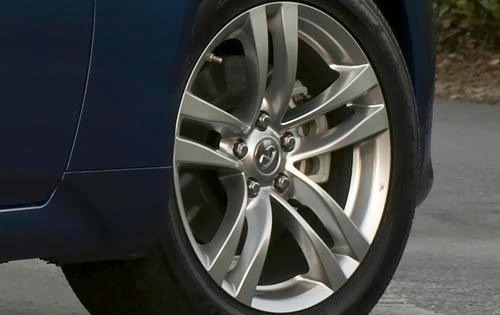

What size spacers are best on stock non sport 18' wheels?
Lowered on Tein S techs.
See pic below
I've seen 20mm all around, but also seen 20 front/25 rear, and 20 front/15 rear.
The stocks are 18x8 +43mm offset I believe, which should be the same as the sport 19' wheels (19x8.5 +43)

Here's a pretty good short clip, may be of help
