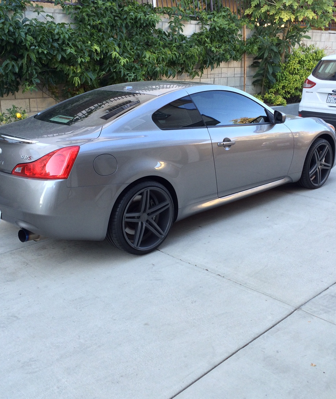

Hi All - Just bought 20x9 +20 (235mm) and 20x10.5 +25 (255mm) CV5s. The front sits perfectly flush and I like them, but the rears stick out a bit too far for me. I have an 09 coupe S at stock height. From reading around the forum, it seems that lowering the car would allow the rears to come in a bit and give me that flush look. My question is, which lowering springs are best to achieve this? I am thinking about Swift.
Thanks
Thanks
As you lower, the negative camber will increase which will tuck the tires into the fender within reason. If you go real low then use camber arms to bring the camber back to a reasonable range. I'd say Eibach for a mild drop and Tein S Tech or H&R springs for a deep drop, but would definitely need camber/toe kits on the last two to keep tires from getting worn out quickly.
Got any pics down the side of your car for reference?

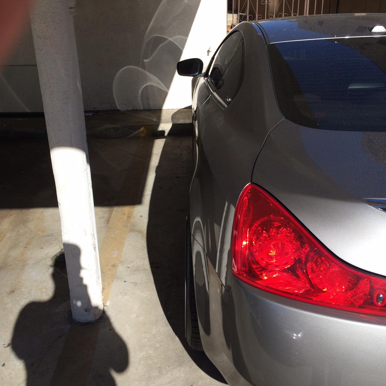

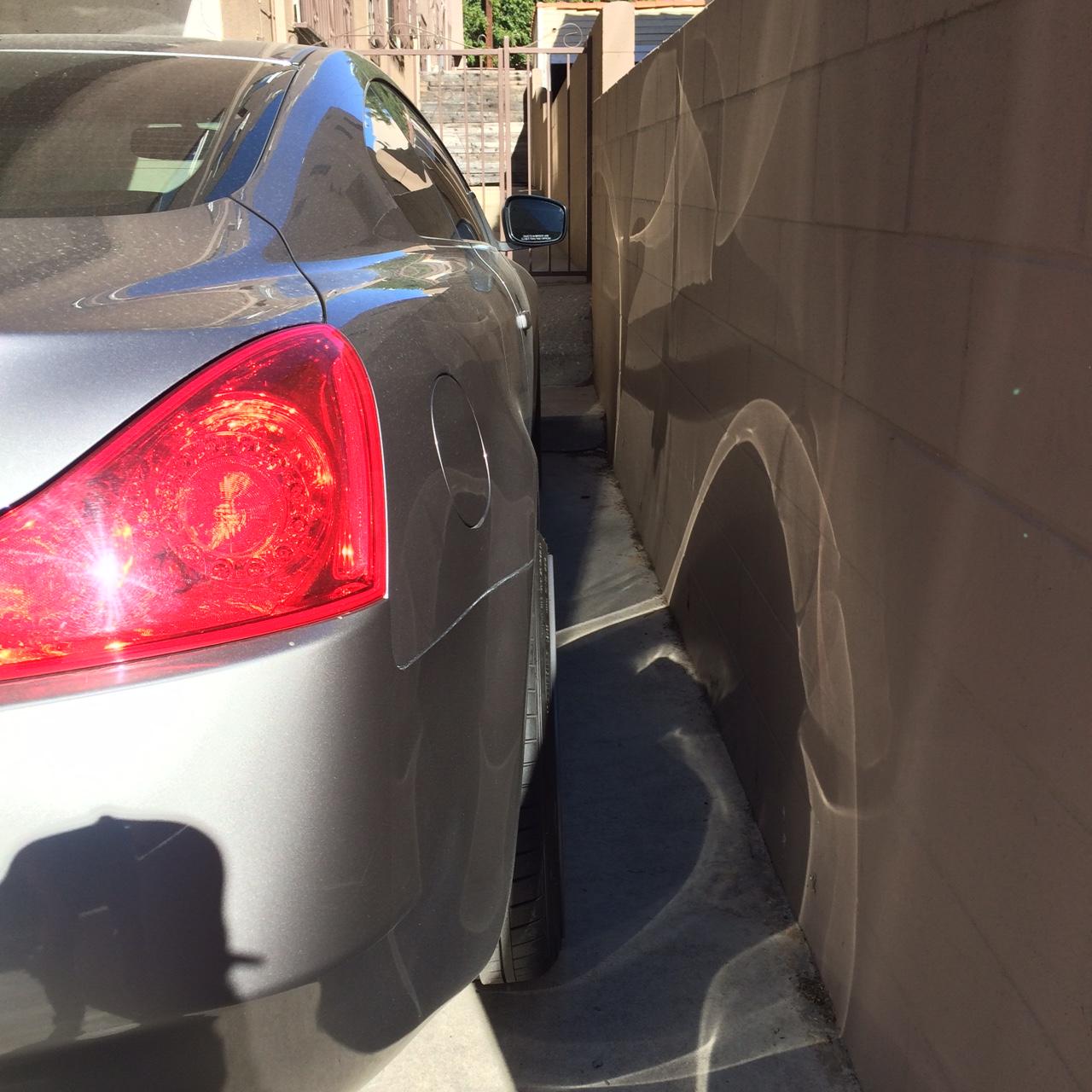

Yes, here are some pics. As I mentioned, I am considering the swift springs which is a 1" rear drop and 1.3" front drop. It would seem I have sufficient room for that and would not need any modifications? I also do not believe a camber kit is needed with swift?
Thanks

The rims will still poke a bit but lowering will tuck the tires in quite a bit more that current.
Camber kits should be used when lowering your G but that's up to you. IMO it's a small price upfront for the long term benefit.
