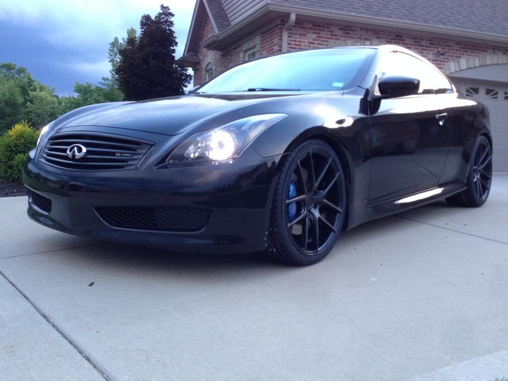

Here's JPat94 coupe on Niche Targas 8.5 +35 10 +40 on 245/285, I think you could run the top option w/ 255/35/20 front and even 295/30/20 rear.

Thanks for the help blnewt! If I wanted to run a square setup for deep concave on all corners I guess the 20x10 +40 would sit flush with the front fender also?
