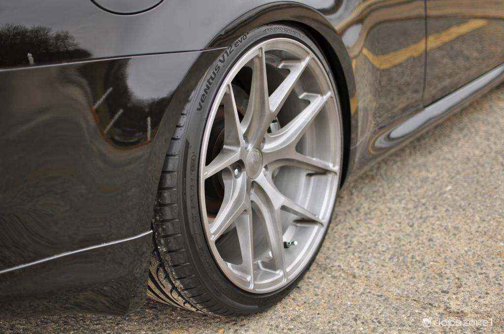

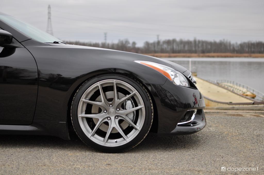

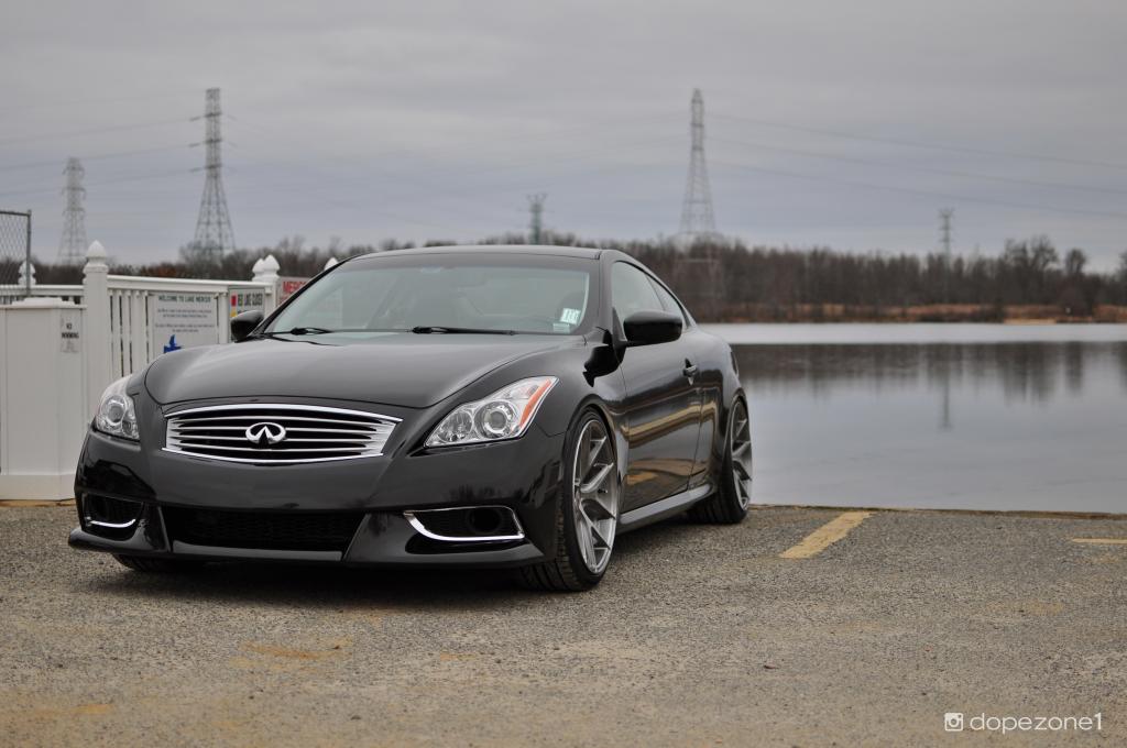

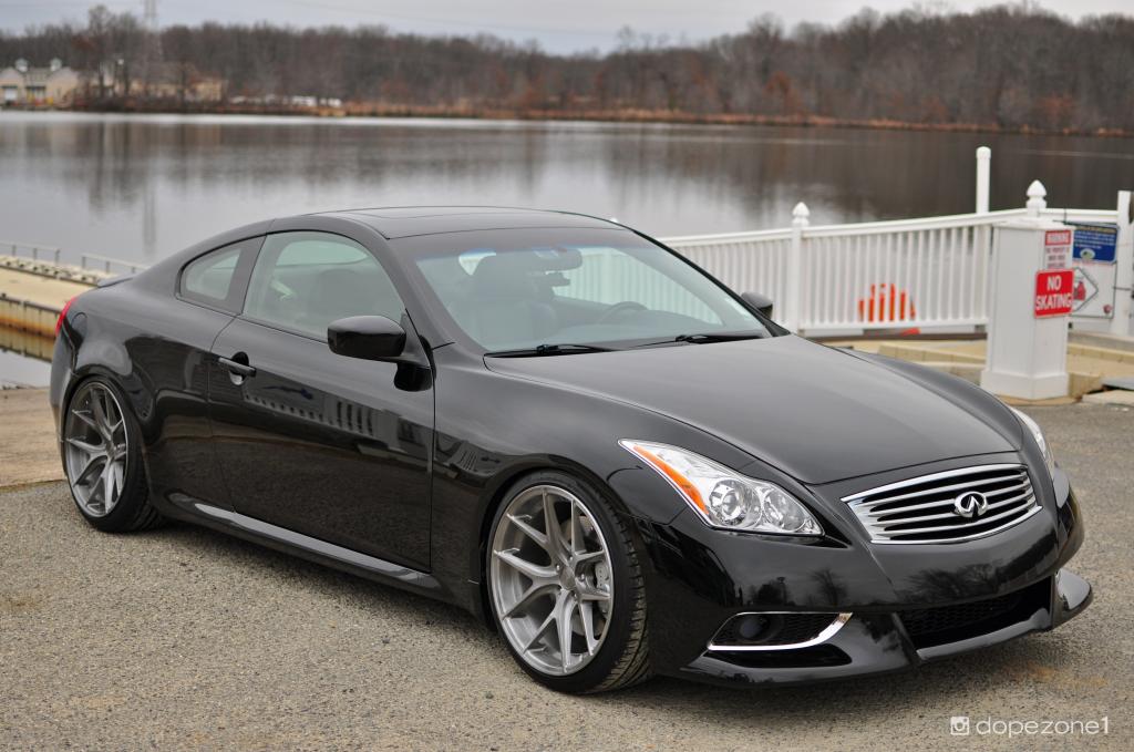

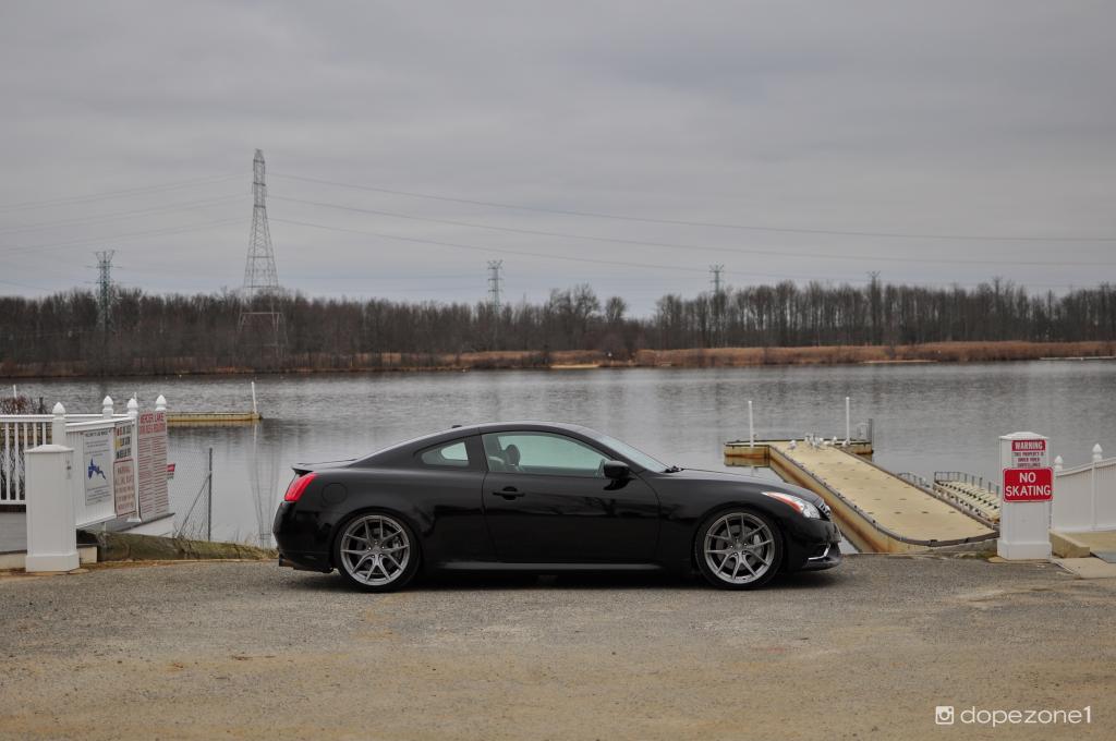

Wheels arrived! Super happy with how they look! There was rubbing in the rear, but that was fixed by trimming a portion of the fender liner and a portion of the rear bumper bracket.
**Thanks for the help blnewt!!! Pics uploaded correctly
**Had issues uploading pics. If anybody can help with this, I'll edit the post. For now see link below for pics (10 total):
https://www.flickr.com/photos/130160...5/15878519370/
Those look great

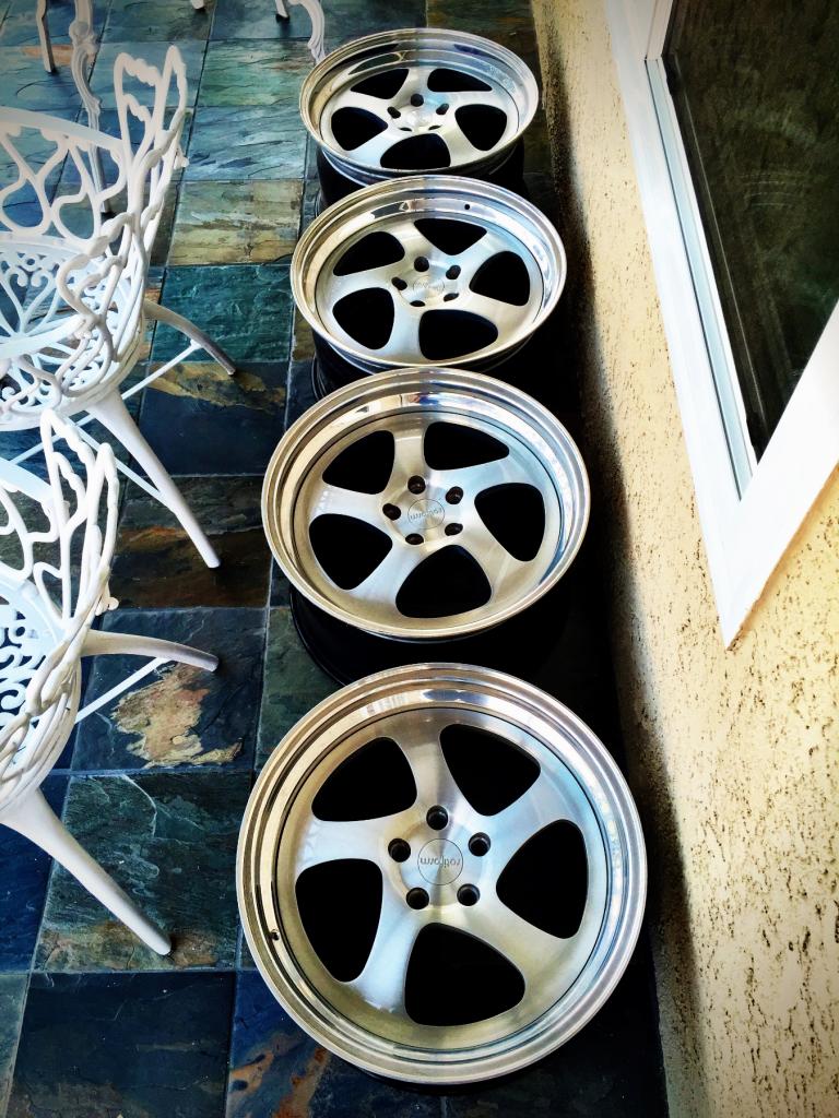

Alright picked up some new wheels
Rotiform TMB
Fronts - 19x10 et20
Rears - 19x10.5 et48
Now im not too sure what tires i should get. These will be going on a 2014 Infiniti Q50 so fitment should be similar to a G37 sedan.
Local tire shop was saying 245/35 for the front and 255/35 for the rear. I drive my car (canyons once a week) and i think that the sizes they recommend have too much stretch. Any recommendations for tire sizes? Im going more for the fat tire than stretch.
