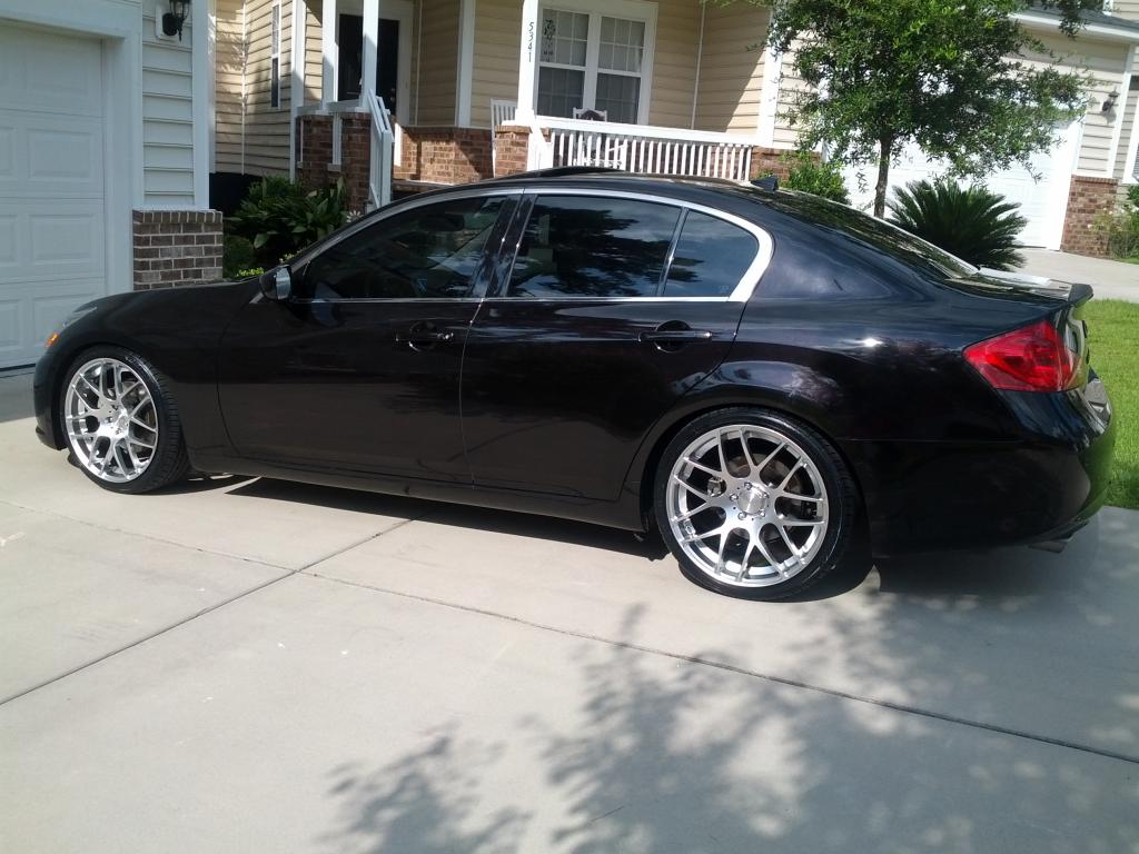

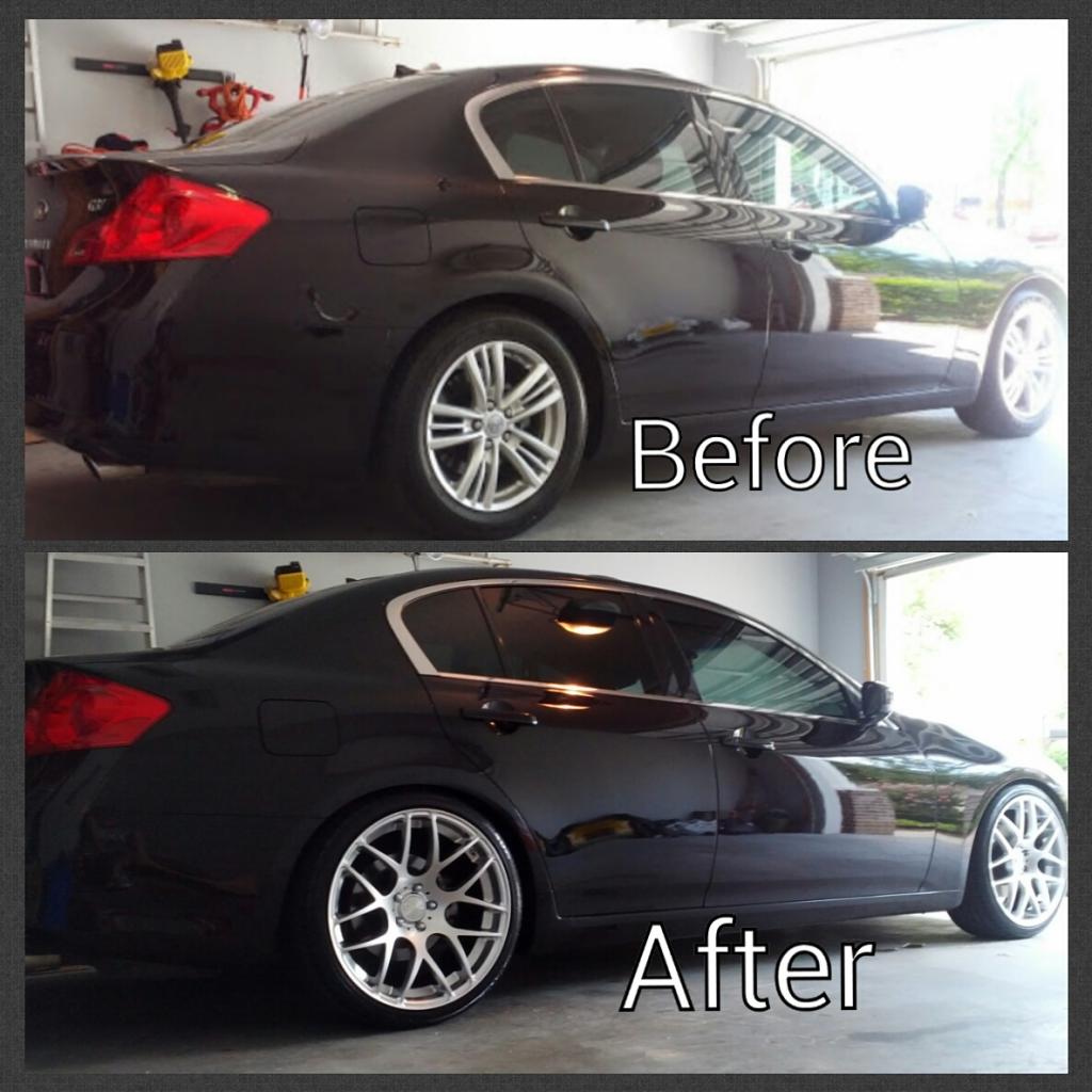

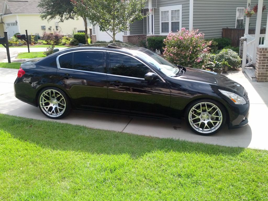

Finally got my wheels and tires installed. Did a bunch of research using this thread. Let me know what you think.
2013 G37 Sedan
Eibach Pro Springs
Avant Garde M310
20x9 +30. 20x10 +40.
Toyo Proxes 4 Plus A/S
245/35. 275/30.

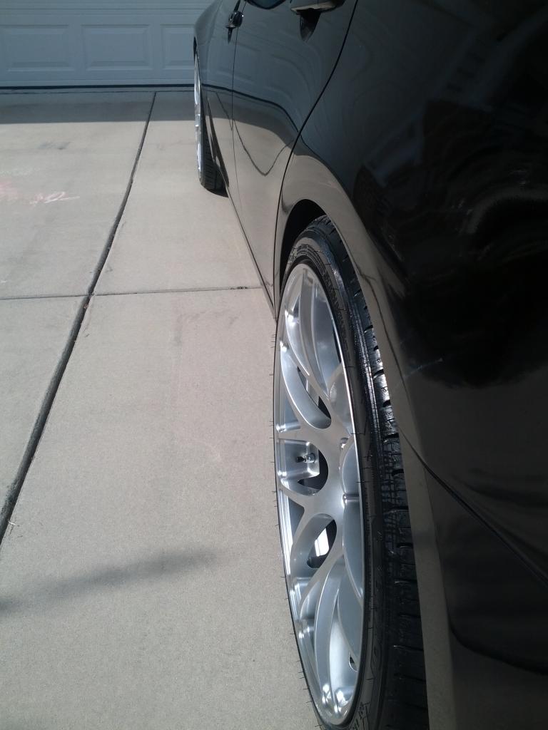

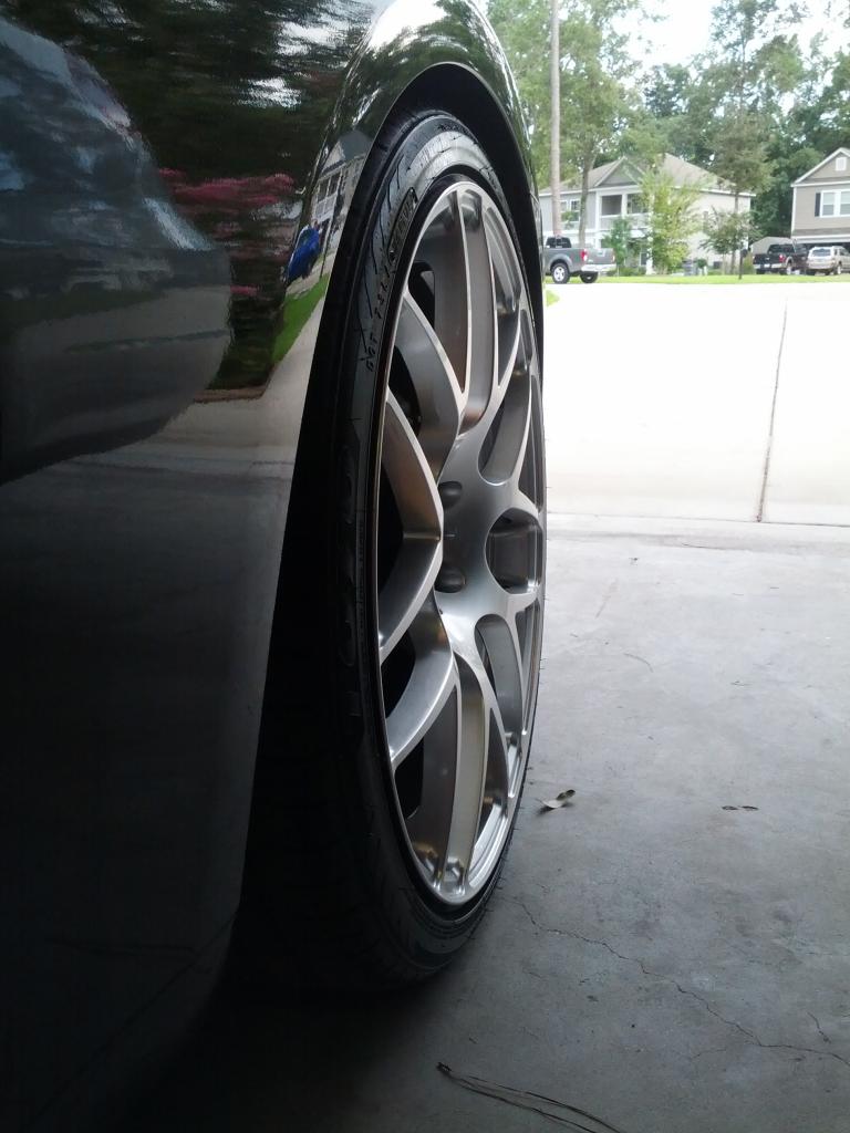

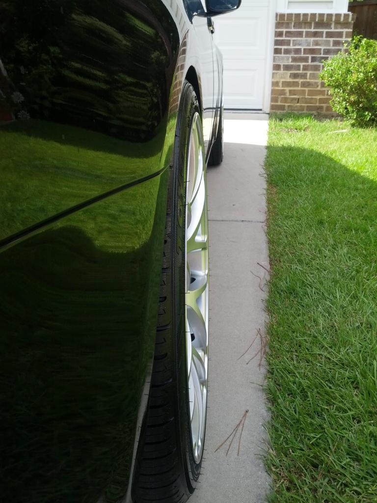

Size:  107.6 KBName:  IMG_20140730_165717_zps6d842b11.jpg

looks good, rears maybe 5mm too aggressive for my tastes

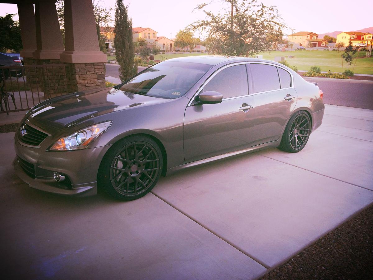

  #342
RedlineAZ's Avatar
RedlineAZ
Posts: 156
Stance SC8
20x9+32 with 245/35/20
20x10 +35 with 275/30/20
Lowered with an Eibach Pro Kit
No fender rubbing, no fender rolling.
Old Aug 10, 2014 | 12:05 PM
  #343
Nice job Redline^^^^^ looks like a great fit and nice choice in wheels & finish
