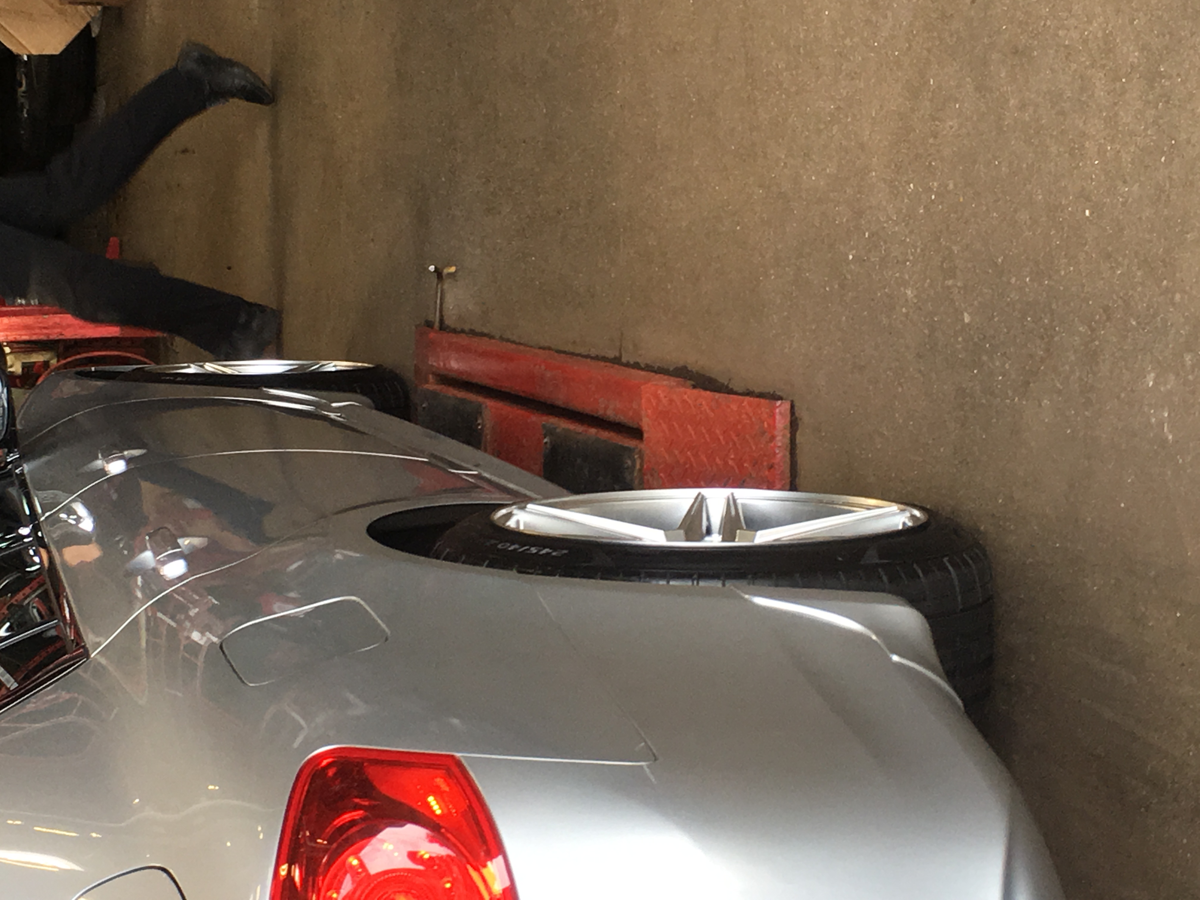

Looking for some advice on tires
Looking for some advice, read practically all the posts dont see anything with these specs.I have a square setup 19x9.5 +40 on a 2011 xs sedan. And am wondering if I can go with 275-40-19 square without a drop. Would there be any rubbing in the front, would a lower profile be better or 265's. I am running 245-40-19 right now , and they are not protecting the wheel rim at all, a little stretched. Picture below. I am not too knowledgable on this stuff. Thanks
Attached Thumbnails The OFFICIAL "I have a wheel offset / tire fitment question!" thread-img_2897.jpg
Old Jun 23, 2017 | 09:19 AM
  #1983
VenomGT9's Avatar
VenomGT9
Posts: 1,452
Likes: 228
From: Ft. Campbell / Chicago
275/35 would be a better choice if you wanted that wide but I'd try 255/40 or 265/35 first

Old Jun 23, 2017 | 04:01 PM
  #1985
I have 9.5 +38 on 245 front 285 back, I have a decent amount of room up front but not sure if 15mm more would be an issue. I know 265/35s would fit, but 275s you might have to roll that front fender edge (which isn't a big deal for a shop that does this regularly).

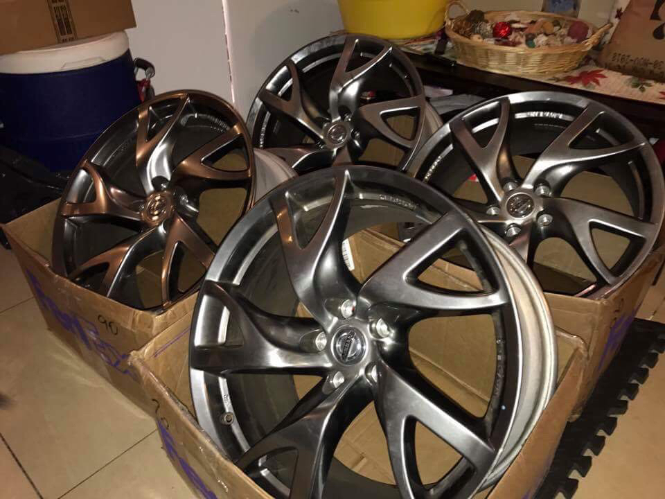

Hello,
I'm currently looking into trading my 20" Rohana RC9's for a set of 370 Nismo Forged Rays (See attached pictures).
Wheels specs are as follows:
Front are 19x9 +47 offset and rear 19x10 +30 offset 5x114.3
I have a 2012 G37S Sedan 6MT. I'm currently lowered on Tein Z Flex Coilovers, roughly at about 1.5 F, 1.0 R drop.
I'm looking to see which tire sizes would work with these wheels where I wouldn't have to pull fender/ quarters or rub. Would love to do a meaty rear setup.
Thanks in advance for the help!!
