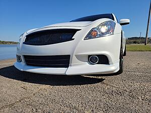

Im 18x9.5 +35 squared. Next set will be 18x9.5 +22 front 18x10.5 +35 rear. For your setup mentioned that should be good but closer to +35 on a 9.5 in the rear will be better. At one point i was not happy with the fitment and had 3mm spacers. So +32 all around and that was really close to flush at my ride height. Pic below is no spacer though, so +35 square. Fronts leave something to be desired but at +22 you'll like the fitment. Or even +25 if you can find it.

I plan on running 245/40/18 fronts and 275/35/18 rears. What tire setup are you running above? Do you suspect I will poke in the rear?
I'm leaning more towards +22 squared.

255/40/18 square. 18×9.5 +38 isn't really gonna poke unless you have zero camber. 1 to 1.5 inch drop will naturally camber the wheel and fender to the top of rim & won't be pokey on that setup
