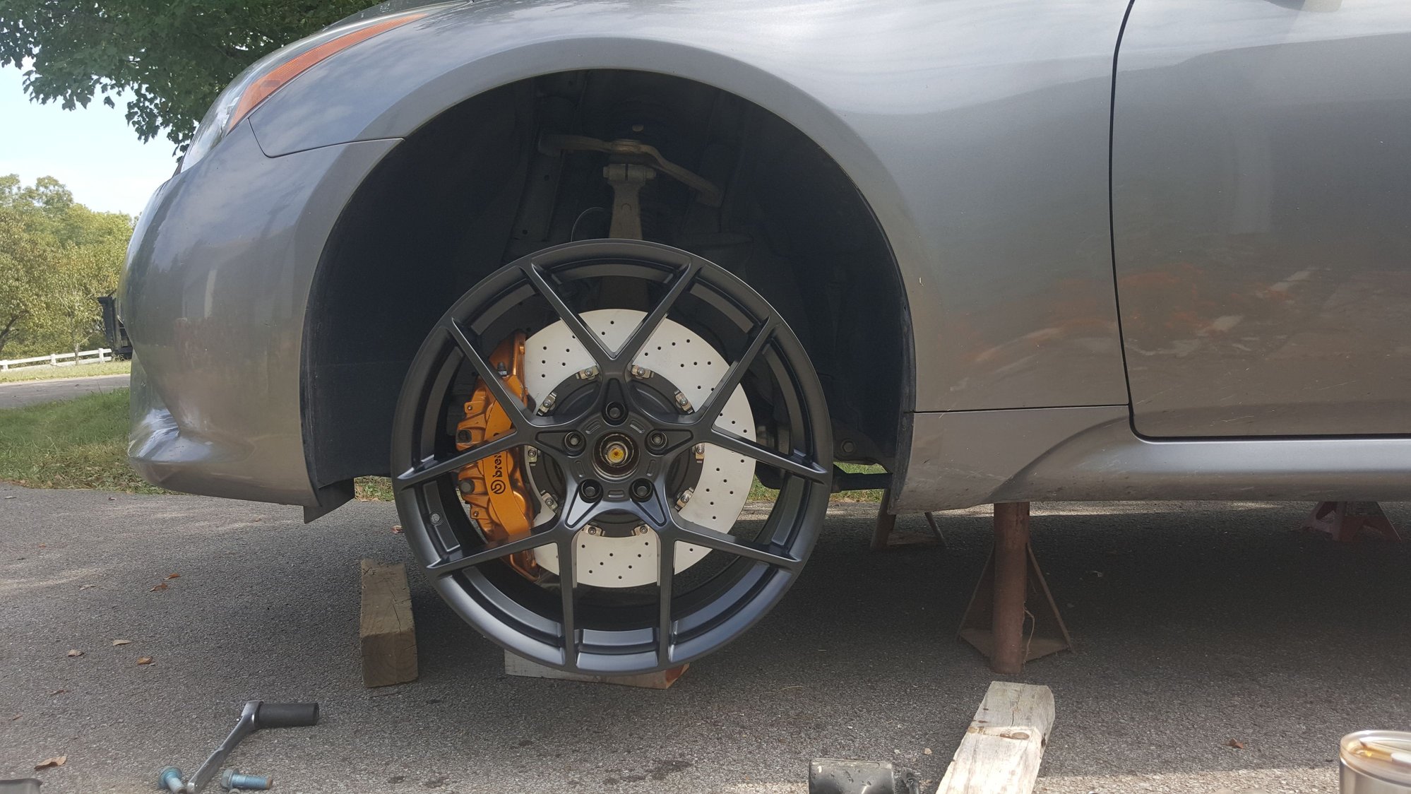

Originally Posted by EJM
I have a question. I’m looking at a set of Curva Concepts C46 20 inch 10.5 with a +38 offset. My ride is a coupe AWD. I want to run 255 wide tires all around. First, will this fit? Second, are the tires going to poke out.
I ran American Racing AR926 on my 2012 AWD Coupe. FR 255/35-20 on 9.0 +32 and RR 295/30-20 on 10.5 +45. My setup was flush. 10.5 +38 will be a 1/4" poke. Bigger concern for me would be the stretch of a 255 on the 10.5 rim. Pics of 295/30 tires on 20-10.5 +45 below.
