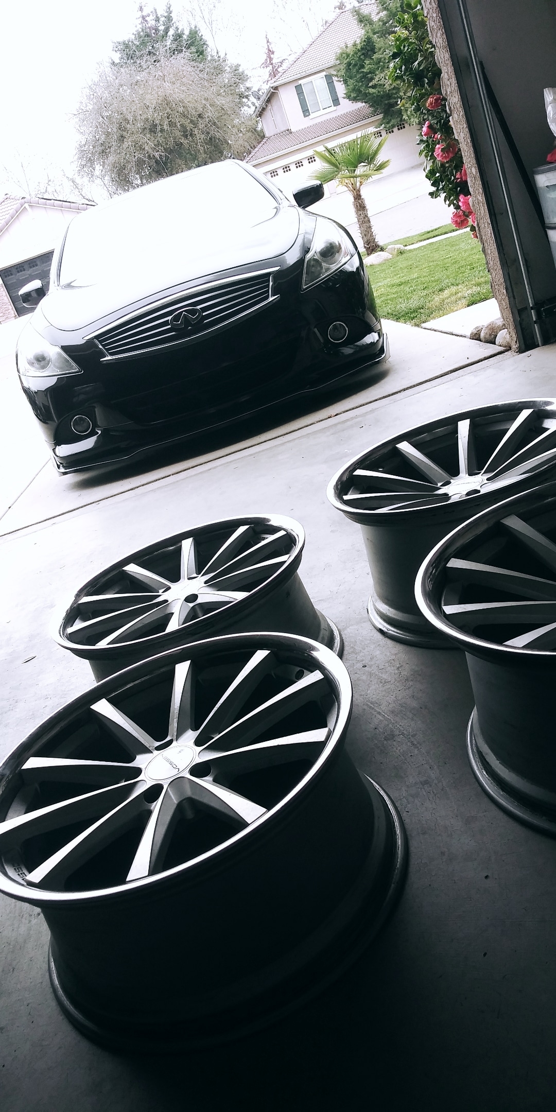

Hey guys it's been a while, 20x9 +20 20x10.5 +15..what size tires will go well with it?, Currently lowered on coils
Attached Thumbnails The OFFICIAL "I have a wheel offset / tire fitment question!" thread-img_20190405_125312_851.jpg
Old Apr 5, 2019 | 06:36 PM
  #2430
Likes: 4,952
Gonna have to stretch them out in the back I'm afraid, and maybe some camber, fronts will be ok w/ a standard mount. Something like a 245/35 front 255/35 rear
