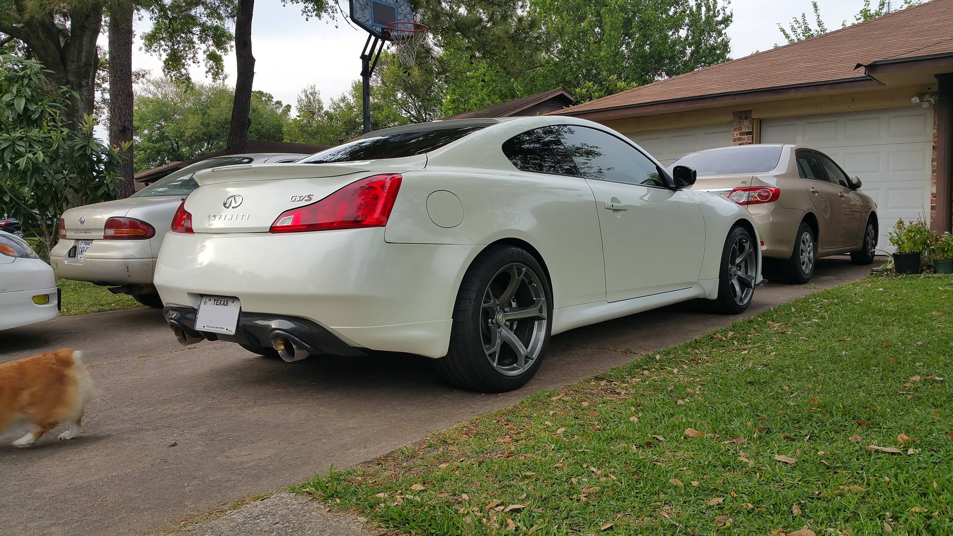

370z Nismo Wheels
Michelin Pilot Super Sports
245/40/19 front, 295/35/19 rear
These are pretty light, considering I have Advan RS-D 20x9, 20x10 with similar tire specs.
Looking to track with this set up in June at MSR Houston.
