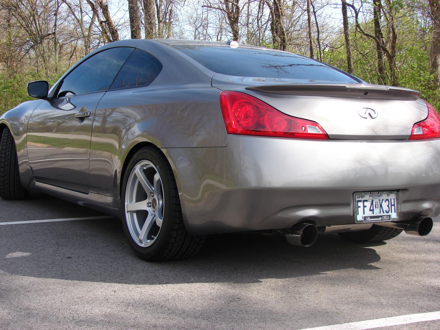

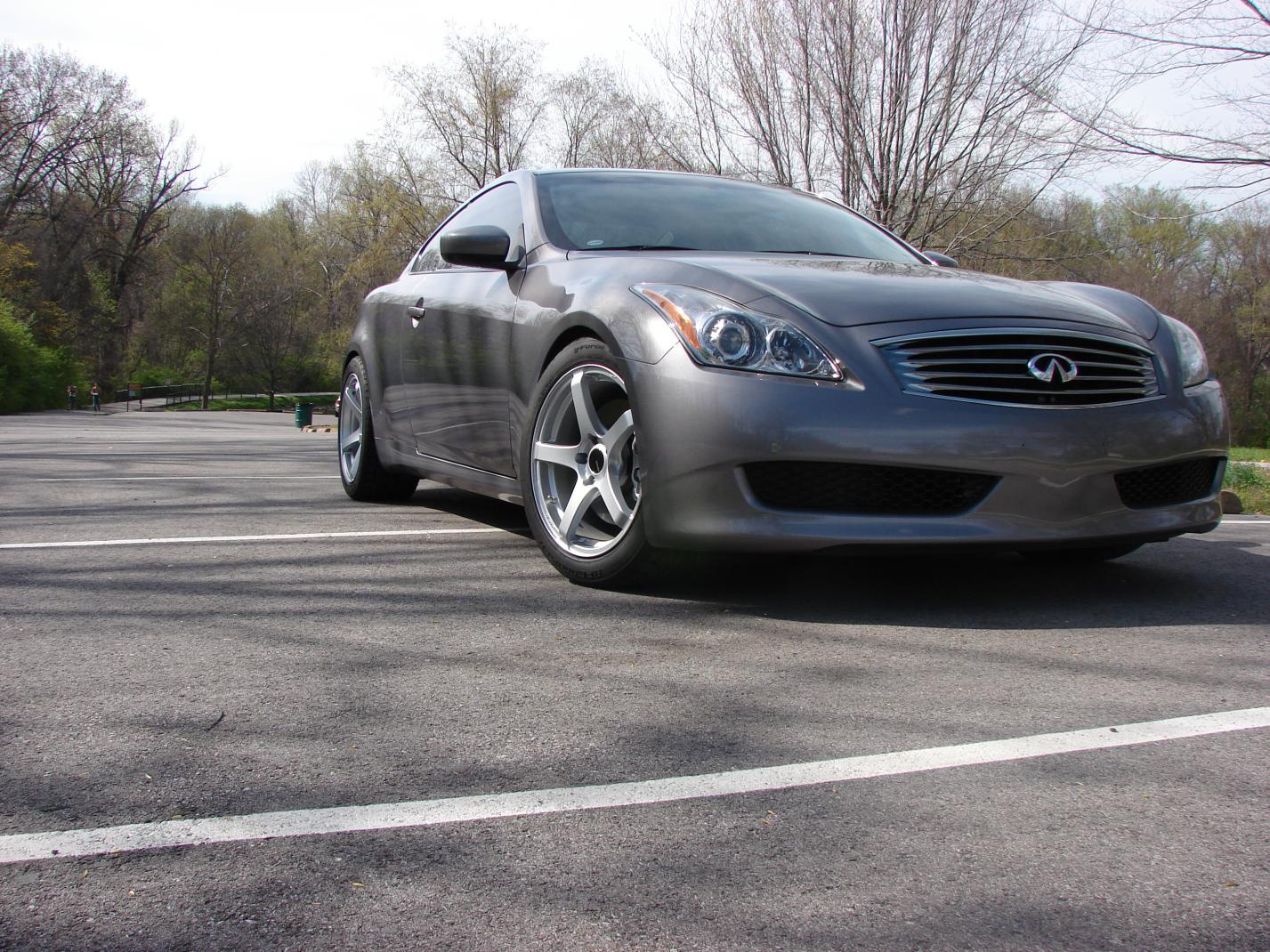

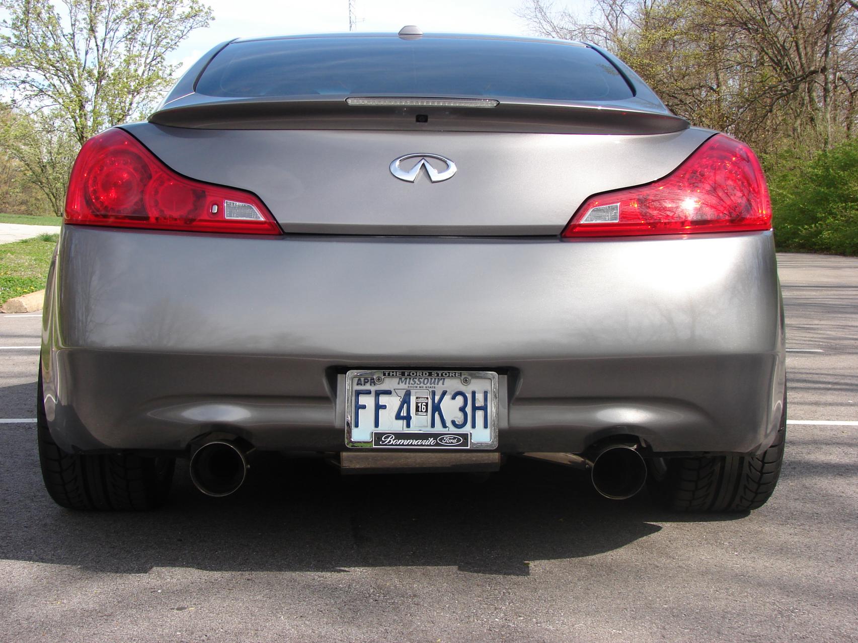

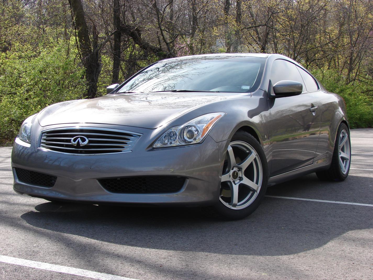

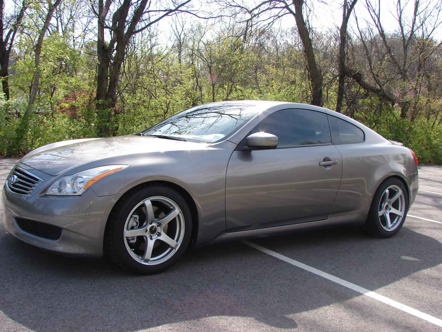

Now that the Eibachs are on, here's my entry into the aggressive offset fat tire brotherhood.LOL
Enkei Kojin
18x8.5+35 fr with 245-45 BFG comp2
18x9.5+30 rr with 275-40 BFG comp2
Attached Thumbnails Official~Best offsets for running FAT tires!-095.jpg   Official~Best offsets for running FAT tires!-096.jpg   Official~Best offsets for running FAT tires!-092.jpg   Official~Best offsets for running FAT tires!-097.jpg   Official~Best offsets for running FAT tires!-094.jpg
Enkei Kojin
Must say those 18s w/ the nice wide stagger look awesome once you dropped it, great fit and the choice of that wheel design/color go great w/ your coupe, hats-off

us
Thanks Brad, that means alot coming from the Wheel Meister. It actually has already settled some more since yesterday. I will be posting a review on the Eibachs, and my before(dead stock) and after alignment specs after I take it in this weekend for an alignment. So far I'm pretty impressed with the ride quality. Also I posted a short review on the BFGs per your request.
