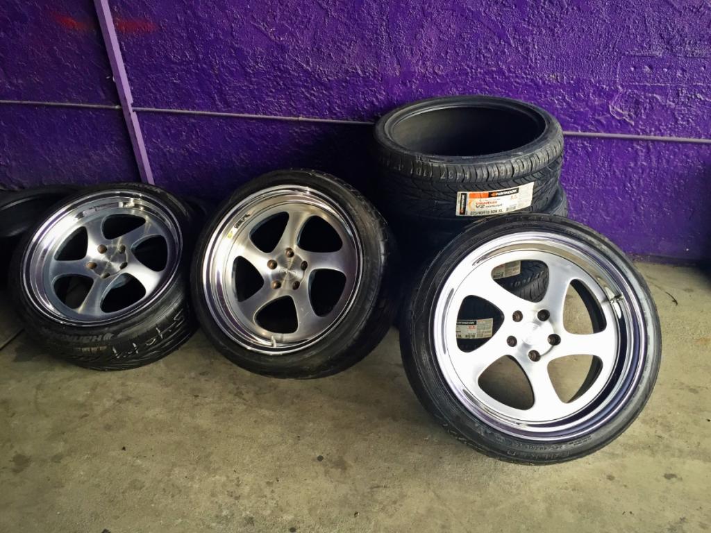

thank you for the advice @blnewt!!
picked up some temporary tires till i decide exactly which tire i want. will be going on a photoshoot tomorrow and will post pics of wheels on the car.
Wheels:
3 Piece Rotifrom TMB
Polished Lips, Brushed and cleared face, Hidden Hardware, black barrels
F: 19x10 et20
R: 19x10.5 et48
Tires:
Falken FK452 245/40/19
Hankook Ventus V12 275/35/19
Debating if I want to get Falken FK453 or Nitto Invos

Look forward to your shoot Kimchi!

Looks like a nice fit from that pic, hmmmm I thought it NEVER rains in LA??
