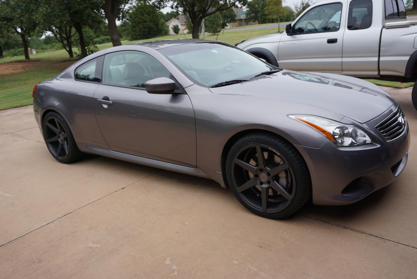

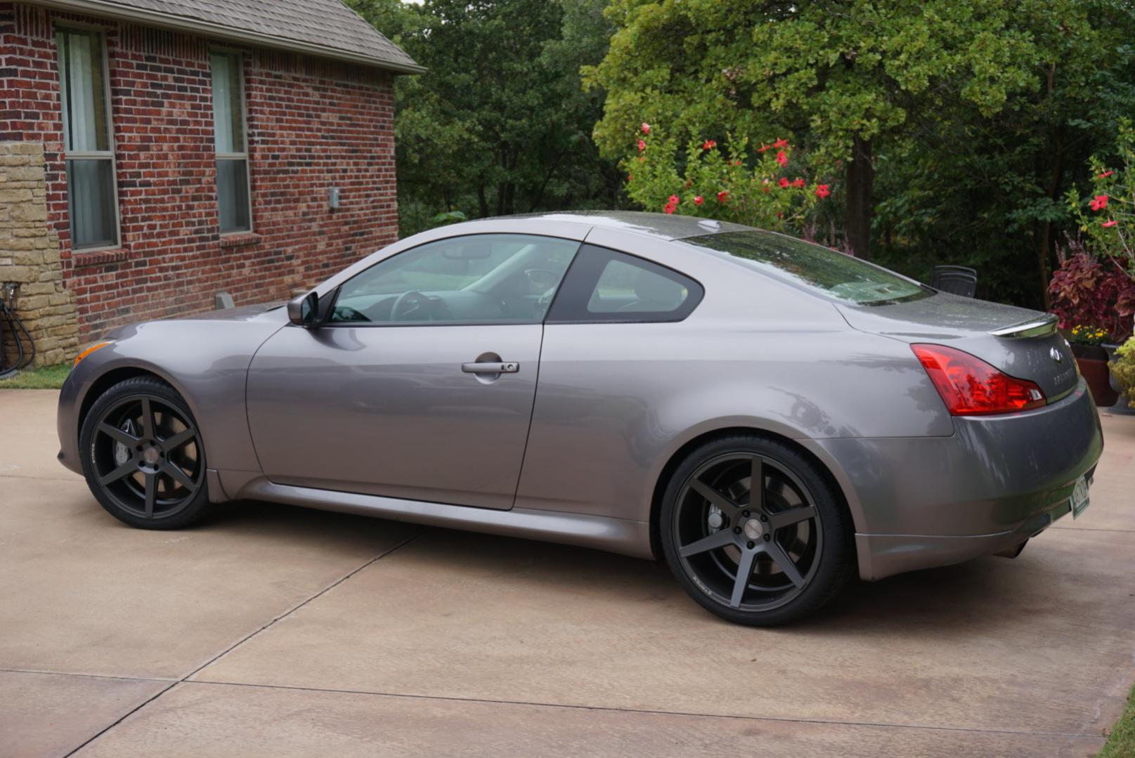

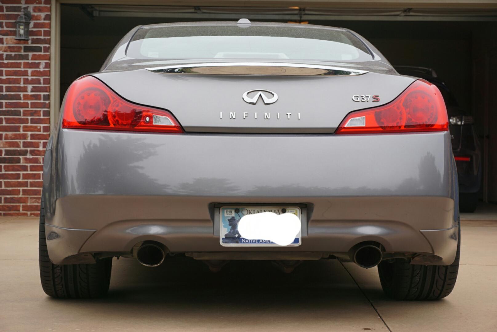

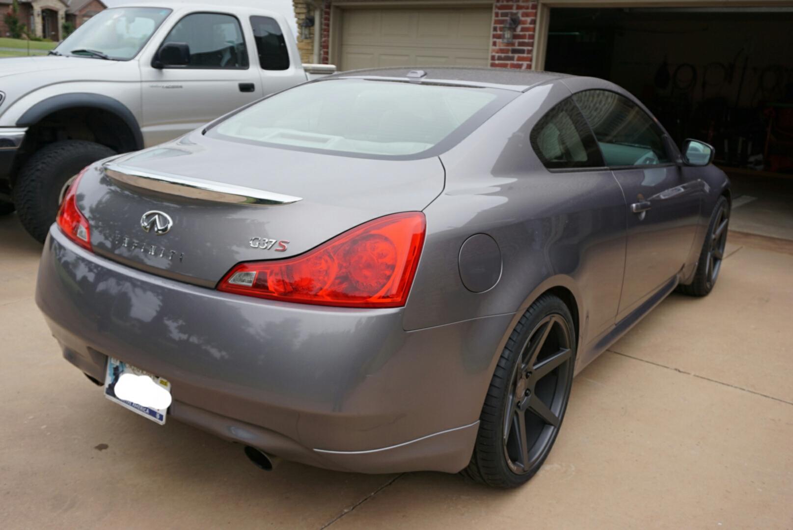

Got my new fat tires!
Originally Posted by lippstuh
Often times, rims have ~3 faces or "disks" as some wheel companies (like Work) calls them. Each face has different concavity because each has different brake clearance. Each face also has a set of different widths and offsets. You shouldn't be looking at just the width and offset, but rather the face as well. Especially if you have BBK. This mostly applies to multi-piece wheels.
For monoblocks, yes combination of width, offset, and even face are factors. But it varies from company to company. I'd ask the company for a for sure answer.
Ok, so I talked to stance. They said 10" and 10.5" have the same face, and all 9" rims have the same face. So I went 20x9"+32 front with 255 35 20 tires, and a 20x10" +35 rear with 285 30 20s got the slate finish.

pics
Domo :boobies: Domo
Attached Thumbnails Official~Best offsets for running FAT tires!-img_20140913_102124.jpg   Official~Best offsets for running FAT tires!-img_20140913_101909.jpg   Official~Best offsets for running FAT tires!-dsc04708.jpg   Official~Best offsets for running FAT tires!-dsc04713.jpg   Official~Best offsets for running FAT tires!-dsc04718.jpg
Old Sep 16, 2014 | 12:43 AM
  #863
Originally Posted by xlaziox
Domo :boobies: Domo
You stuck w/ your plan and it paid off
Looks like a nice fit, any plans to lower your G?
