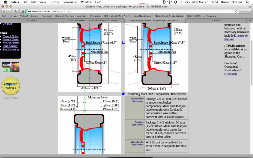

Thanks for the pictures! Believe it or not a 19x10 +45 and 19x10.5 +45 net the same results as far as the fender clearances. You have a "fatter" looking 295 than I would.
Edit: See attached picture of OEM (Top left) compared to 295/35-19x10.5 +45.
You might try using this calculator, I noticed the same glitch in the one you pasted when I was sizing mine. Try plugging those values in here~
https://www.myg37.com/forums/tire_rim_calculator.php
Here's what the difference would be according to the G37 version~
Inner Clearance:
6.35mm less
Outer Position:
extend by 6.35mm
Diameter difference:
0" (0.00%)

Originally Posted by soundmike
FWIW, a tenth or two difference here and there really isn't that big a deal. Every tire will have a different height even if spec'd the same, even the width of the mounting rim will affect the overall height and width of the tire, not to mention tire pressures.
You get over a quarter inch difference in height just by the nature of the tire wearing down.
Good points^
Just surprised the Rimsntires.com calculator program hasn't addressed that rather glaring flaw. 6mm could be significant when you're cutting it close at the fenders

Old Mar 25, 2013 | 11:27 PM
  #262
Likes: 4,952
So ya'll think I should stick with the 255/40 & 285/35?
I'd hate to suggest 295s and then you have clearance issues. That said, the actual clearance at the top of the tire will be the same w/ your 10.5" rim but the rim/sidewall area will be 6mm out from where my rims are. Not sure how much effect that would have since you'll be higher up w/ your swifts, but with some crazy severe impact it may contact that fender lip
I dunno, pretty close call IMO.
