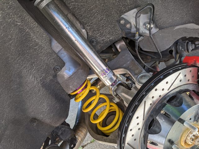

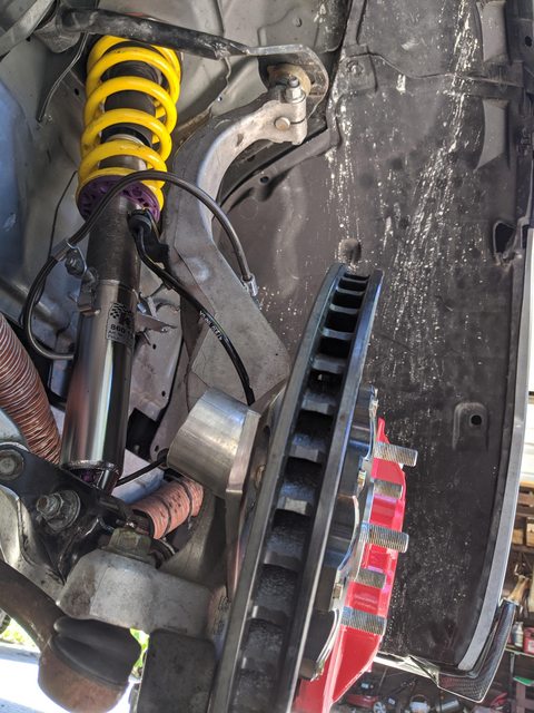

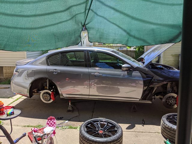

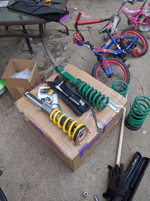

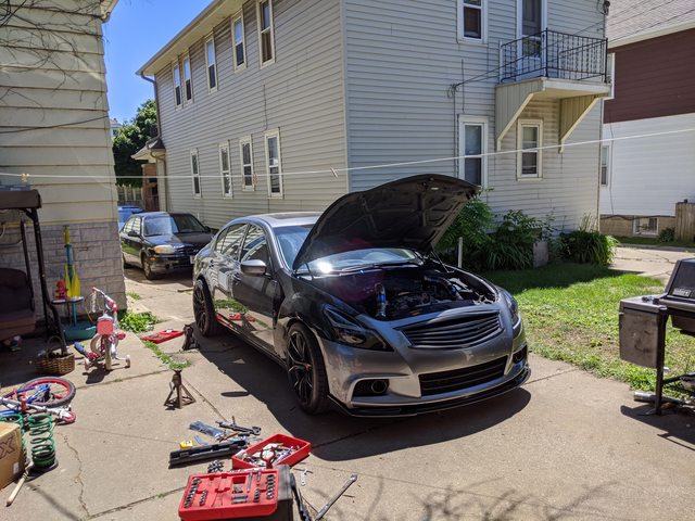

Started swapping my Tein Street Basis for my KW's today. Only got half way done so it will have to be resumed tomorrow.

Alright finished the KW's today.
Nice updates, Supra! Are those brake cooling ducts that I spy attached to your front spindle/brakes, or is that just an optical illusion in the photo?

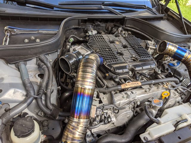

3" Intakes + Dyno Tune. Review thread soon
Those are brake ducts .
I'll have to write a long term review of these KW V3's vs Tien Street Basis vs Stance XR1 since I have more experience than most soon. My initial install and height settings for the KW is a bit disappointing. Rear as at full high and it's pretty low.
