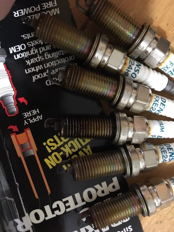

Spark plug change and throttle body clean. Odometer at ~117,300 miles.
Top tip: Don't over torque your engine cover.

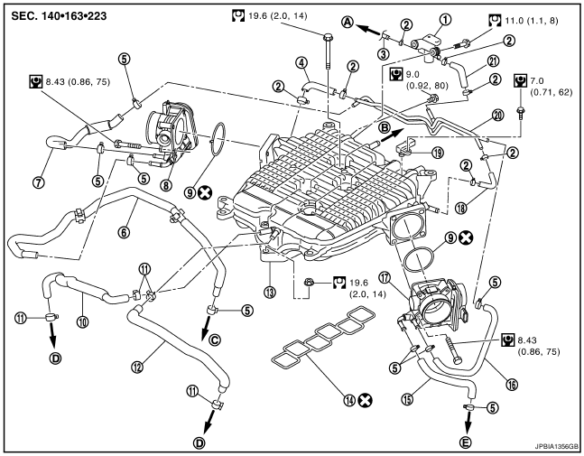

Lots of youtube videos on this topic by guys more knowledgeable than me. Here's my own 2 cents for whatever it may be worth:
To clean the throttle body, I used mainly the 91% rubbing alcohol I had on hand since my harsher carb cleaner didn't seem to be more effective. The cheapo toothbrush route didn't seem to work that great for me on the butteryfly as the butterfly face's gunk was rather stubborn, but a bit of scotch-brite&foam pad action in addition to shop blue paper towel did the trick. I used a folded up paper bag piece to hold open the butterfly while I cleaned the other side. I also reached into the plenum to wipe that out as well.
I do like removing the throttle bodies from the upper intake manifold / plenum since that greatly aids access during cleaning. And wiping the accessible inside area of the plenum felt nice (even though not particularly needful to my knowledge since our engines are port injected). Just be sure to torque to spec when reinstalling (75 in-lbs., see pic below. Full Factory Service Manual (FSM) located here). And don't disconnect the coolant lines (#15, #16 in the below pic). If you don't have the metric hex bit, a set of 6 or so 3/8 socket metric hex bits is less than $8 at Harbor Freight. And their in-lbs torque wrench is ~$12 with coupon right now.* Be sure to have a 3/8 socket to 1/4 socket adapter too if you go this route. You may need a short socket extension as well e.g. a u-joint should be long enough for this job.
See the youtube videos:
After cleaning the throttle body: G37 & 370Z After Throttle Body Cleaning: Motorvate’s DIY Garage Ep.27.
Motorvate's DIY Garage Quick Tip #1: Engine Cover Warning
And torque the cover bolts to spec -- iirc it's 49 in-lbs which is hardly anything.
Tip: After cleaning the throttle body, there will be a gap between the edge of the butterfly and the throttle body. I recommend pressing on the butteryfly to close that gap. It will pop back to being slightly cracked open, but doing so will help break any crud you couldn't get to near the hinge, so when the computer does the "Throttle valve close position learning", there won't be any chance of the residual crud significantly hindering the servo. (I'm not sure if this is really needful. I don't know how powerful or anemic the servo is for the buttery valve.)
I don't have MAF cleaner on hand, and they quite readily removable, so I decided to clean those at some nebulous future date.
* After buying the in-lbs torque wrench, set it to some random value e.g. 100 in-lbs and then test it e.g. on a lug nut to ensure it clicks as it should. The last thing you want is to find out the hard way when tightening a low torque value bolt is that your new torque wrench isn't clicking over.
Hope this helps. This is perhaps quite excessively elaborative, but I wasn't sure just how much elaboration you needed.

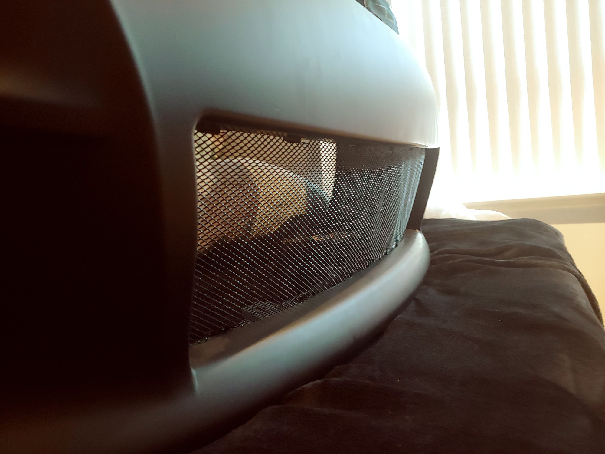

First baby steps for the bumper. Still need to massage the mesh a bit to get rid of the shipping waviness. Once it's installed permanently after paint, it will press up better against the brackets where it mounts. Already made up little clips to make it happen.
