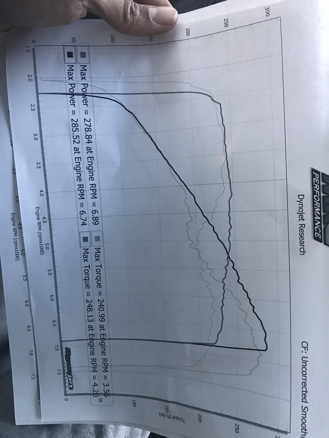

I finally had my dyno tune today. However, they told me I may need a diagnosis for my knock sensor... has anybody ever had an issue with their own? I’m at 72k miles with Stillen Gen 3 intakes and the Ark CBE.

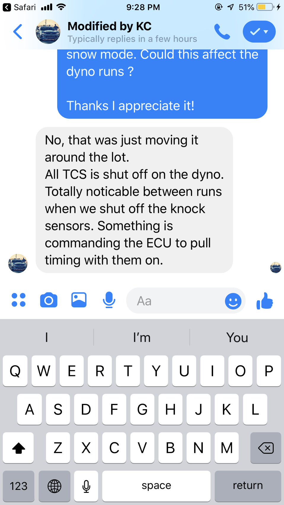

My car was in snow mode when they gave it back. Could that make a difference?
no idea. Ive heard it limits throttle response though.

Not gonna lie. You made good power everywhere but peak power gain was a lot less than i was expecting. Also he didn't go to 7500rpm. Maybe it would have made more. Also the correction is usually set to SAE and correction 5. It says uncorrected on your printout.
Maybe the stock cats are that restrictive. Have you thought about high-flows?
Yeah it was a lot less than I was expecting too.. yeah I definitely feel like it would've made more at 7500 rpm.
Berk HFCs are actually next on my list.
