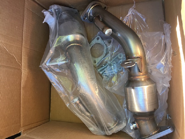

.. Well Tomorow Install Z1 HFC's they changed the style, and a Stillen Sway bar.
I'm also having Seb update my tune for HFC's and I wlll be working on a burble" Pop" map for us also
Attached Thumbnails What did you do to your Sedan today?-z1-hfc-s-new-style.jpg
"burble pop" That made me smile.
I was watching a Genny Coupe in traffic the other day that snarled and popped like crazy. Took me a moment to realize that yes, it was in fact that little Hyundai making all that noise. Seemed like all kinds of fun... until it drives you nuts because it's all the time.
Hope to read about your results on this somewhere.
