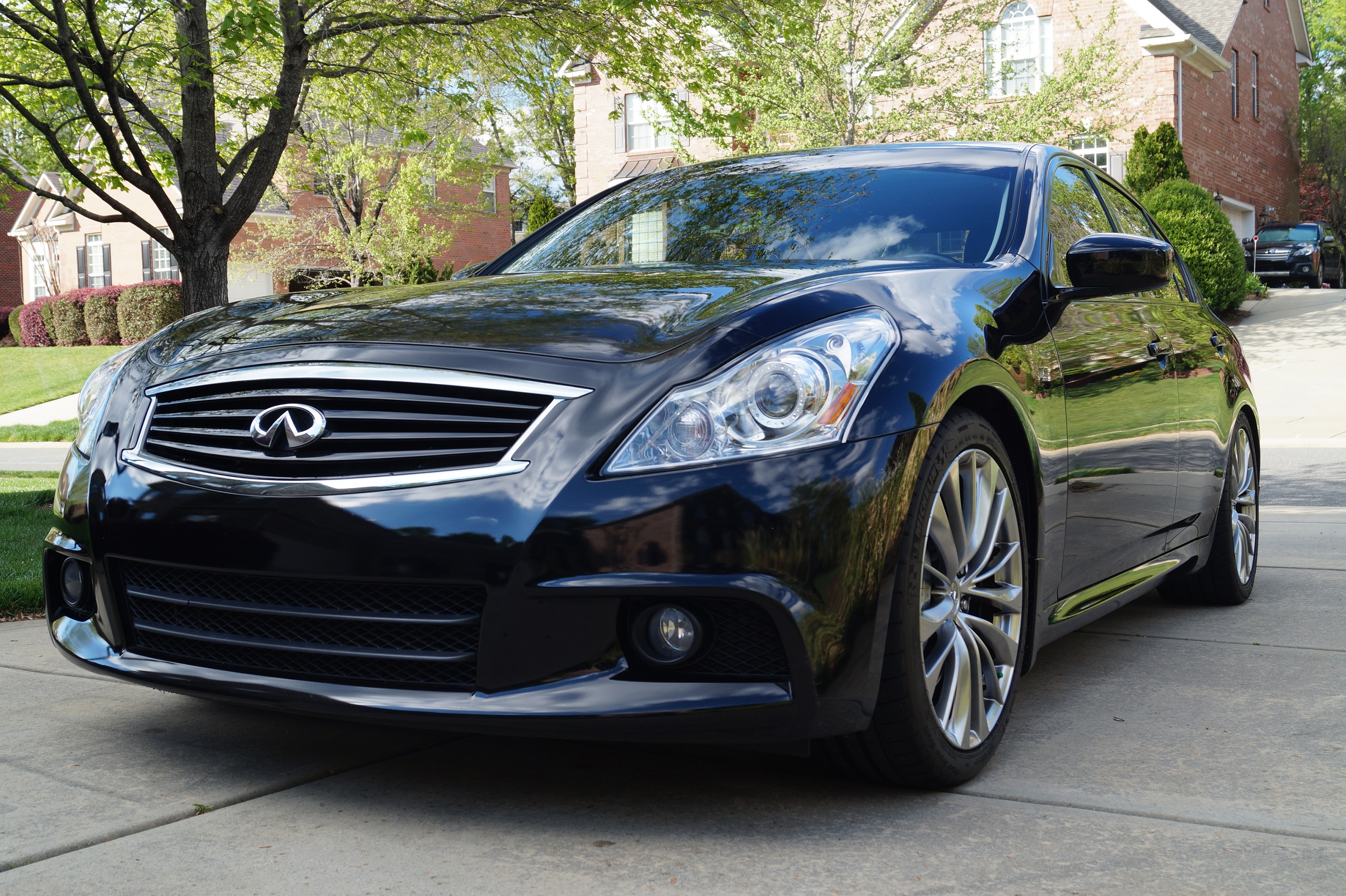

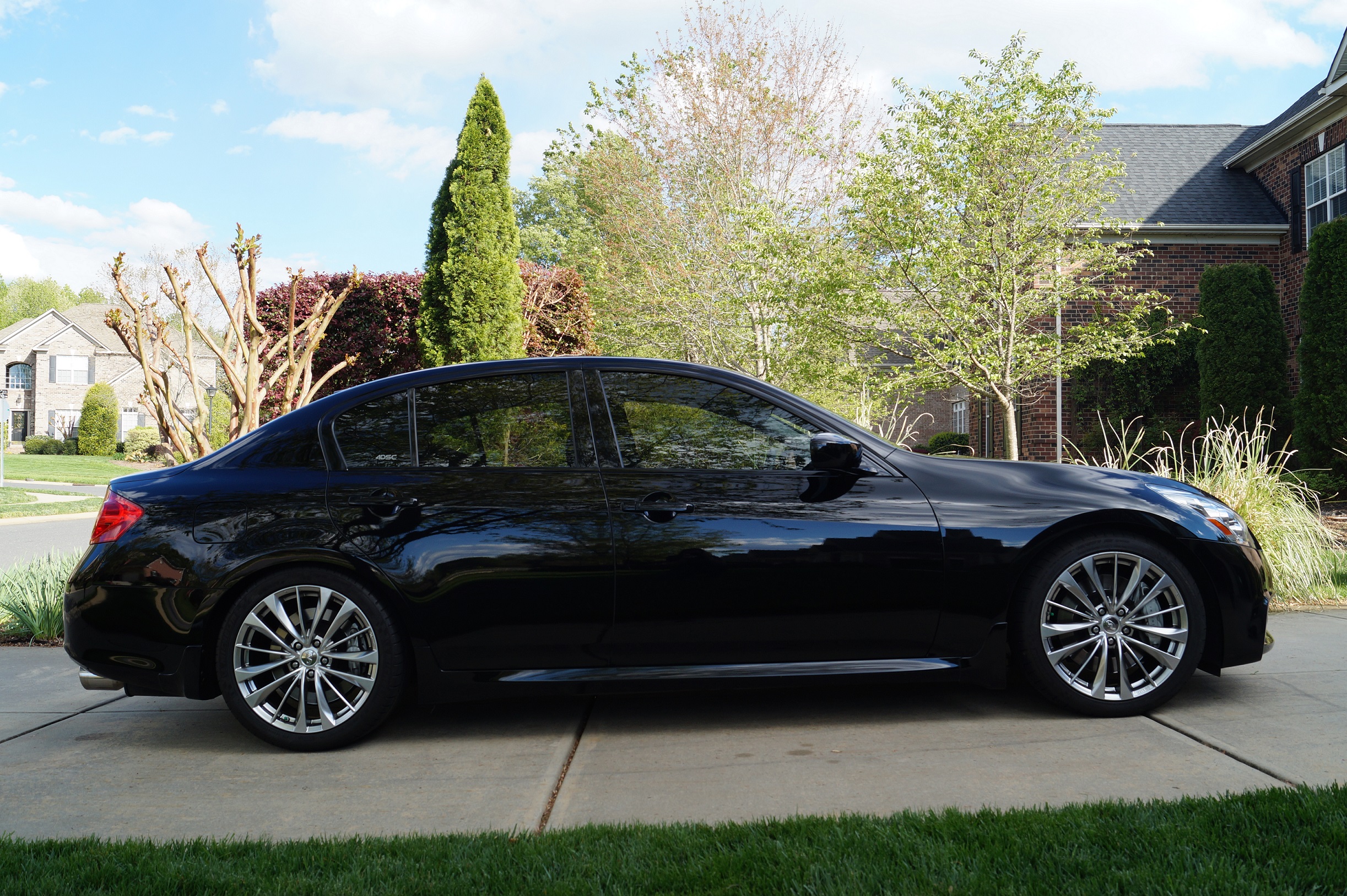

I would jump on those, assuming they really were flawless.
Edit: The later generation coupe wheels on my black sedan
Attached Thumbnails Sedan Chat Thread-dsc09452.jpg   Sedan Chat Thread-dsc09457.jpg

Thanks for the pictures, looks good! I was thinking about blacking out some of the chrome too so that's extra helpful.
