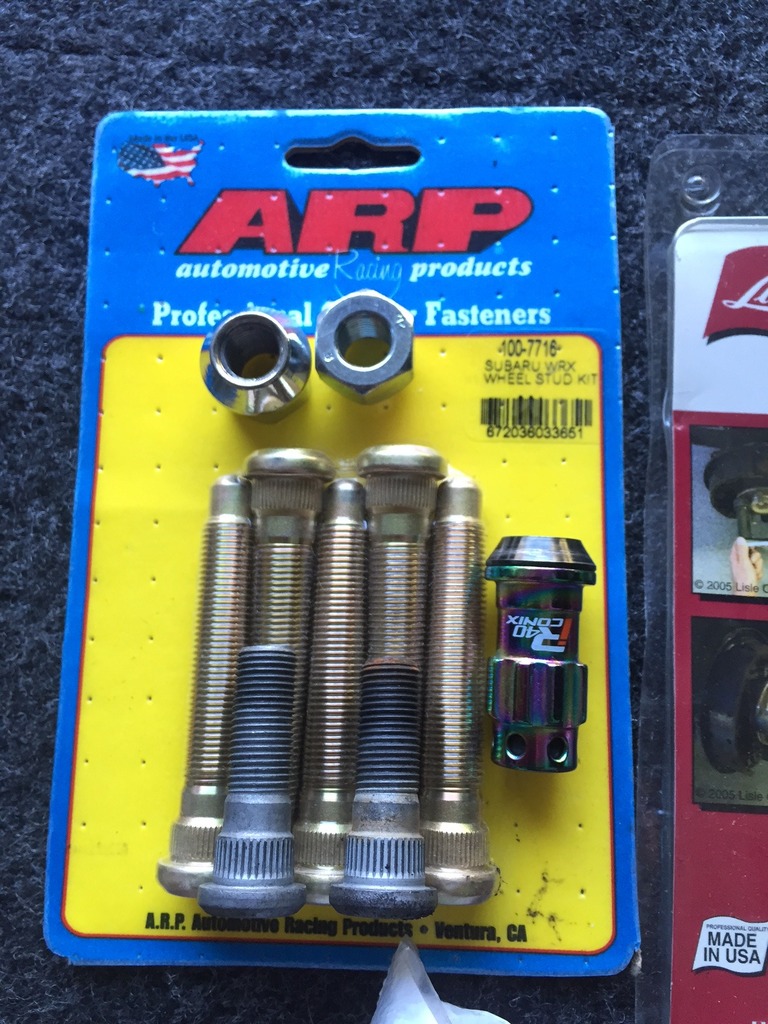

Any of you guys been running 5mm spacers on the rear with stock studs for a while without any issues?

Sorry, forgot to add that I was talking about running 5mm on stock studs in the rear.
That's right in that gray area, if you can get a full 6 turns on your lug nuts torqued to 80 ft. lbs you're good, any less than that you should get extended studs. It's going to be close.
I have to agree with Brad on this. The OEM rear wheel studs are about 4-5 mm shorter than the front studs (see below pic for reference), so you have less leeway on the rear than the front. I had to install longer wheel studs to run 10 spacers in the rear of my car. Although it also depends on the thickness of the hub on your particular wheels.. My Volks have a pretty thick mounting hub so that actually takes up some more of the useable stud length.
The rule of thumb we used to use in the tire/wheel shop I used to Manage is you really want the lug-nut to catch at least 3/8" of threads on the stud. So for 1.5mm thread pitch studs 6 turns is about right (6x1.5=9mm/25.4=.354"), however for our 1.25 thread pitch studs you should shoot for 8 full turns or more (8x1.25=10mm/25.4=.393"). Of course if you really want to get deep into the subject you would need to look at the actually amount of thread-to-thread contact surface area where a 1.25 pitch thread would have more actual thread contact area per mm or per inch than a 1.5 pitch thread.
OEM Front stud on the left and OEM rear stud on the right... Note the difference in length. Incidentally, you can also see the darker area on the threads of the OEM studs where the OEM lug-nuts were contacting the OEM studs. If you count these it seems to be about 8 full threads were in contact for the front studs and 8 - 9 threads for the rear studs.

I've read that you want half the nut thickness of bolt protruding past the top of the nut. I wouldn't feel safe with the bolt not protruding at all.
